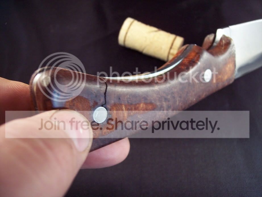

I have a lot of Desert Ironwood logs, when cut to scales I find hair line cracks in most. Will stabilizing help these flaws. It's killing me to junk these.
