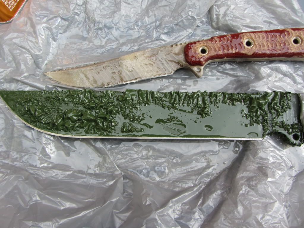

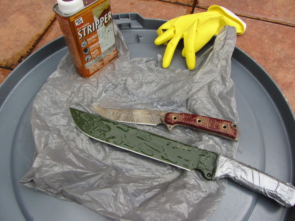

Anyway....strippers...I use EZStrip, it's a gel. Real nasty stuff so use gloves. It won't affect micarta, besides, leave that stripper on for 5 minutes the coating usually melts off.
Rust resistance...I've had 0 problems from my NMSFNO with rust, and the only issues with the FFBM is the INFI dimples which really isn't a big deal. So IMO, strippers have better rust resistance than competition finishes.

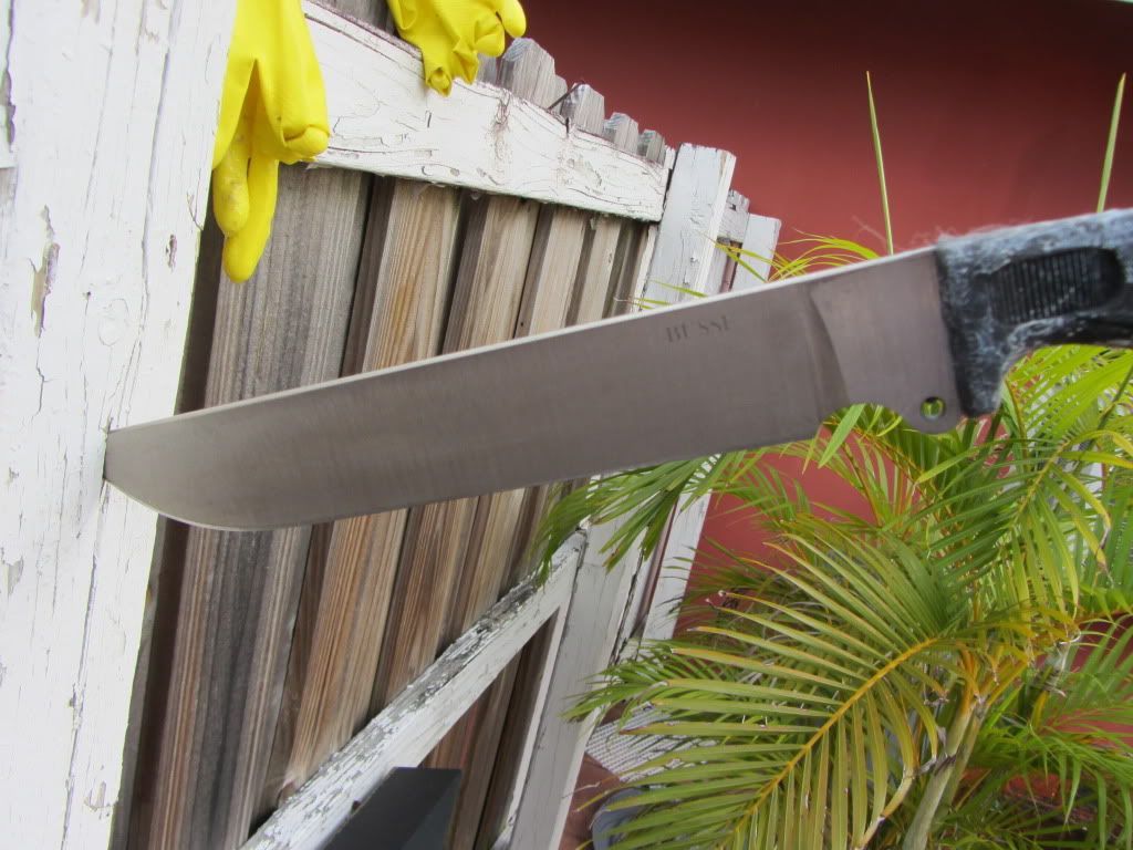

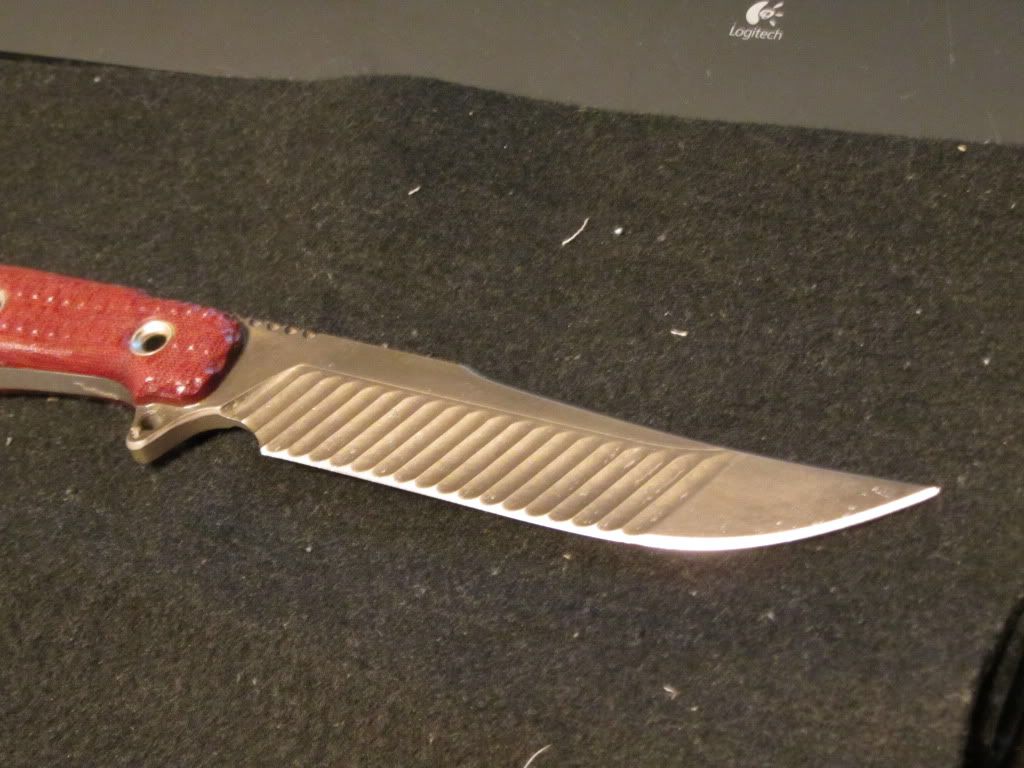

Not if you scotchbrite the decarb layer off enough to make it a non-issue. ;) Possibly even less susceptible from my experience.
These are all blades I have stripped, except for the sjtac and cgfbm which were done by the shop.
And this is what I stripped them with...

P.S. You don't have to cover the res-c as stripper will not hurt it.

They look fine stripped and oiled though.
