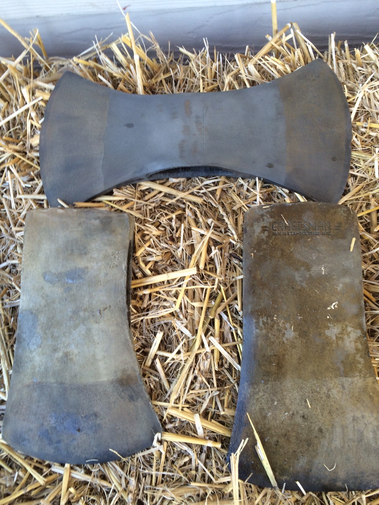

As a newbie to axe restoration, I have been told to vineger soak the rusty, crusty heads.
I have done this with very good results.
It makes the heads look new, removing the rust to bare metal and revealing the heat treatment lines, (or lack there of), left on the heads.
But I have noticed more than once now, that a few guys here advocate not using vineger, instead to use a wire wheel, saying it leaves a nice patina.
Other than the way it looks when finished, is there any other reason NOT to use the vineger method?
To me, with my limited knowledge, it seems a lot less work, less mess, and if you don't leave it in too long so it doesn't pit the metal, leaves the head like new.
This would then allow you to paint or even blue the head with better results.
So, please guys share your knowledge and opinions for us newbies just getting into this fascinating hobby.
Any acid will attack the healthy steel as well. As long as you don't overdo it and use a base to neutralize the acid before oiling (baking soda solution), you'll be a happy fellow.
Otherwise, it's preference. I'd probably not be too happy with how the metal looks after a vinegar soak and I'd use a wirewheel anyway :). Another reason to ditch the vinegar and electrolisys except in more severe cases, and go straight to the wirewheel. (With protection for all the anatomical parts you hold dear :)! )
Sometimes, the hardening line can be seen even after wirewheeling. Otherwise, I'd see why one would be interested to check how deep the hardened steel runs and use an acid.
In the end: nothing wrong with it. Do as you wish.
Some heads clean up pretty nice in vinegar and then I hit them with a soft wire cup brush on an angle grinder and they turn back to a nice blue black color. But not all of them.
I would never soak a Sager Chemical axe in vinegar. It will come out looking just like your Sager and True Temper that where soaked in vinegar but not turn back. If you don't mind no that look there is nothing wrong with it. Blueing might help, I have not tried it. I just stay away from vinegar with forge welded axes.

I've soaked heads in vinegar but the ones I have done seem to kind of have a grey cast to them when done. That isn't everyone's experience I am gathering or maybe I didn't do it right/too long/not long enough. I certainly don't like the smell or lasting taste in my mouth that comes from messing around with the heads when they first come out. To me it has the same effect as chewing tinfoil, more or less. Never heard anyone mention that so that last part just might be something wrong with me.

When the axe bug bit me, I soaked everything in vinegar. I actually find the contrast of the heat treat appealing. I don't use vinegar as much now but I still use it for extreme cases and if I suspect the poll may be hardened. The gentlemen above have given the best advice, "The axes are yours, do what makes you happy."

It's just a personal decision. Most of the time we are talking about a $20 axe head or less. I've done a few badly pitted heads in vinegar. It's easy but you lose the history. It looks artificial because when the axe was new the differential didn't show. A wire wheel preserves the patina. It looks better to me so that's what I do. As an axe buyer I'm not interested in buying any vinegar soaked heads.

I like to clean my old axes with a brass wire cup brush on an angle grinder. I've been promoting this method for many years and quite a few folks have adopted it and prefer it. For very rusty tools I'll step up to a knotted steel wheel. I never use crimped steel wheels or cups because they have a tendency to throw wires. Any wire wheel or cup will throw wires if you bear down hard with it - so don't do that. Take your time and let the wire cup do it's job.

Yes. Some will also come out darker if you keep your vinegar dirty. I keep mine in a bucket with a lid on it. When it gets to dirty I pore it off into another bucket to empty the sludge.
Here is the general type of look I got most of the time:
This is more a testament that I can mess anything up -
