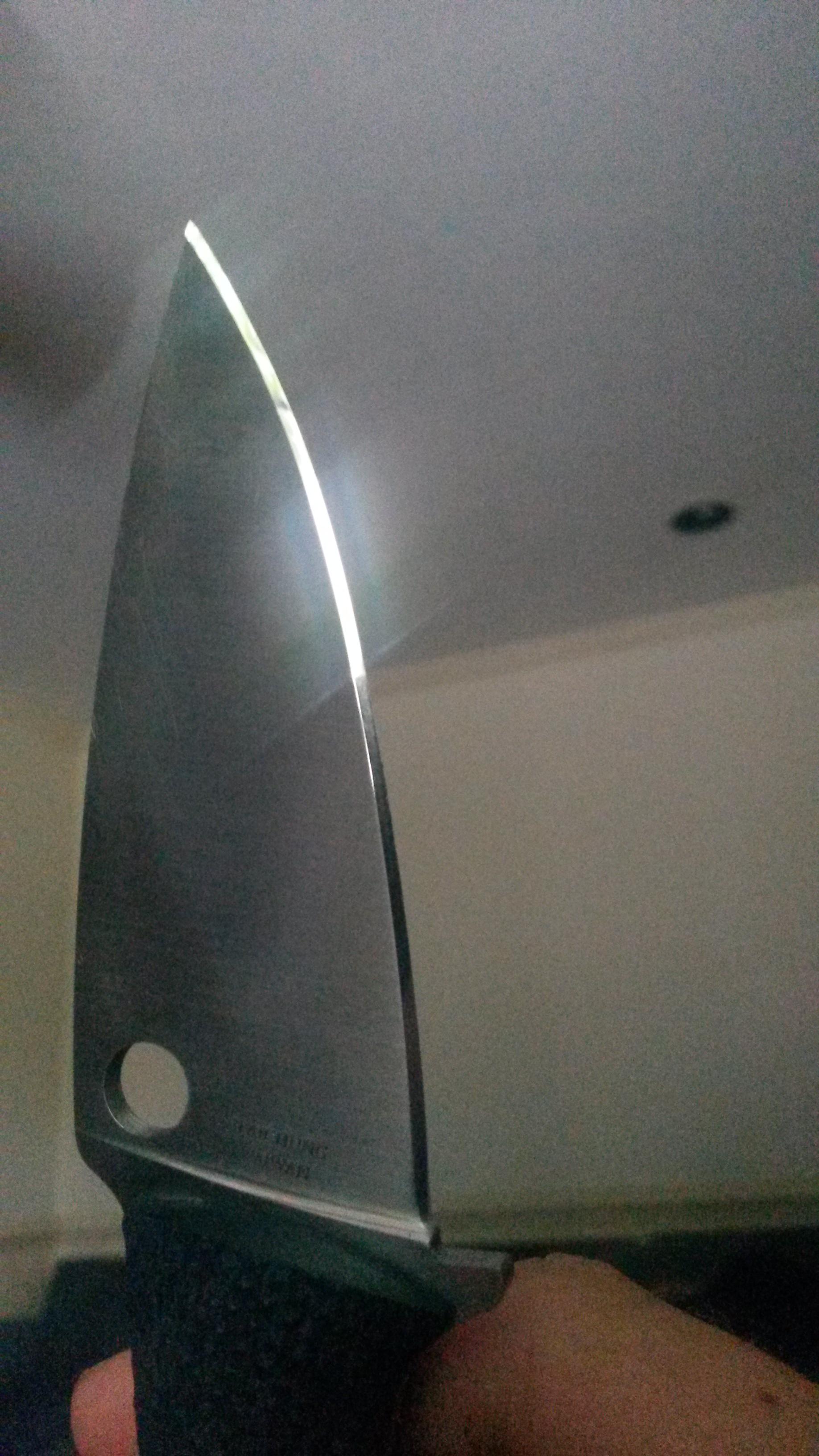

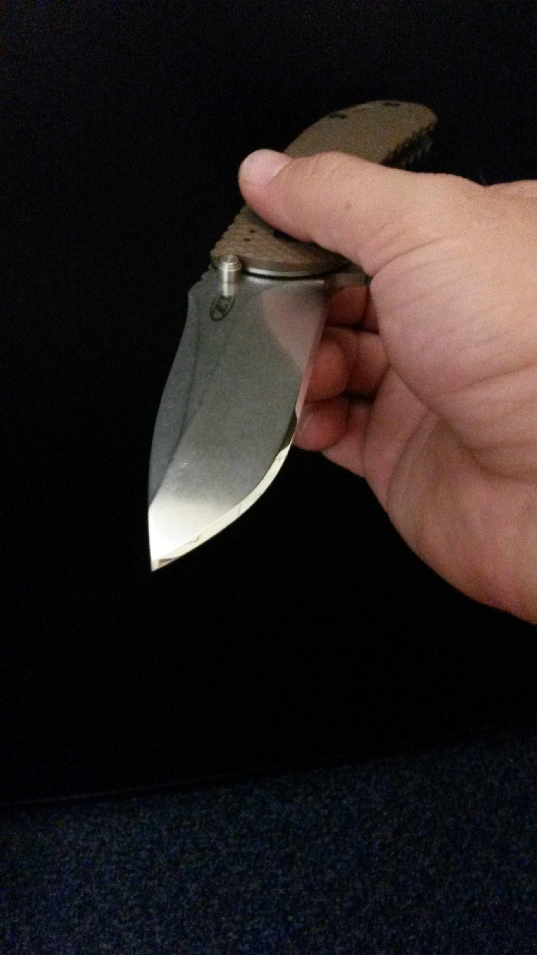

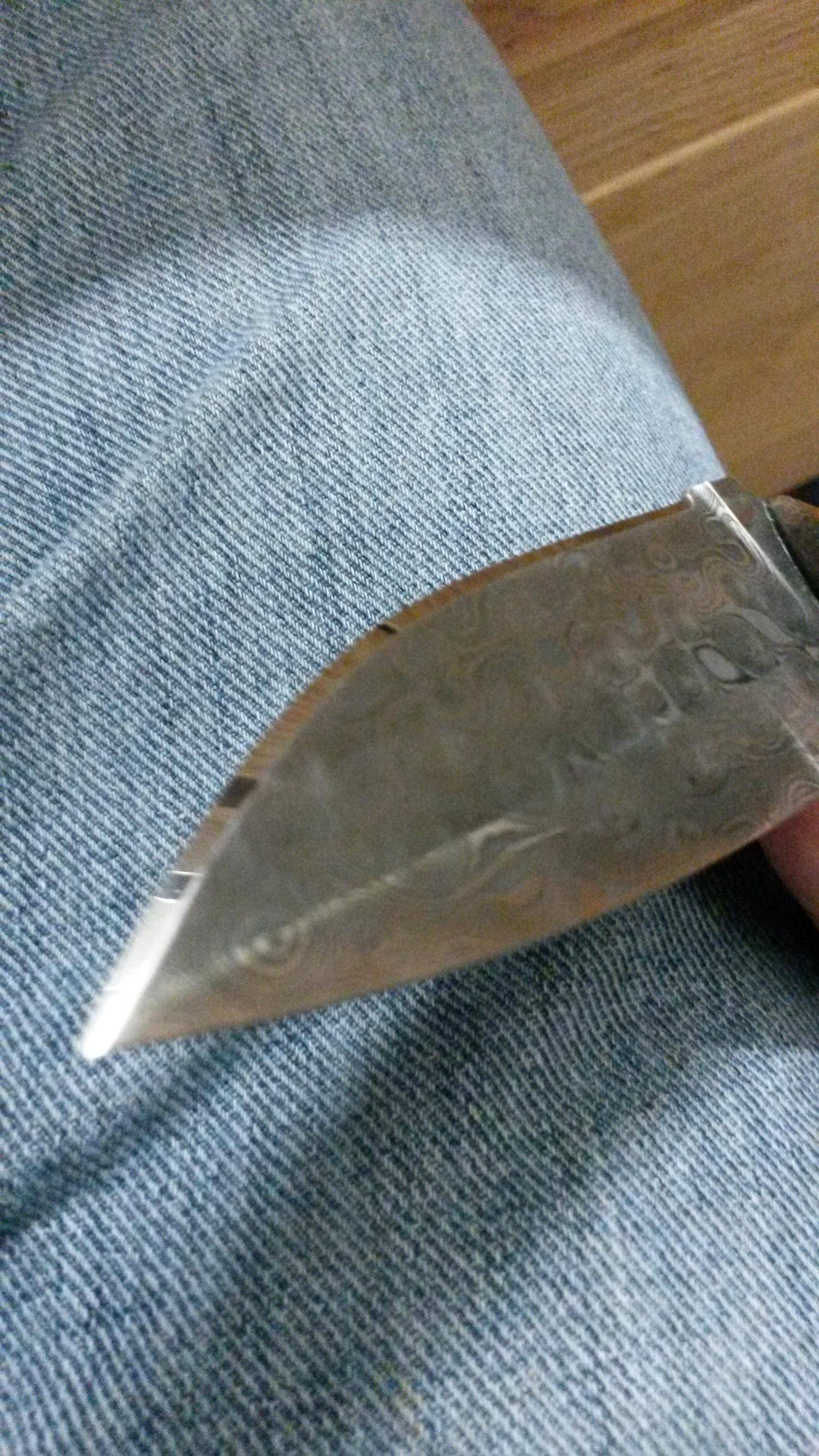

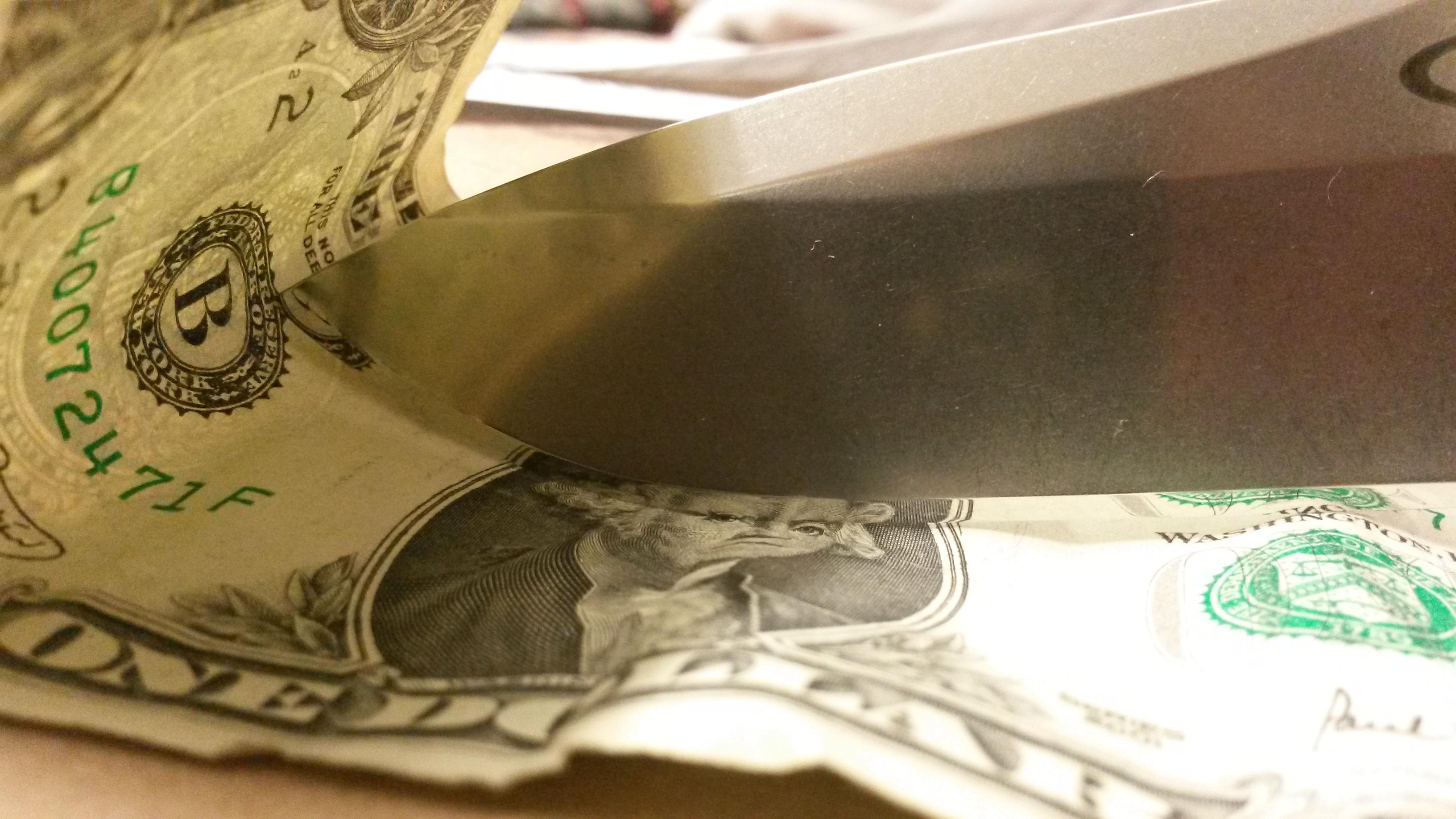

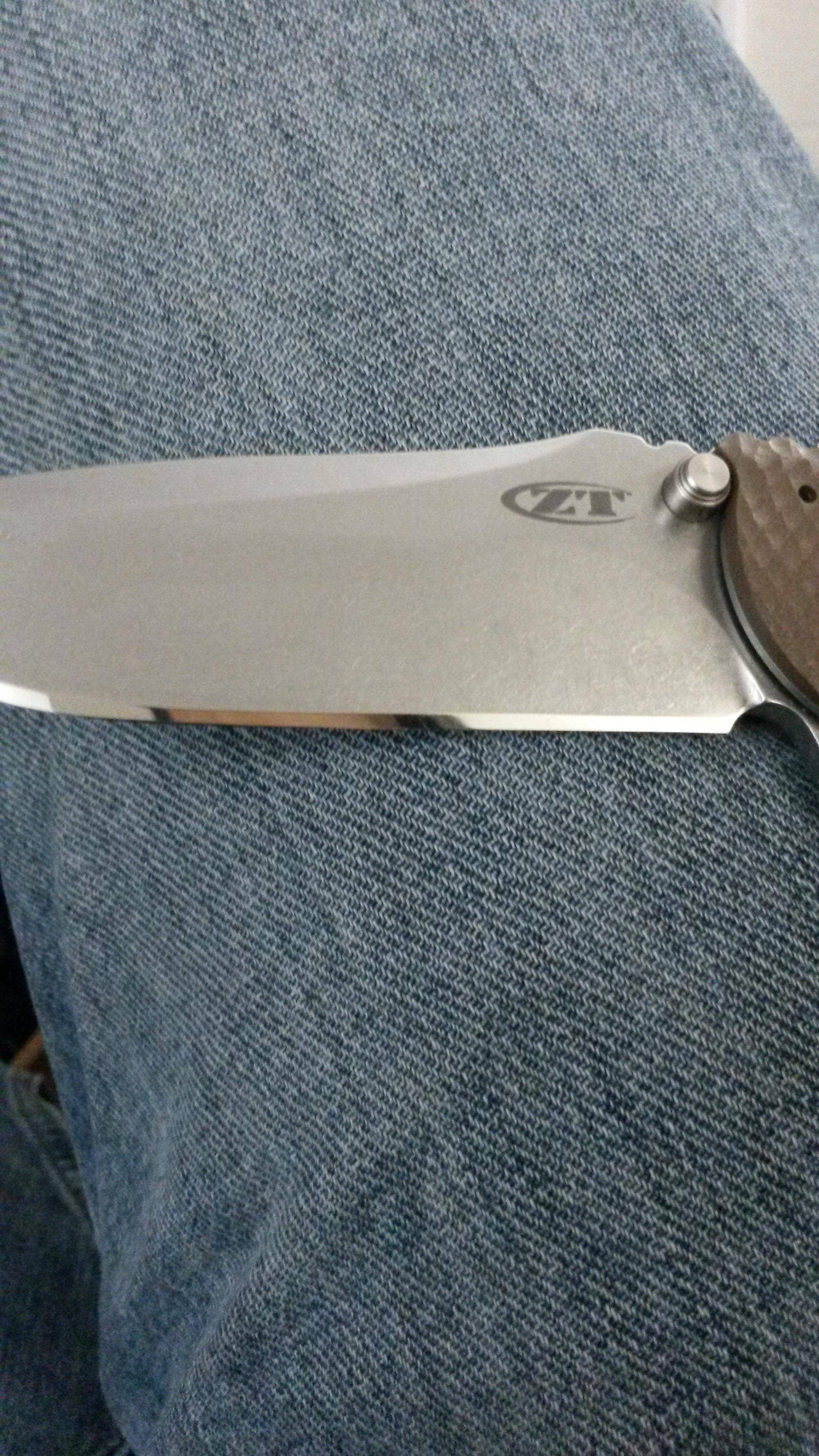

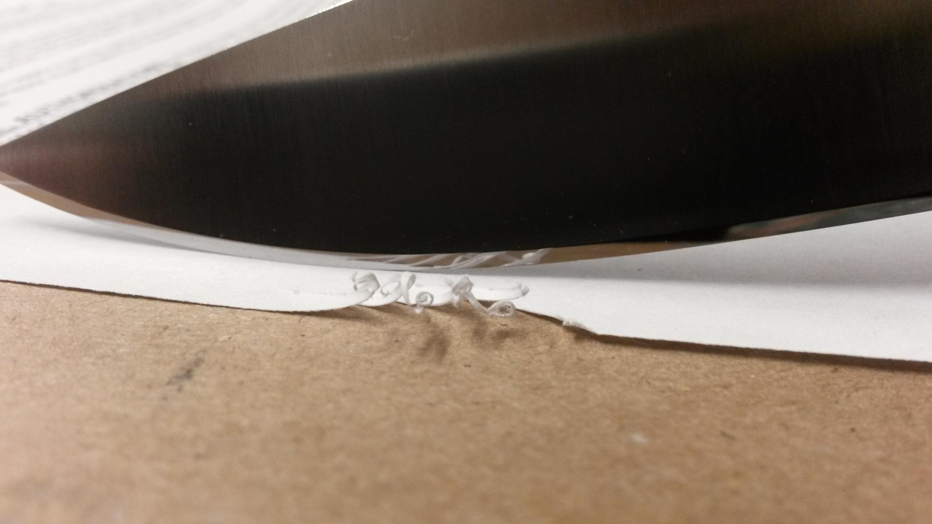

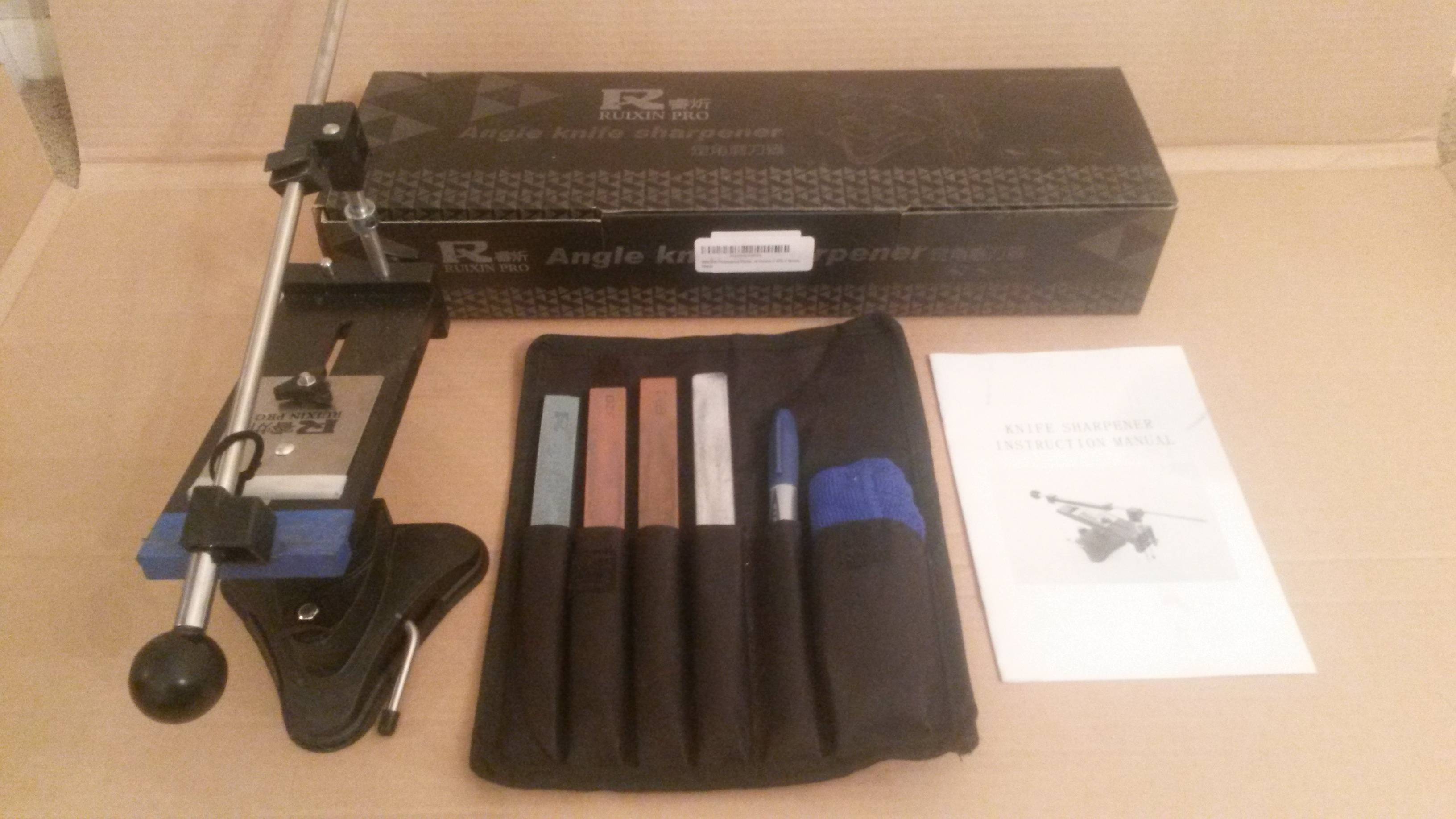

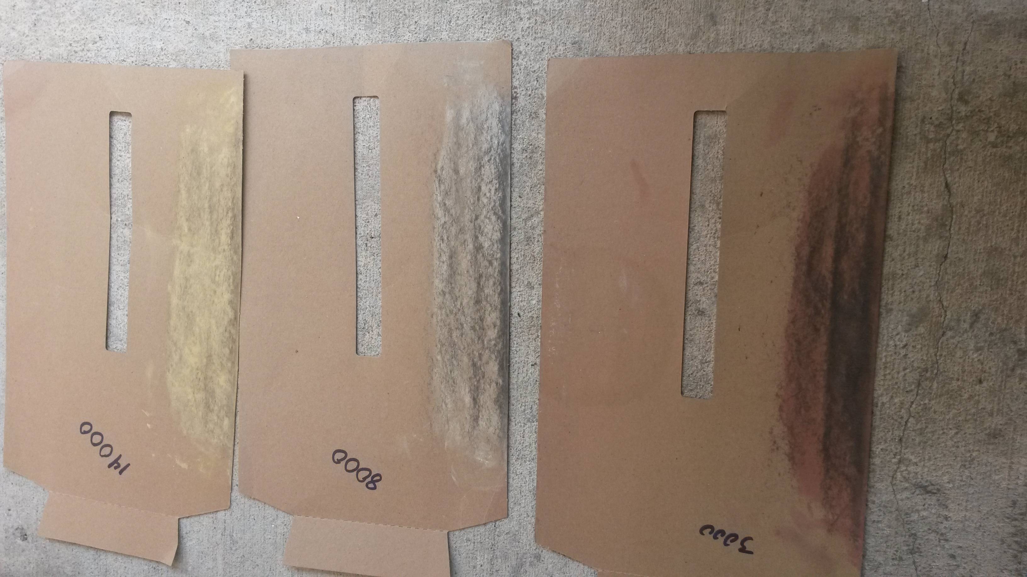

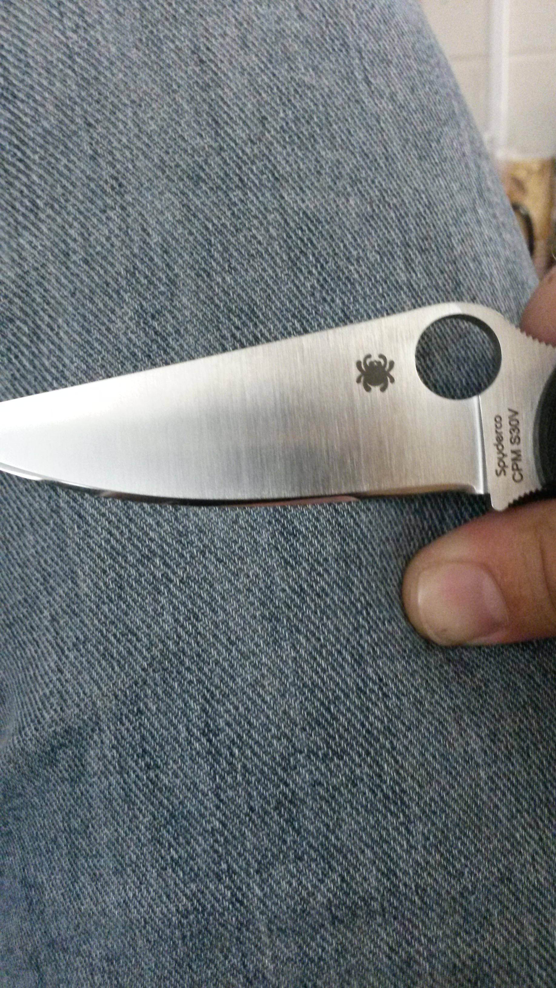

Going up to 1000 grit without stropping or anything has rarely left me with good results. Going to at least 1000 and finishing with at least some finer grit stropping has made my edges far better. Highly polished and hair whittling sharp and I only spent 40 bucks on my sharpening system and another 30 bucks for three grit levels of diapaste.
Well, all that plus ensuring I'm fully apexing at each successive stone and ensuring I remove the burr. I believe that's why the sharpmaker does well for people. When they use a guided system they don't raise the angle by one or two degrees at the very end of their stone progression to fully remove the burr. For instance going from 200 to 1200 grit. Fully finishing at tje same angle for each stone. Once you're done with the 1200, raise the angle from whatever you had been at. Say you were at 15 degrees per side, raise it to 17 or 18 degrees. Do one or two VERY light passes more per side to fully remove the burr. With a crock stick setup it's a given that that'll happen because of the inherent inaccuracy of the human hand movement.
Then move on to strop on at least an old leather belt, in layman's terms, to remove the leftover metal filings and crap still clinging onto the very edge.
This:
and this:
Because of this:
Plus this:
Costing me 70 bucks and some pieces of cardboard that new shirts are wrapped around.

Bodog, thanks for the pics, I'll have to look into that system too.
