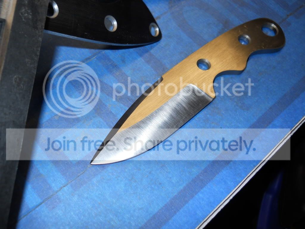

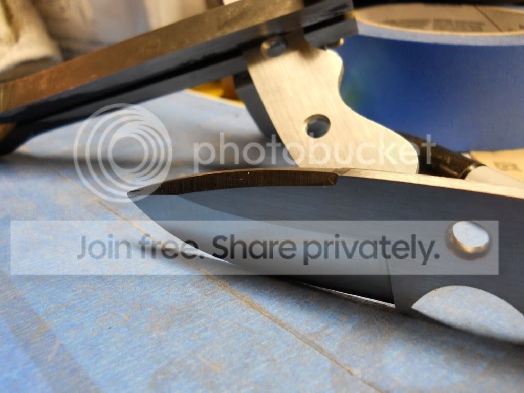

Today's grinding session, does this swedge need changing??
I would bring the swedge to the tip too. You don't need to but if you're like me, you'll probably contemplate that every time you use the knife in the future so save yourself the mental energy and just do it. my two cents.

Well, you guys got me! I was scared to mess it up, but I went for it and ground the swedge out to the tip. I think it turned out pretty good and will try to get some pics up after I deal with dinner and the kids:D

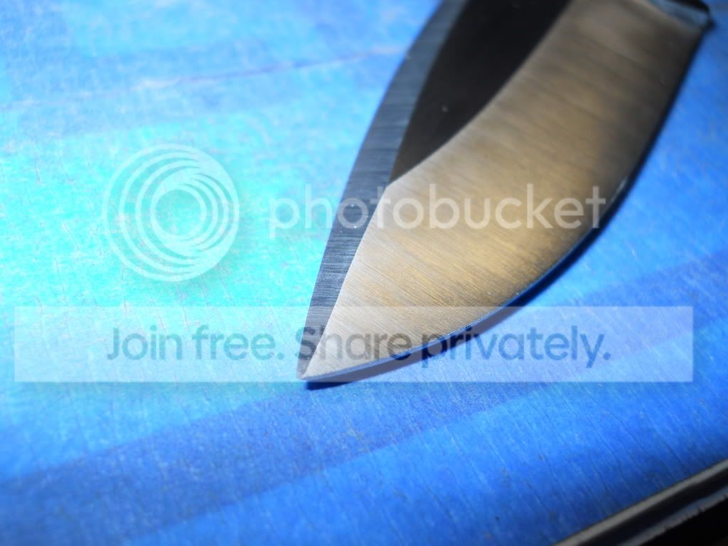

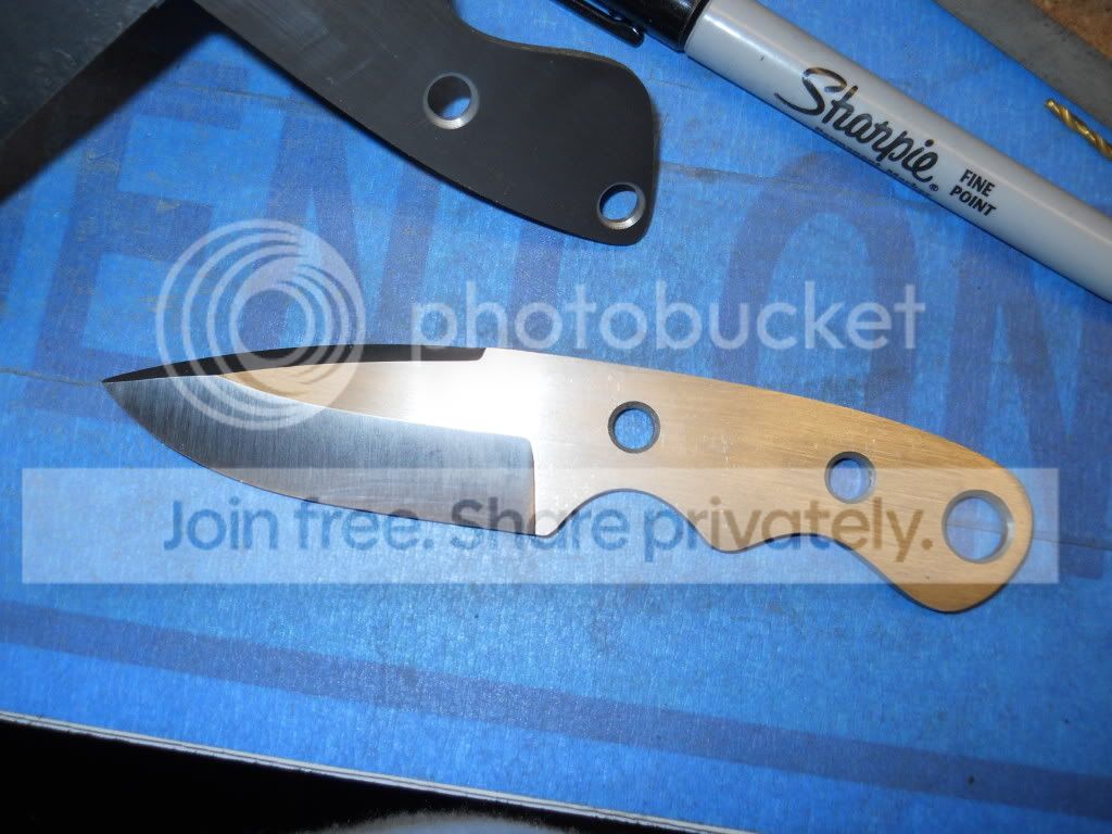

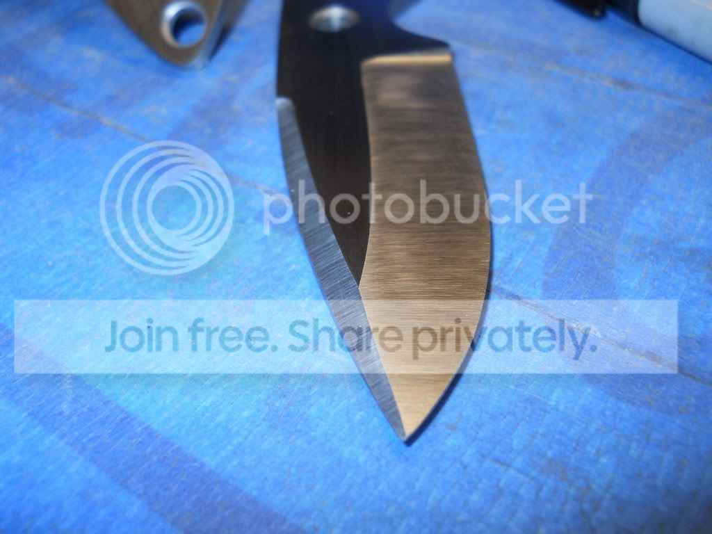

OK, here are a few pics of how the swedge turned out when I brought it down to the tip. I think this one is ready for HT. Thanks for the discussion on this one all. I think I'm getting a little bit more comfortable with swedges now, so from here on out I'll grind the swedge last, bring it all the way out, and we won't have to have this little talk anymore:D

Aren't you glad you went ahead and finished it? :)
That looks good. You have a very steady hand.

LOL, yeah......I'm happy I finished it. Nothing like having guys around who'll keep ya honest:D
I really did think it looked alright the way it was, and I don't think those who said it looked ok were just trying to help me be lazy, but I realized that just by feeling the need to ask the question there was already enough doubt in my mind that it would have bothered me if I left it.
Nice work Jonny,
Now doesn't that feel awesome?:D AND your confidence just gained a notch on the handle too. That's the best part, at least for me.
I'm continually fixing my mistakes when I just can't leave "good enough" alone, but when it finally comes together I'm always far more satisfied and the lessons that got me there are usually irreplaceable.
I think it looked just fine before, but now it looks perfect.

Get it ground to at least 400 grit before you harden it. You won't like trying to sand any kind of deep scratch out of D2 after its hard. I usually go higher than 400 so I can easily see anything I missed at 400.
I am also gonna recommend grinding to the tip. It will look more professional. Also because you are still pretty new at this , the experience is good for you. Start compromising now and it will become commonplace. Demand the best from yourself and you will soon conquer that grinder.
BTW , the grinding is much improved and looking good. Congrats !!
