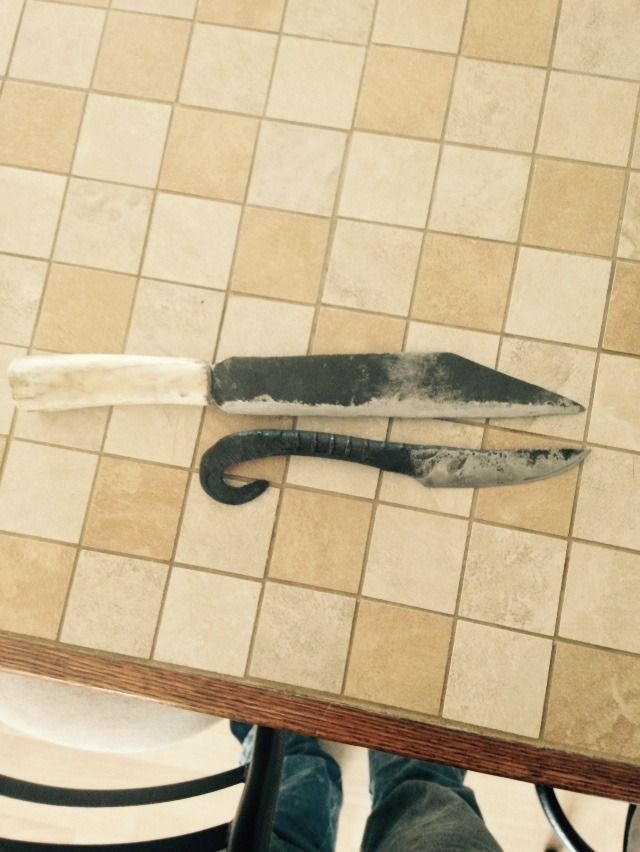

Gotta get myself to sanding the bone one final time, polishing the edge out and all that fun jazz. Life ain't so quick and easy w/o a belt sander

p.s. - forgot to say i like that seax a lot.![]()

It's not too bad with the dimpling now with my awful hammer strikes, you should have seen my first knife, that was made with the logic of "big hammer hit hard make knife".
RR spikes don't harden very well, only about 1040-1045ish. I could probably case harden 'em or come up with some super soaker for them but it really isn't worth the effort when I've got a bit o' rebar left that hardens much easier.
Nicely done!Heated it to ~1500 degrees and quenched the edge, let the heat sink back into the blade from the spine to temper it. No hamon though, got's myself a bit too pieced-together forge for that.
