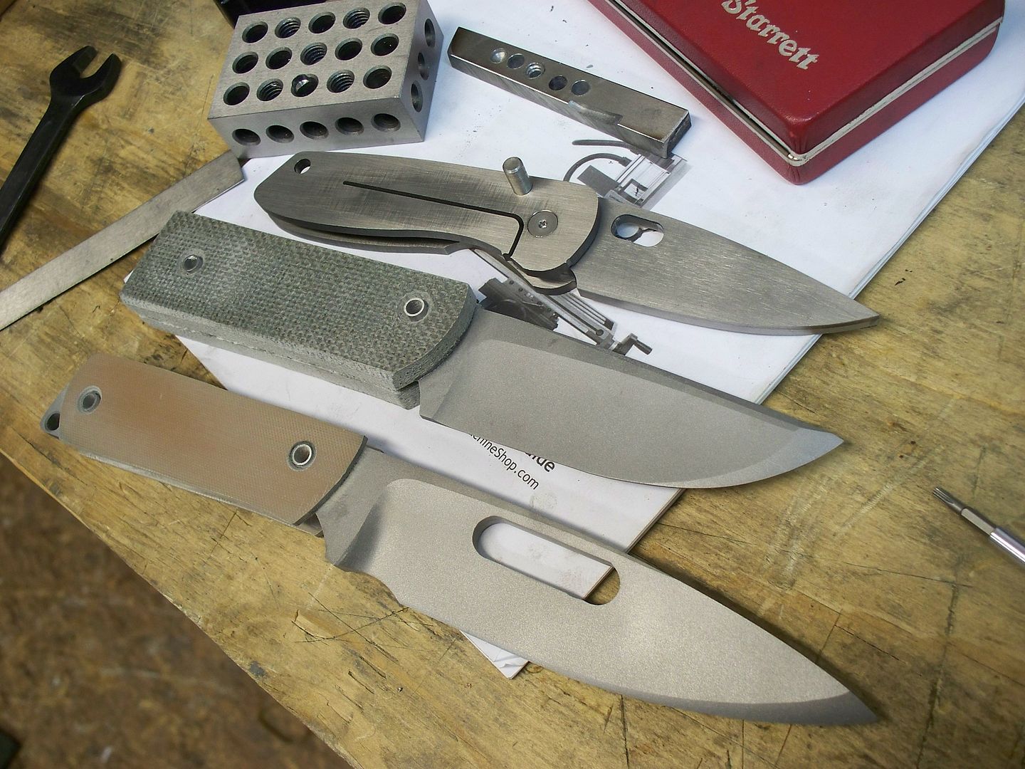

Time to grind some scales! I'm working on the bottom two today.

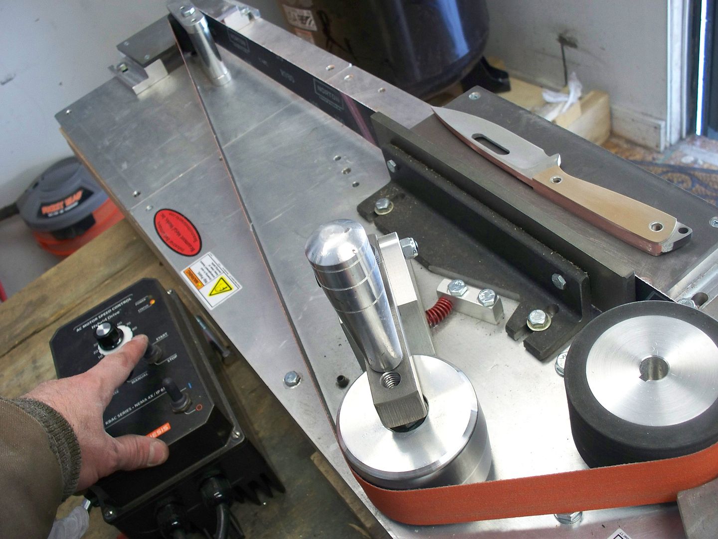

Tubes ground over 40, 80, 100 and scotchbrite belts... they need to e smooth on the end for flaring. Then they were flared... Scales ground on the perimeter and cleaned up... time to do further clean up work on the horizontal grinder.
I just used a 1" wide 220 belt to chamfer every corner on the knife. After that I went to the buffer and "melted" down everything in contact with the hand. I do this on pretty much all of my knives at some stage.

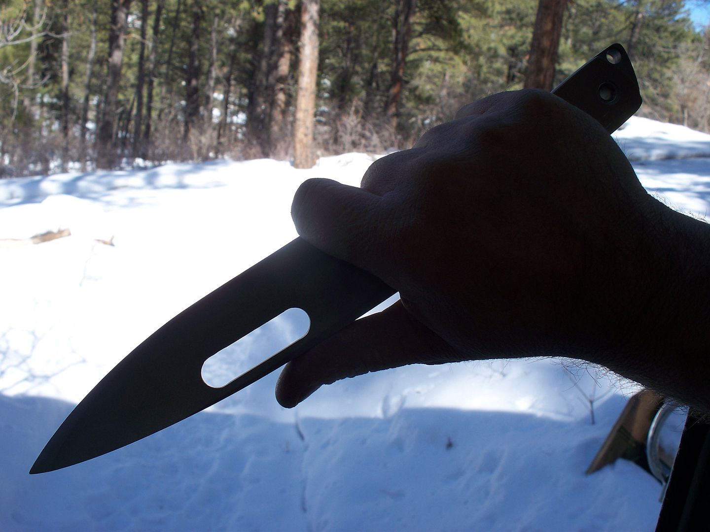

Checking the choil for comfort - it feels great! It is mirror polished in that area at this point.
Thanks! I just uploaded more photos. I'm heading down to the shop in a minute to work on them some more. :D
Profiled... that's grey (looks kind of green) burlap handle material with a green glow!
And here's where I'm at now... comfortable scales but I have lots of finishing work to do.

I tested the big one on paper and it cut a loosely hanging piece. Freakin' scary for a big knife. It isn't as good of a slicer as the Pirate Sword but is not bad for .315". I'd put it up against most any 1/8" knife as a slicer. The tip will do some damage though! fatty tip
I'm coming around to that high saber grind on a modern knife. My friend had me sharpen a Spyderco Military that had a really nice CPM SV30 blade with a faux Scandi grind (That's one continuous grind from spine to edge, eh?) that had a particularly nice feel. First time I've seen that on a fighting-style knife.

Yeah it is almost a full height grind but I leave a bit more meat on the spine and less on the edge...
A true scandi with no secondary is a nasty grind, all edge! I am a big fan. They look easy to do but are tough to get perfect.
