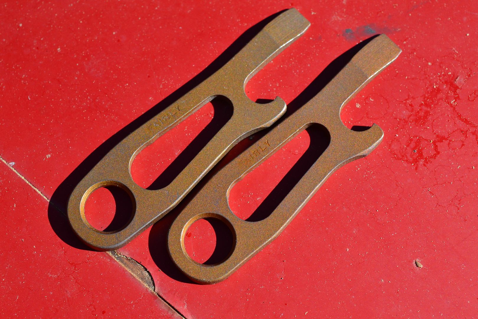

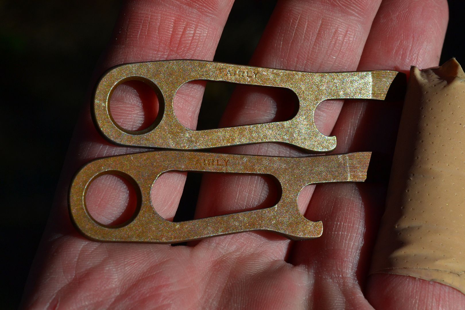

KCT's! Tie-Dye Finish! I should have these and the "metallic stonewashed" ones up tomorrow.

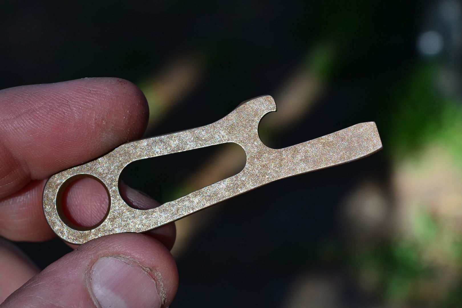

Stonewashed KCT's - metallic finish! at one angle they look like steel, at another maybe copper or brass and they are Titanium all the way! I need better pics to really show them off.

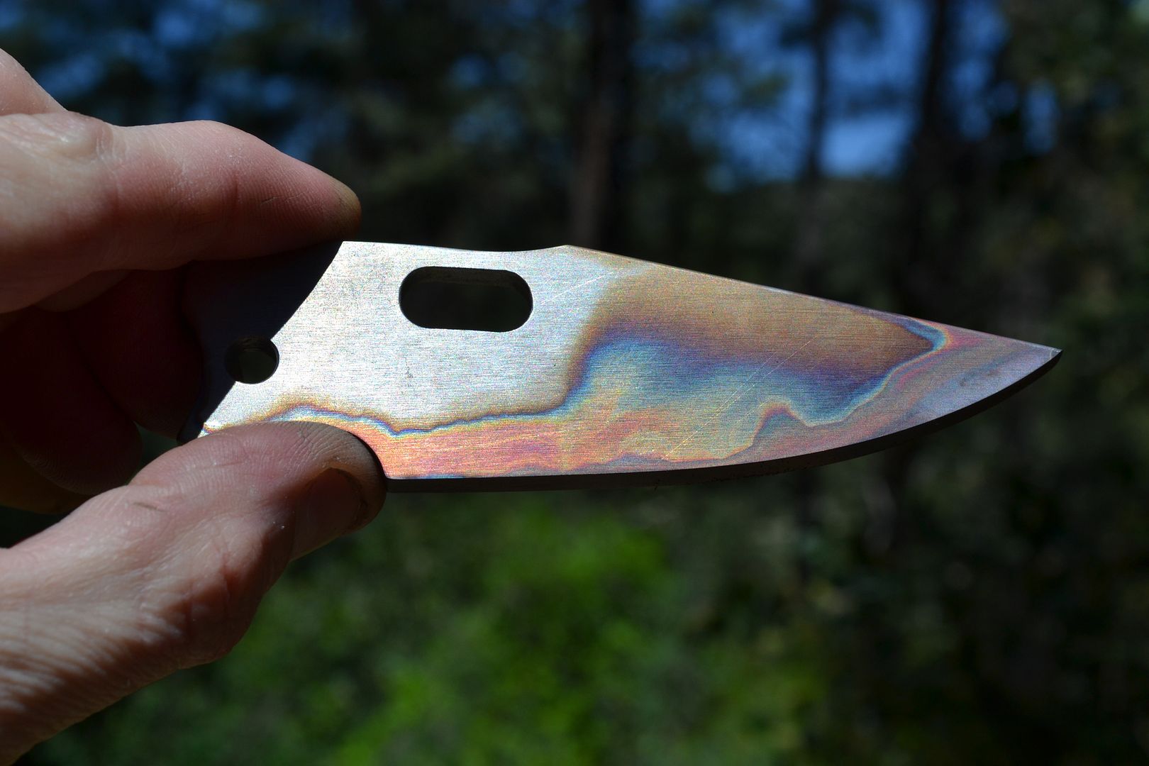

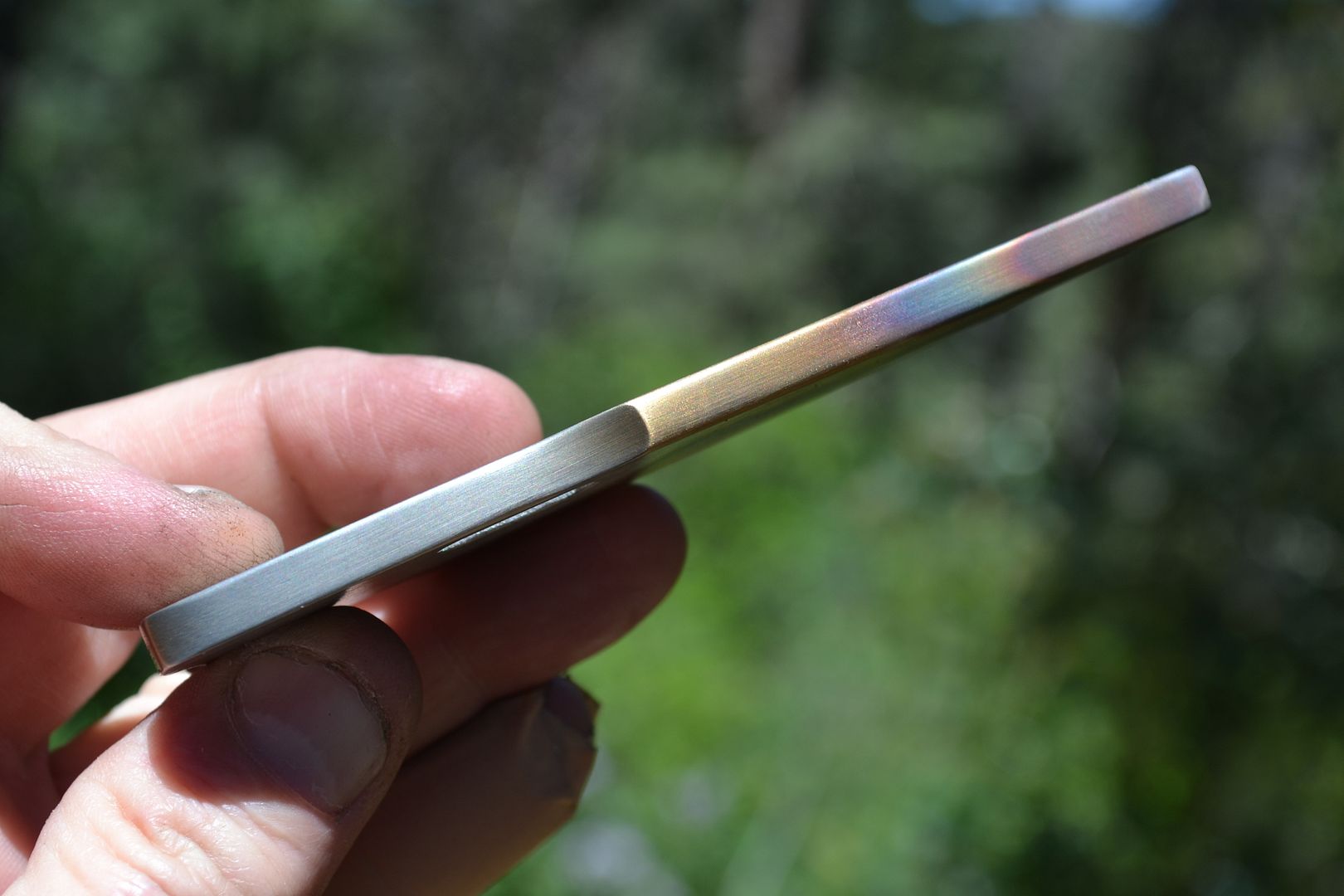

Folder! Rounded where it counts...

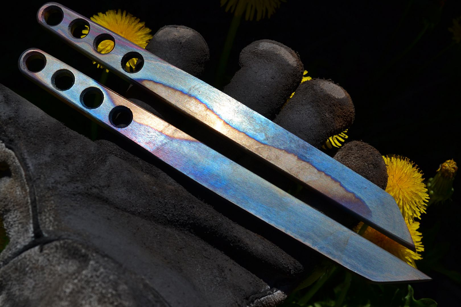

.315" A2 Steel Tantos!
Loving the metallic finish Daniel! Cool rainbow effect on the Folder Blade too Bro! I'll take mine in rainbow python colors please : ) Seriously though that metallic finish is the bees knees. What's up with that blade you have or had in the folder proto on photo bucket? Was that a spear point grind? These are going to be fantastic folders. Thanks again for sharing the pics. I need a pick me up after Thrones lame season finale last night.

Wicked cool. I always wished the temper colors were more permanent.
-X
Me too! As a note those colors are what they looked like after taking them out of the heat treat wrap, they didn't change color at all during temper. I think temper colors are from oil on the blade as these were squeaky clean when they went in and gained no color.
Awesome stuff! Love the bronze anodized look.
Thanks! They seem to change finish depending on the angle... :D

Nice! Like them tantos!
Thanks! They are .315" A2 and if I recall correctly roughly 9.5" long and 3/4" tall...
