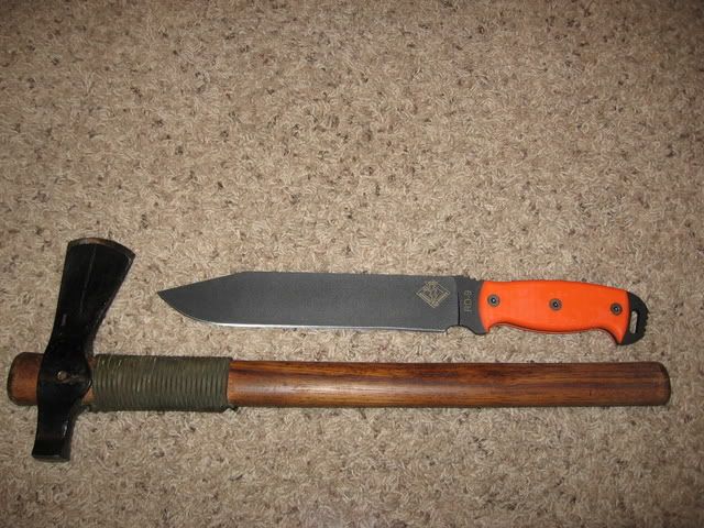

I ordered a pair of Cold Steel 'hawks, a Norse Hawk and a Frontier Hawk. When I took them out of the bos the Norse Hawk head fell off, and the Frontier Hawk head wobbles around.
The Frontier Hawk has a small set screw that I haven't messed with yet.
I have no idea where to start getting the Norse Hawk head on tight. Right now I'm thinking about a drill press with 2-3 set screws.
I could be way off...What should I do?
The set screw(s) will just scrape or split the handle when the head moves in spite of them being tightened down. Custom fit the handle to the head instead.
Remove any metal burs on the inside of the eye and then shape the handle slowly to perfectly fit the eye. I did this and then placed a paracord wrap below the head and I have no problem with the head coming loose. I don't throw mine though. It's a trail hawk by the way. Here's a crappy pic but you get the idea.

You could probably get away with just some coarse, medium, and fine sandpaper. If you have a Dremel, it makes de-burring the head a bit easier, but sandpaper and elbow grease will do the trick.
The key is to test fit often, and the goal is to achieve a uniform fit that does not show gaps between the handle and head.
