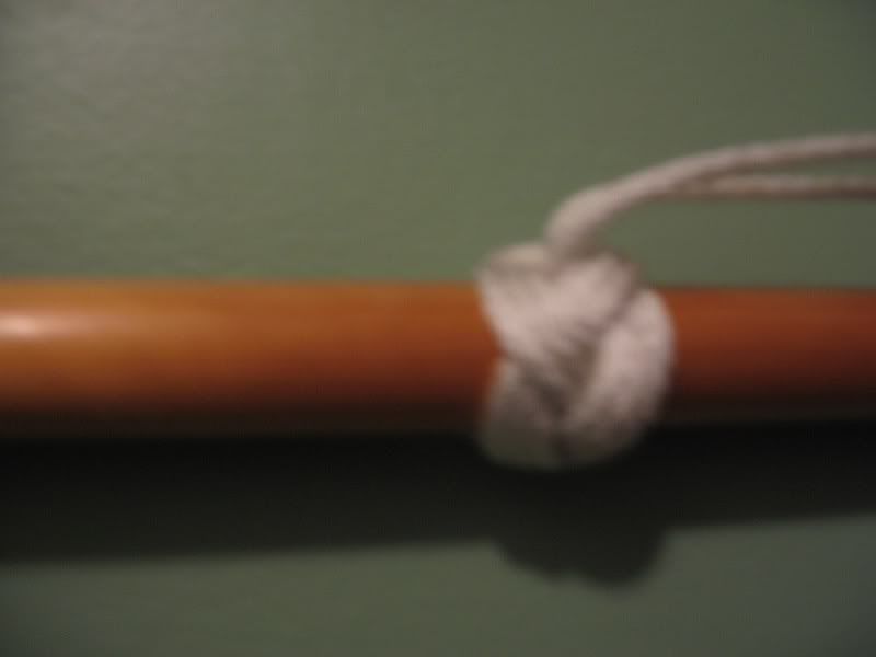

Hey ya'll sorry it took so long to ge tback, had to charge the camera (just finished moving) and then since I am a Linux user, my Os of choice doesn't currently like my camera. So there was some work involved in getting ready. Also some are out of focus kinda bad, sorry in advance.

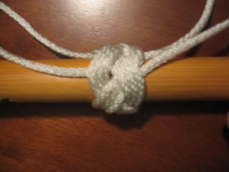

After starting the knot as outlined in the nice drawing form the link, you get this, right before the last pass is made, you can count two where the others are three.
The last pass is made as it would be without the haft modification i discussed.

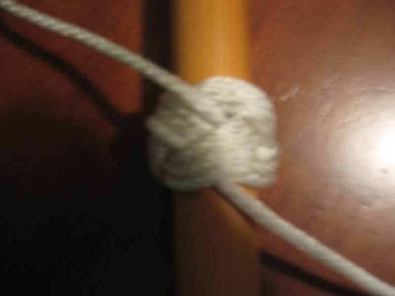

the lead that ends on the underside of the knot is passed up under the entire knot.

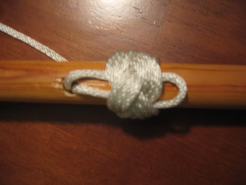

theres the start of the mod passing both leads into the hole, and then working them through the center of the passes on the oposite side exactly 180 from where they came on the other side.
there you go, not tightly seized up, but once you get it done the leads that pass through the knot act as the stopper it wont slip off. So now you can really get a power swing out of a hawk that otherwise would take alot of effort to hang onto, especially if you got say blood or an other slippery thing on the haft.
