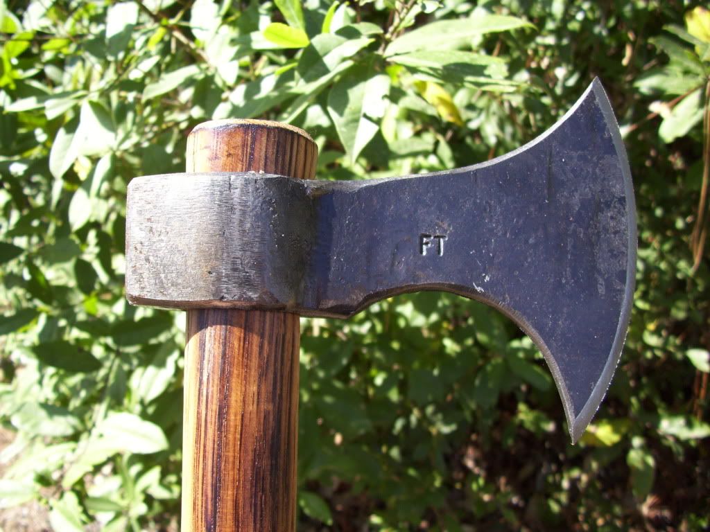

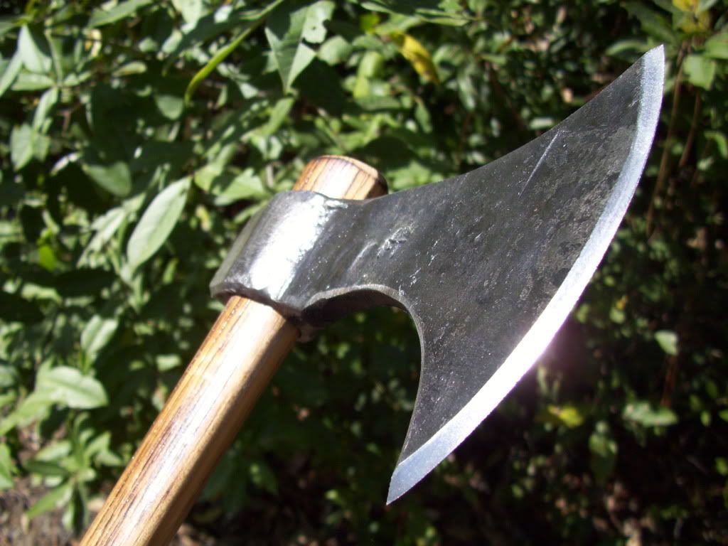

There's many useful hawk head shapes, though I'm partial to the longer-edges ones like the Cold Steel Frontier hawk, or my favorite, the Norse:
Fine, sharp edge.

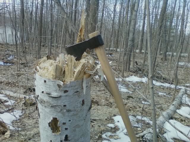

On a side note, the actual making of a hatchet handle is just as easy as making one for a hawk, assuming we are willing to lower our standards to the same level we do for hawks: http://woodtrekker.blogspot.com/2011/03/best-chopping-tool-hatchet-vs-tomahawk.html
