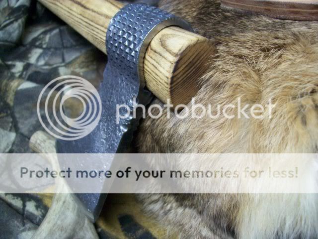

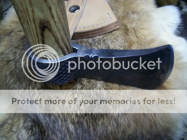

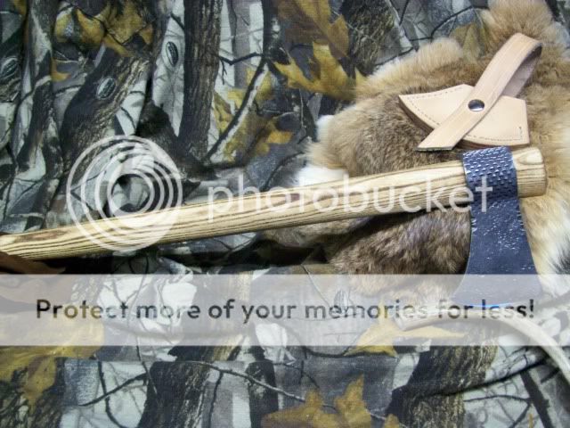

This is a traditionally forged tomahawk/trade axe. Not exactly the straight shouldered belly of a trade axe but not the deep sweeping belly of a hawk either, so take your pick
Anyway its forge welded from a good quaility rasp. The rasp my guess being something akin to 1095. Edge hardened and tempered. Hair pop'n edge. Left with a forge finish. Some light filework on the spine and belly. The cutting edge is 3 1/8" wide and the head is 5 3/8" long. The haft is Ash, lightly burned and finsihed with boiled linseed oil. The sheath is 9 oz leather finished with neatsfoot oil. We are asking **SPF** plus $10 shipping (priority with conformation) We take paypal and money orders. Our paypal address is phllpwest@bellsouth.net
