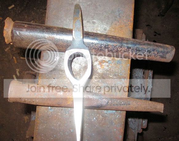

i dont know the right terminology so please bear with me. the hole in the hawk that the handle goes through, do you resize that, or reshape it at all?

Yes Jake, It is resized and reshaped with a drift. Here's a picture
