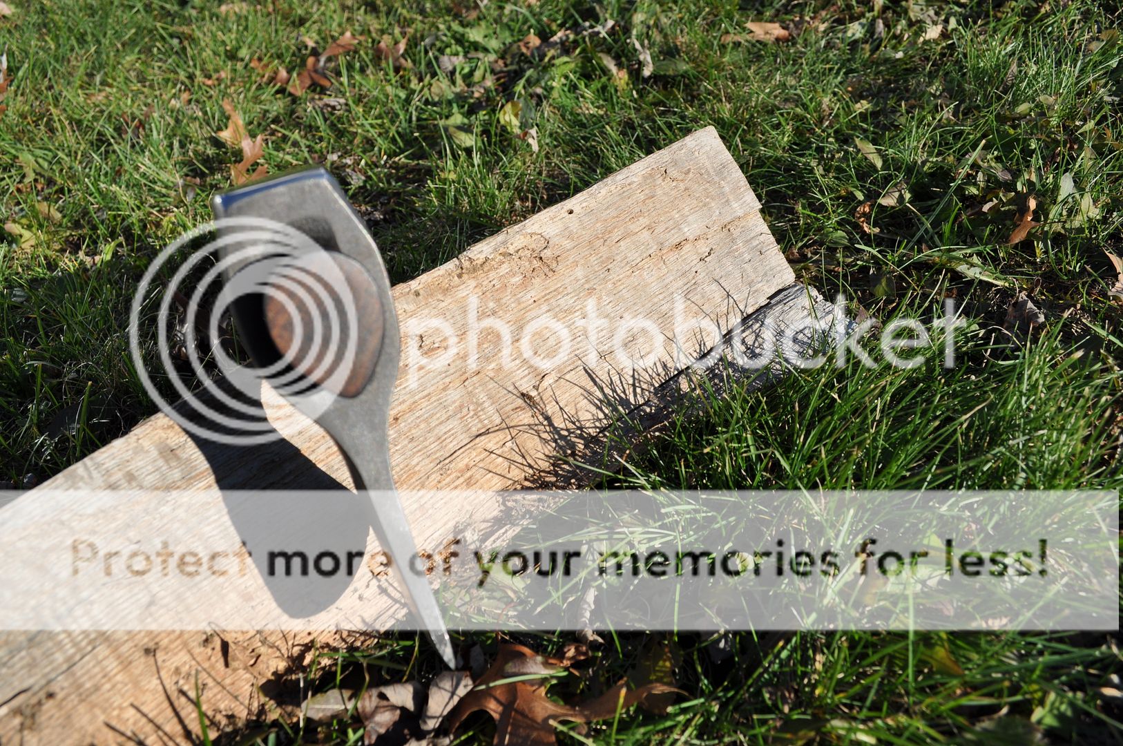

I don't have anything from Goran but i do have one from Cegga.
That Cegga is beautiful, especially on the straight haft. Looks like about a 2lb head, is that right?
