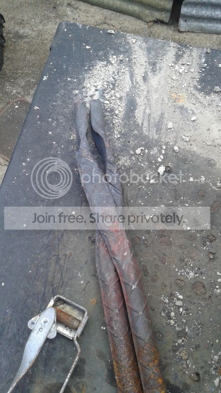

I made my first (and only) pair of tongs tonight.
They are soo ugly, and heavy, but they work great and I try not to be but I'm a little bit proud of myself.
I don't have much forging experience and I've never seen anyone make tongs but I was pricing some yesterday and decided I could just make my own after seeing some prices.
I used 1/2 inch rebar, and didn't draw the reigns down any so they are WAY heavier than they should be. I didn't think about that when I started and I can't pass through my forge. I may just grind them down on the grinder.
For you guys that make your own tongs what do you use? I'm thinking some 1/4 inch cold roll would be the trick. I will take some pics tomorrow, they are ugly and I may adjust a little so the reigns are just where I want them but they close true and tight .

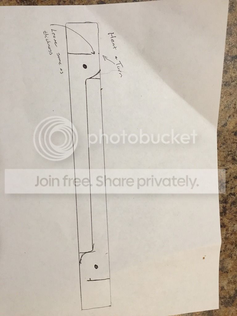

This is the easiest way. (Not the best, but easiest). Start with 1/4 X1 or 5/16x1". Cut all lines, heat the end and turn it 90 degrees. Drill and rivet.
That would have been soo much easier. I think I'm going to try and find a piece tomorrow and make another pair. How long should the reigns be normally?
At least 12". You can always cut some off. I guess you could weld some on too if you didn't want to cut so much, could be stubs and weld some 3/8" rod on.
I started another pair today but I spent all day on a class for work and my back is stiff so I didn't get through. They cut and fold out of barstock is a lot easier.

I don't disagree with any of the advice given, I am actually very appreciative.
I do need the practice, I am not doing it because I am trying to save money. I am not wealthy by any means but I could afford to buy tongs.
The real reason I did it was practice, and I figured I could make a pair faster than I could buy and ship a pair. I am glad I did too,working on a second set now, and I know by the time I finish I will have a very good idea what I want in tongs.
I laser cut about a dozen tong blanks and will cut/weld/forge them into what I need, then forge the handles round. Let me know if you want a pair to play with. I made the loop fairly big but that's easy enough to forge where you want.
