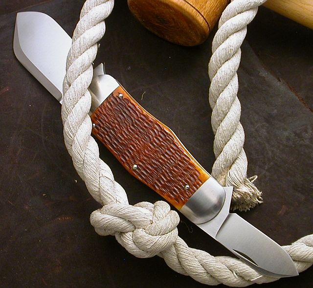

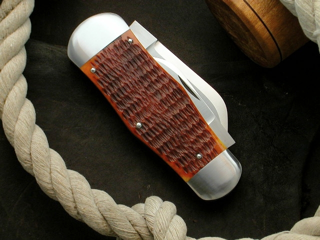

This is the rebirth of the Platts pattern that was last made between 1900 and 1905. The old ones are extremely rare and quite valuable.

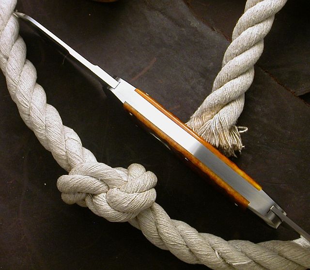

The blades in this knife are D-2, main blade has double pulls. Notice that the long pull extends thru to the end of the tang. 410 SS bolsters and liners. SS pinned shield. Red Jigged bone scales.

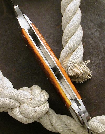

THe blades occupy the same space and share one back spring. Because of this and the fact that the blades are different thicknesses, this knife requires the use of "catch bits"(spacers added to liners). You can see them in the third image at the top-left and bottom-right near the blade joints.

Outstanding yet again, such fine jigging on the handles and the color of the bone, awesome! Love that matt finish on the blades, Sweeet.

What a piece of work! I've never seen a long pull extend to the end of the tang.
Long pulls extending through the run op is common on very old knives, they did it on Sheffield knives. In this case you couldn't put a long pull in the knife if you didn't do it, there isn't room for it.

wow, that's a nice looking knife, nad I don't like toenails! I'll bet the blades are ground thin as paper, with that long flatgrind. Most excellent work sir.
Very nice! One of those things that trips my trigger is when the fitting on the backspring and liner is so precise it makes it look like a single piece of metal. Oh yeah, the rest is pretty, er, sharp too!
