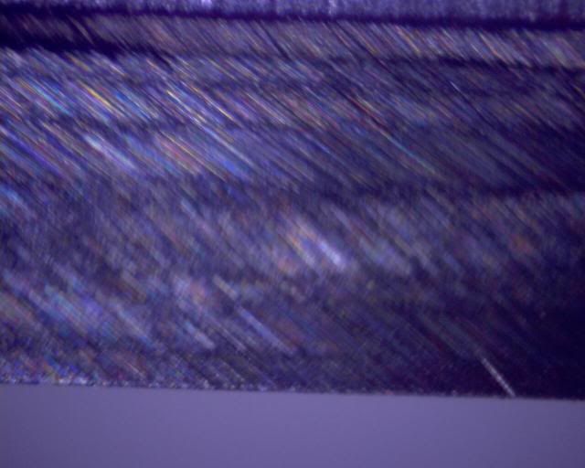

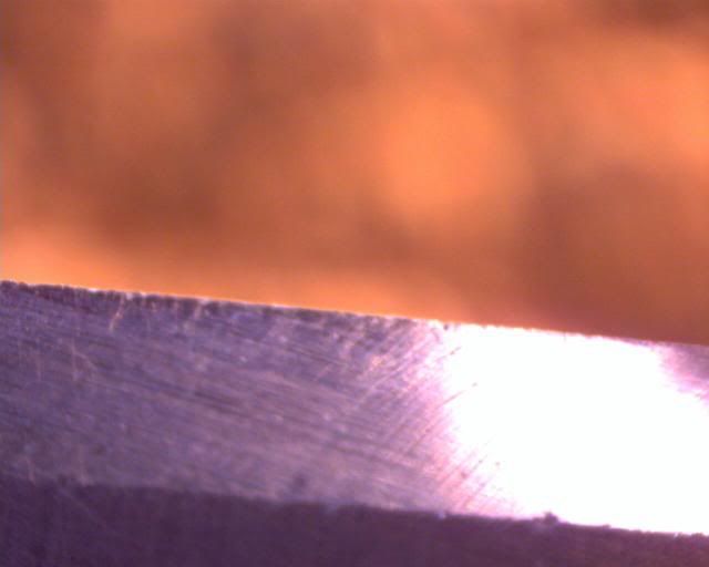

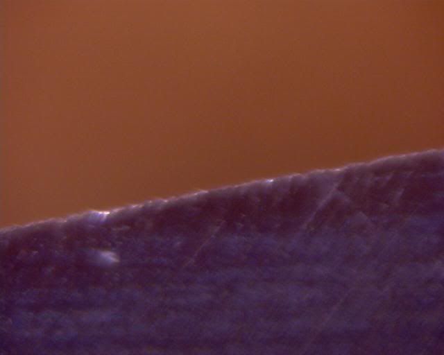

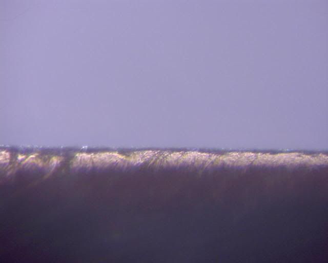

Here are pics of edge that are worn, damage usually able to be felt but unable to be seen by the eye .
This is a edge finished by a DMT EEF, to the eye is looks like a even finish but up close you can see all the smaller lines of scratches made by each pass on the stone. You can also see the small burr and left over plastic deformation from the sharpening process at the very edge.
This is what's left of a microbevel on S90V after some extreme cutting, note this micro bevel cannot be seen until 100x pic at 400x
