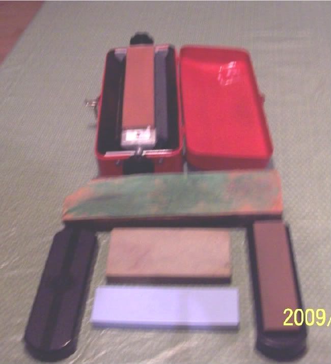

Show off the tools you use to sharpen your Buck.
My picture will follow: but I have a vintage 1982 Norton Tri-Hone with new stones. A coarse/fine crystolon (Jum-3), a fine India IM-9 and a 800 grit sandpaper stone set up like 334 Dave's . Others I like using are a Norton IB-8, Spyderco fine ceramic, a old 4X8" Translucent Arkansas and a strop . These will get the job done for me . DM :)
For David.
