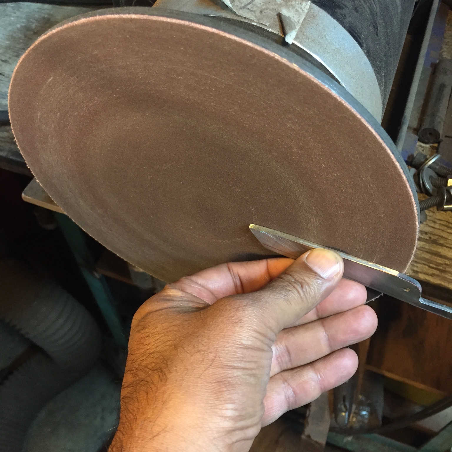

I thought I really did not have to have a reversible 9 inch disc grinder and table until I started to use one and now I use it on every knife I make. Having a table that adjusts quickly to different angles is a very useful thing and the reverse switch is essential to me now. This tool and my rotary platen are now tools I must have. I'm pretty sure most of you have tools you were not sure you needed until you started using them. Larry

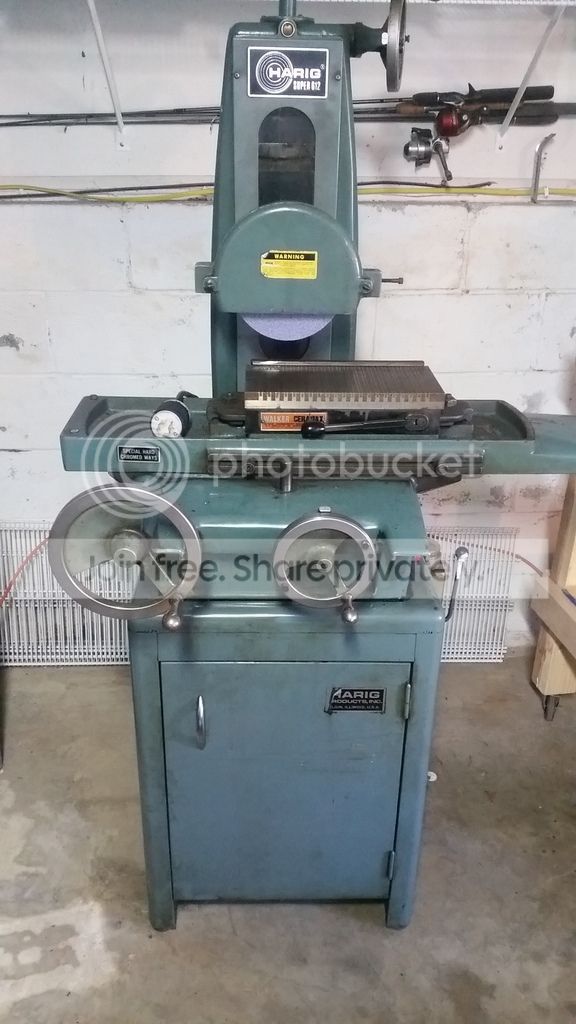

My surface grinder.
I bought it for making folders and end up using it on every knife. I enjoy using it even though it is manual feed.
I'm getting ready to make a belt conversion, but still have the capability to switch back to the wheel.

Josh, that is a really nice surface grinder. Finding a Harig in great condition like yours is a good thing indeed. Larry

Larry, when do you use the disk sander in reverse? When does it help to go one direction vs the other?

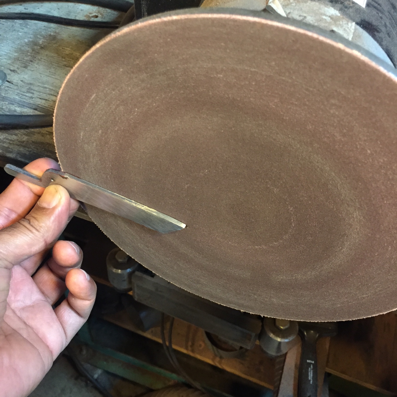

a disc sander with the right steel disc is the cheapest grinder to have. I have 2 of them so I don't need to spend as much time changing grits.
Hook it up to your main ginder VFD and it's almost invaluable
If you can't get a steel disc plate, you can get an aluminum one and buy 3/8" or 1/2" micarta and glue that onto the alum disc.
if you are grinding a blade on the disc, edge up on one side, you need to reverse the disc to be edge up on the opposite side of the blade..

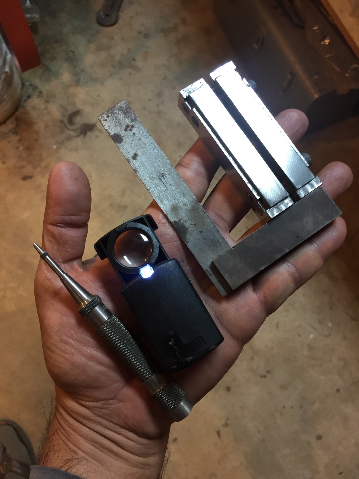

what is that Nathan... some kind of dremel clock? lol. Whatever it is, i am glad you have it if it helps you make your field knife... only fixed blade knife on my list right now.
and now to my never withouts: bruce bump file guide, calipers and a contour gauge to get both of my scales relatively even... since i don't have a dremel clock of course.
what is that Nathan... some kind of dremel clock? lol. Whatever it is, ..., i don't have a dremel clock of course.
It's like a Cnc machine tool sensor in 3 axes
It's an analog edge finder, it's used on any mill not just CNC (our manual mill is also 40 taper) it tolerates over travel, it works on non-conductive, when properly configured it's very accurate, and it works in 3D. I used it yesterday setting up to mill bevels to measure my fixture angles.
You always put your work on the table where the disc will be going downward . If the disc rotates clockwise then you hold your work against the disc on the left side. If you want to hold your work on the right side because you maybe want to hold a portion of your blade off the table you would need for the disc to rotate the other way and that is why the reverse switch. As soon as you start using a reversible disc you will discover that it does some things that you really need to do. I flip that switch at least once while working on every knife. Larry
