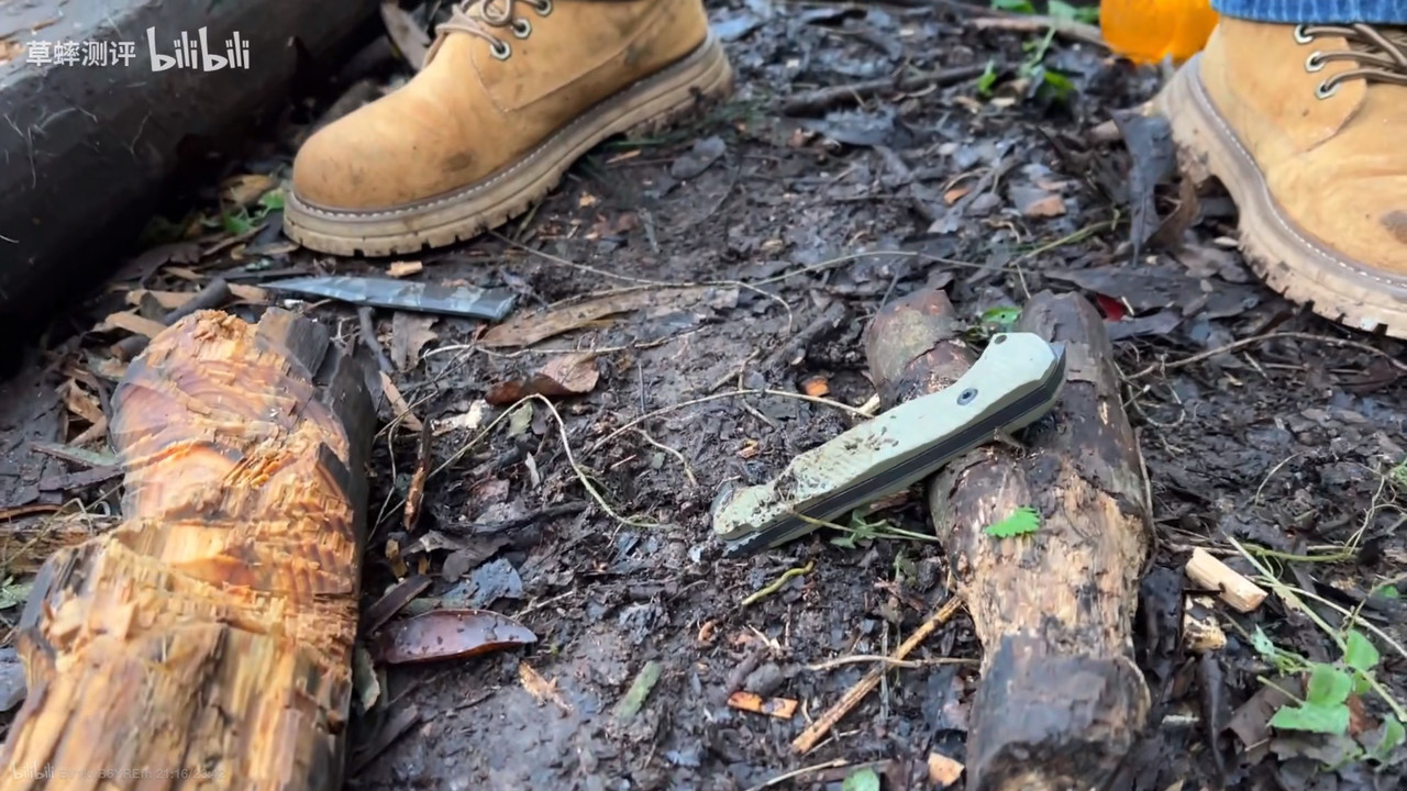

A friend of mine is a knife reviewer in china, he tested a knife in topic recently and it broke.
Three days ago, I sent this to Toor Knives on their contact us page. They haven’t responded.

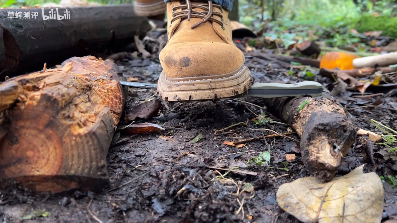

My friend in China who is a knife reviewer broke one of your knives during testing and it was the first time a knife he ever broke. It was broken in the specific step, in which he steps on the knife, he does this to every knife he tests and no other one broke.
The model is a limited edition Tropical Thunder Valor , CPM-3V version.
He considers this a premature failure since it is 5 millimeter thick of CPM-3V and asked me to help him contact you guys for explanation and warranty claim. He might contact you himself later.
He has posted a video on a popular video platform, here is a link to it, you may see the tesing and decide if it falls within your warranty. The knife was tested new-in-box and was not modified.
The link leads to his video.
Here are some screenshots from the video.
That knife looks like Sabre ground 3/16 stock. I would have assumed it would have taken a bend. But I don't know the context of the test. Did it already have damage, that propagated a crack.

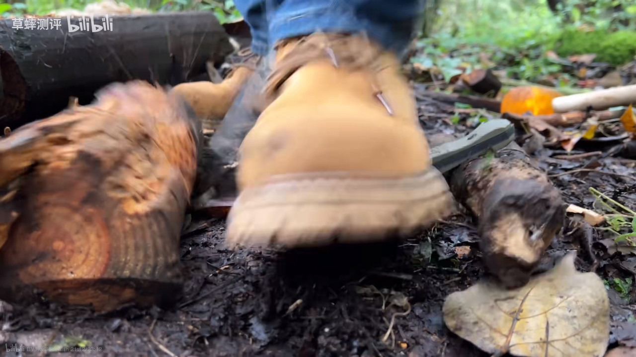

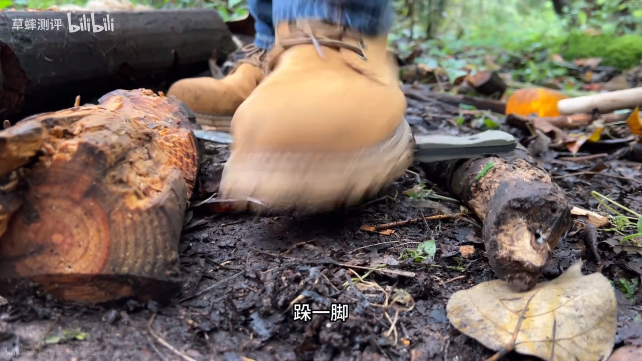

Guys, I think your opinions are reasonable. He does step on knives often, but I just checked, he rarely stomps on knives.
It could be that stomping is simply much harder on the knife than standing on the knife since it is dynamic.
I have sent him a meassage, asking him to try stomping on some more knives so it can be compared.
If most knives of similar design breaks, it would indicate that stomping is simply too harsh.

It was not damaged prior to the stomping, his tests are mostly rather mild outdoor use until the tip and blade integrity tests.
Rapid energy transfer vs. gradual application. One easily allows the material to deform and redistribute stress and one does not.

I question why the reviewer would suddenly choose that moment to change the nature and intensity of his "step" test into a "stomp" test, and how he expected to gain meaningful data by doing so.
It was mianly impromptu. He also stomped on a Kiku Matsuda knife in a recent test, but he didn’t do that to many other knives.

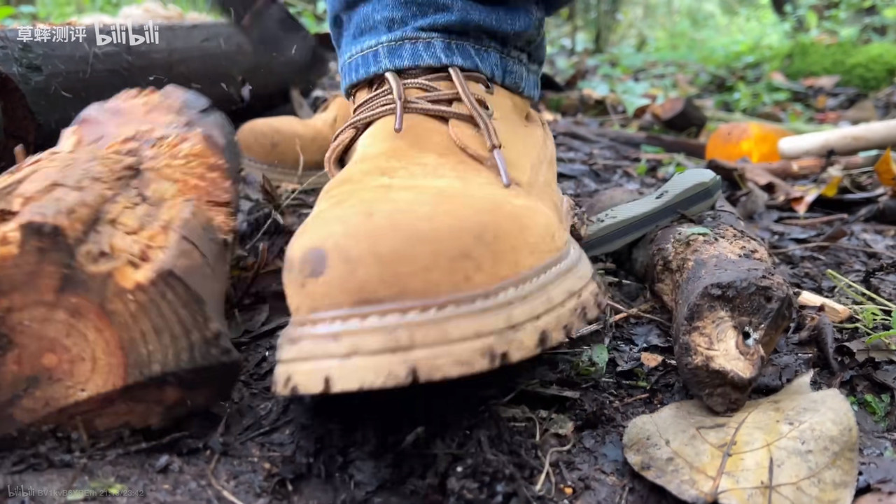

The broken pieces remain straight hence fractured in elastic range, where elastic/spring flexing blade shouldn't failed like that. Look like fractured was initiated at 1st/front jimping grove, where stress/strain forces concentrate at 1st grove's since it is probably the inflection/mid of the 3 points bending test. W/o jimping, I think this blade would pass the elastic flex test... While, 3 points plasticity test probably best done in control/shop/lab setting
