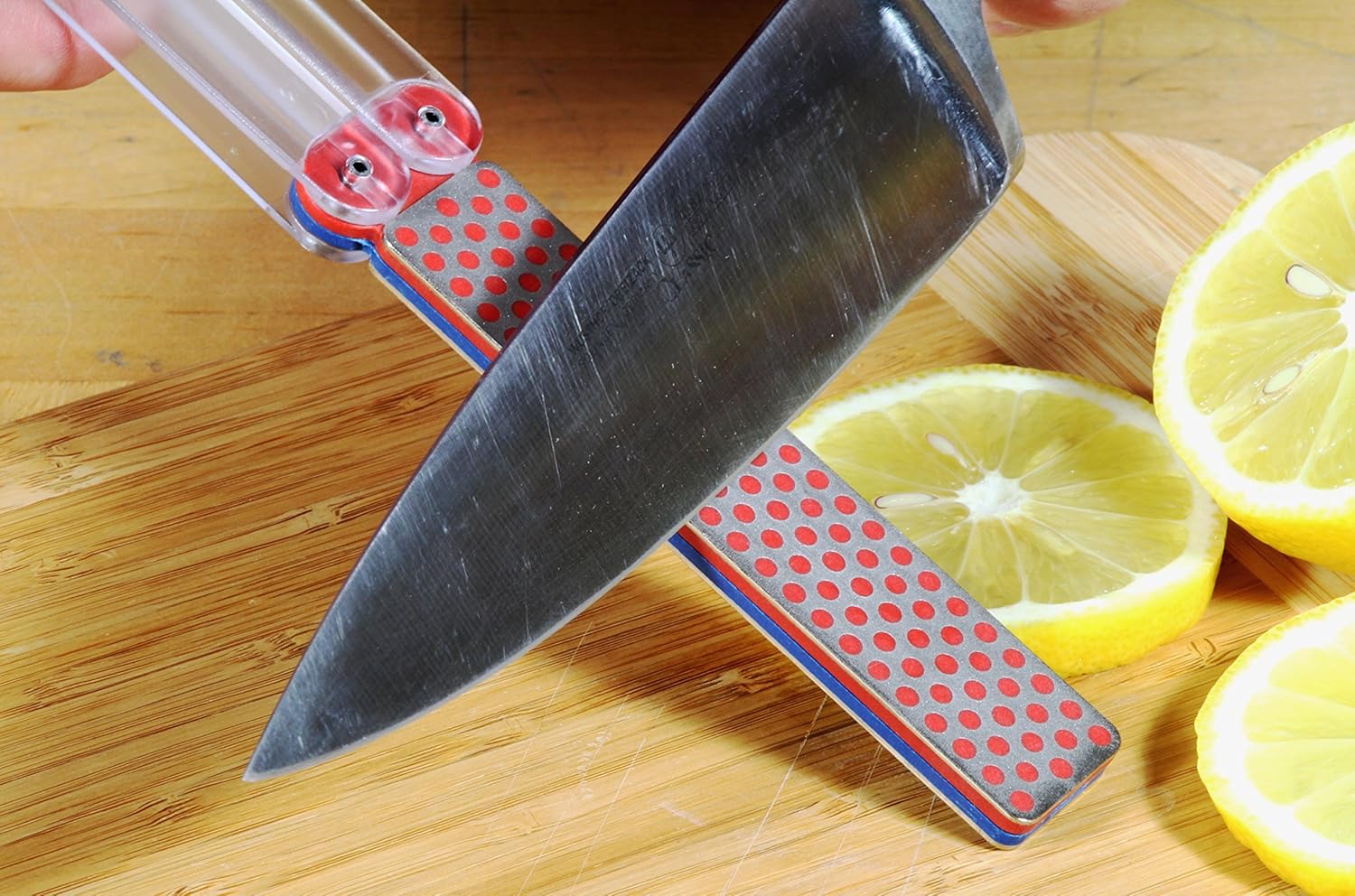

Hi,
I would like to know the best way to maintain 400-600 grit toothy edges on good quality, high carbon, fixed blade knives, such as an Esee 4, for outdoor use.
Since I often use these knives in the wilderness I cannot carry a lot of sharpening tools and accessories. Even at home I like to keep sharpening simple with a minimalist approach, using as few grit sizes as possible. I only need good utility edges that do the work I need them to do and do not spend time and energy getting knife edges sharper and more refined than what I need. I only freehand sharpen, mostly with diamond benchstones, so am not interested in suggestions regarding sharpening machines and devices.
My understanding of stropping is that it polishes and refines a smooth edge after it’s sharpened. I would think this would be counter-productive to maintaining a toothy edge, such as damaging or destroying them over time, between sharpenings. This isn't what I'm looking for, and I'd prefer not to have to carry and use messy stropping compounds. If I'm wrong about this feel free to let me know, but please base your info and advice on experience and not theory or guesswork.
That pretty much just leaves steeling. If steeling is the best way to maintain a toothy edge, then I would need to know if I should go with a smooth steel rod, which just re-aligns the edge (depending on the hardness of the steel rod and knife metal), or diamond or ceramic, which also both sharpen somewhat, as well as supposedly remove loose and useless metal. If the last two are recommended, then should I stay with the highest grit I sharpen with (400-600) or go to a 1200 or higher grit rod so I don't remove any more metal than necessary?
I did several searches on this forum using different search terms to try to find the information I need. I was able to find bits and pieces of good info scattered around, but nothing specific and comprehensive about how to best maintain toothy edges between sharpenings without damaging them. If this info is available on other threads I would appreciate links to them.
Thank you!
I'd take a double sided DMT Diafold in the coarse / fine configuration into the field. It folds up flat and small, is pretty light, and the diamonds will sharpen any of your knives. The grits will be 325 and 600, right up your alley.

Folding dmt is excellent for field touchups on any steel and leaves nice toothy edge that shaves hair and still bites into skin.Norton stones are good too but folding dmt is easier to carry.Theres also small pocket norton stone,fine grit sil carbide stone,bought it for 3dol long time ago and is pretty good f9r touchups.
I usually take a Smith diamond stone, ceramic stick combo camping. The diamond gives a nice toothy edge, still capable of easily jumping arm hairs off. The sticks are fine, but still give a nice bite to the edge.
If you like the finish exactly as it comes off the 400-600 diamond, then that's the best solution for maintaining it as well. Focus on keeping the touch very light, and don't grind any more than is necessary to restore the 'tooth' to the edge. It's a misconception that a coarse hone will remove too much metal when used for touch-ups; that's more about using it excessively, either with too many passes or with too-heavy pressure. So long as you don't neglect the edge for too long, touch-ups with a diamond hone can usually be done to completion with maybe ~ 5 very light passes per side, or fewer.
This is one of the things I personally like about using diamond hones; they can leave a clean, nearly burr-free finish on their own, used with a very light touch. If any additional stropping is needed, I usually confine that to a bare leather belt (I use the 'suede' back side, by preference) or perhaps just a bare piece of paper laid over something firm, like the diamond hone itself or a smooth piece of wood (countertop, workbench, etc). A piece of bare MDF also makes a good strop for simple high-carbon or low-alloy stainless steels, BTW.
I agree with the above in that the best you can do is carry a 1”x4” medium diamond stone, be it the DMT or the Fällkniven dc4 or even the new Spyderco double stuff 2( this one is coarser).

I have a few DMT Double-Sided Diafolds that I've accumulated over the years, but have rarely used. Thanks to Blues and lonestar1979 for letting me know I am on the right track with these. I will definitely use them more (especially when I'm in the wilderness) and rely on them with confidence because of your recommendations. Bigfattyt, I appreciate you letting me know about the Smith diamond/ceramic combo. I hadn't heard of this product and will check it out further. I prefer double-sided sharpening stones like these and the Norton Puck that David Martin and HeavyHanded (thanks also for your valuable info on steeling!) recommend, for simplicity and to keep the weight and bulk down in my pack.

If you already have diamond stones, no need to run out and grab the Smith combo.
Your DMT double sided stones are all you need.
Though the Smith combo set is inexpensive. I've used mine for a long time, and finally wore it out. I need a new diamond stone!! (Though the ceramic sticks are fine still).
Bigfattyt, thanks for your follow-up post! I checked out the Smith combo online and it looks like a good product, but I’ve picked up a few DMT Double-Sided Diafolds over the years. I haven’t used them much yet, but they are usually highly recommended by knowledgeable knife users (such as on this thread), so I will start using them regularly. I’ve used other DMT products, also, which so far I’ve had good luck with.
