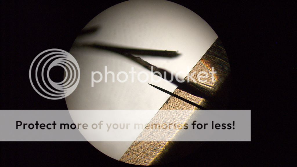

Toothy edge on D2. I just pushed the fine hair into the edge under the microscope. I did this when so many said they couldn't get D2 to shave due to the carbides. I made sure to do it with teeth on top of it.

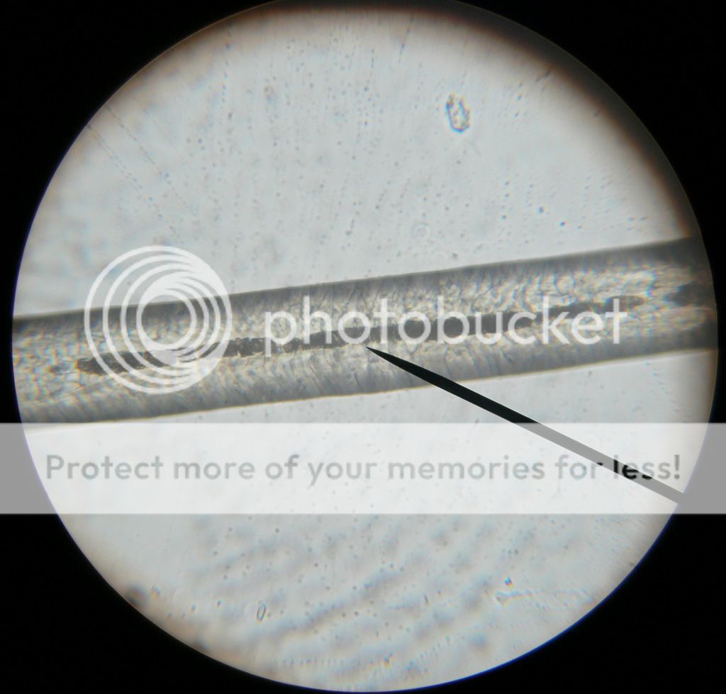

This next photo I shot a human hair to show scale for the grit patterns on the following shot...but its even more magnified as shown by the pointer
Now my user 1095 after about a month of stropping. As you can see, all teeth gone at apex.
Heres the maintained polished edge on the Busse in my pics from previous posts.
