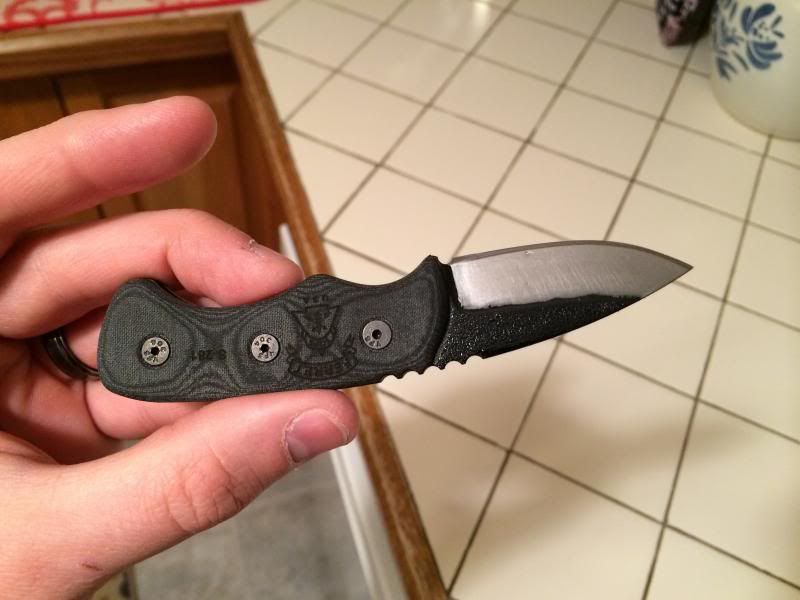

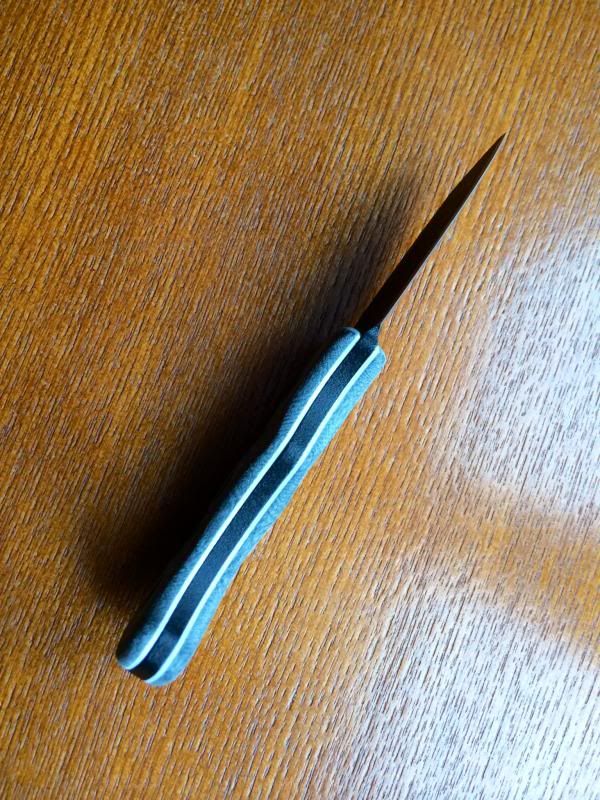

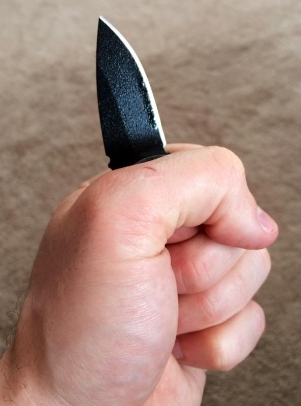

Here's some pics of the knife:
The 2" cutting edge has been very effective for me and I have not felt myself wanting for more in my EDC needs.
The jimping is great and really adds a level of security to your purchase of the blade in hand.
The grind was surprisingly even (only slightly off and no more than any other blade I've owned). It's a 1/8" thick piece of 1095 carbon steel so it's nice and durable.
Where it truly shines is that it combines all the features of a rock solid razor of a 1095 fixed blade knife in a package the same size as a folder (generic Browning that has always served me well).

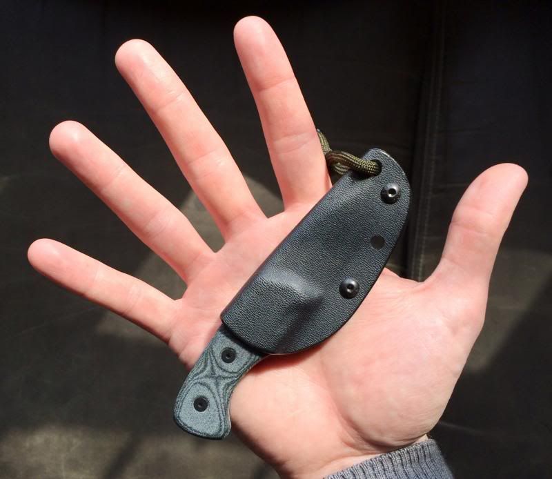

Examples of the way I carry my ferret:
If I think I'll be needing it a lot I put it in my watch/change pocket with the nylon or paracord lead wrapped around my belt loop:
If I want maximum concealment I just plunk it in my actual pocket (with this I just put my hand in my pocket and then use my thumb and forefinger to draw the knife from the sheath, very discreet):

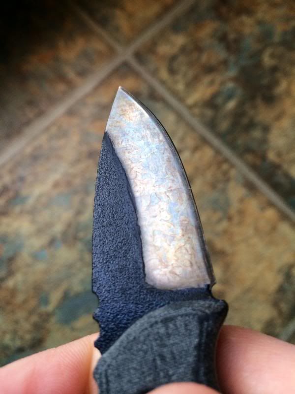

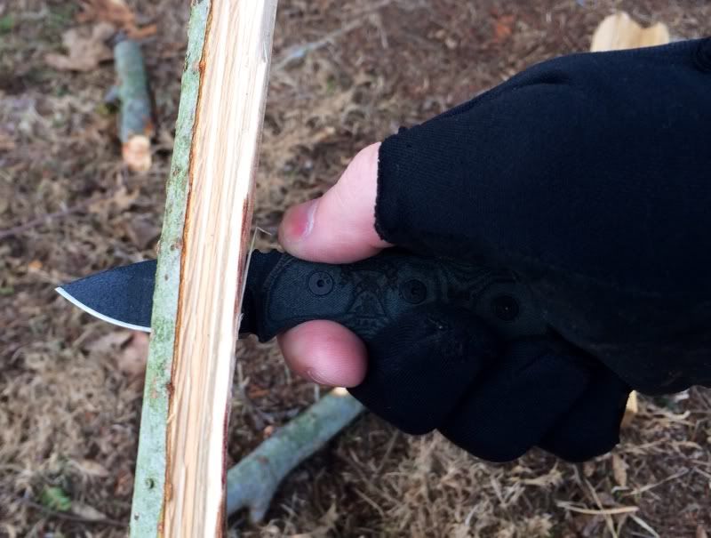

Well as you can see in the above posts pictures I used the blade on some wood and it ate away some of the traction coating (which I disliked anyway) but it left me not liking the look. I decided to carefully using q-tips and paint stripped, a razor, and then varying grits of sandpaper get rid of the coating on the blade area that showed wear and is used for slicing.
I liked how the coating was almost wavy when sanded off on the lines. I could have used the razor to really get those fine lines along the grind edge but I liked the wild look so I kept it. I also left the coating on top of the spine all the way to the tip, that was not touched.
I decided I need to test out my knife's slicing ability and also built up a protective patina since this rides in my pocket all day. I cut up some apples for the kids and didn't clean the blade. I then cut up my steak dinner using this knife (hot sauces and red meat seem to really do the trick). It is definitely a good little slicer. By the end it came out with a pretty bluish patina and it should be more resistant to rust.
I'm worse than my wife with shoes in changing things hahaha. Ok, my daughter told me it looked ugly and I kind of agreed so I polished it again and the did a vinegar soak trying to get it more a stone grey. I took the blade out of the vinegar and let it sit with some of the vinegar still on the blade for a little then cleaned it off. I really like how it turned out and so did the princess so it's staying:
Decided I'd try my polished and patina'd blade doing some feather sticks to see how much nicer it glided without the friction coating (I'm not good at feather sticks so take it for what it's worth). It makes clean cuts and has a nice smooth glide through the wood where the old coating would sometimes grip. It is a minor difference but noticable, especially if you are kind of OCD like me.
