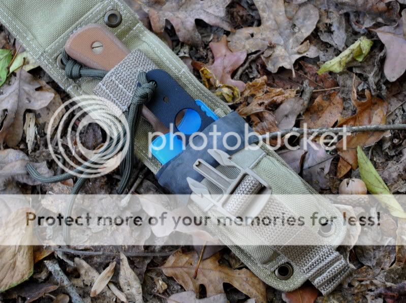

Purpose-built survival knives have always caught my attention for some years now. Nearly any time a new design comes along I check it out and if I can I pick one up. Many have been added to my collection of tools, and it is the one type of knife that I could be said to "collect". I saw the EX CST knife itself at Blade and it and the sheath caught my attention. Then when I read Len's write-up on it that caught my attention even more. They were on back-order for a while but I finally got one a few weeks back.

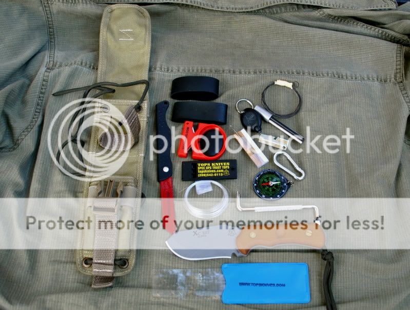

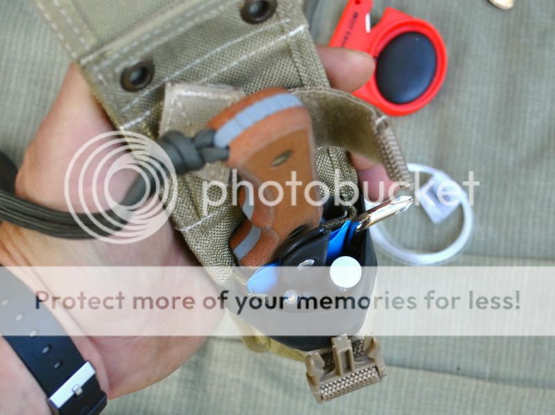

The acronym Xc EST stands for Cross Country Emergency Support Tool and it doesn't come as just a knife alone but rather as a knife and a few useful tools together in a sheath that makes up a handy survival tool kit. Because of this I only reviewed the knife and it's various systems in doing their individual jobs. In fire craft I tested ignitions only and didn't go for sustained fires every time. Doing one in-depth post on the knife would be impossible for me so there will also be other parts added over time or other threads done.

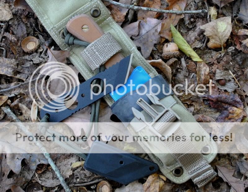

Supplied accessories (mostly copy/pasted from TOPS website)
Survival Saw
Lansky Sharpener
2 Ranger Bands
Compass
Fishing Line
2 Fishing Hooks
Offset Screwdriver
P-38
Snare Wire
L.E.D. Light
Sail Needle
Fire Starter
Razor Blade
Snap hook
2 Safety Pins
about 30 inches of paracord for a thigh strap
Spindle divot in handle

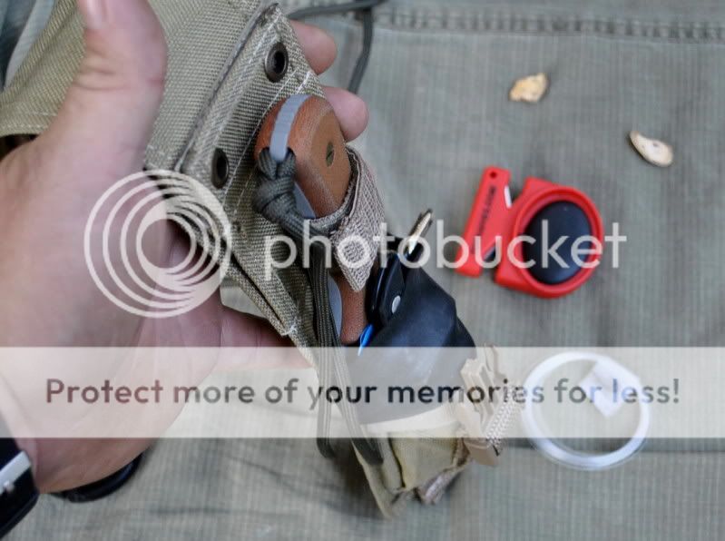

I use the ranger bands to secure the items in the pouch.
Part 1 of 6

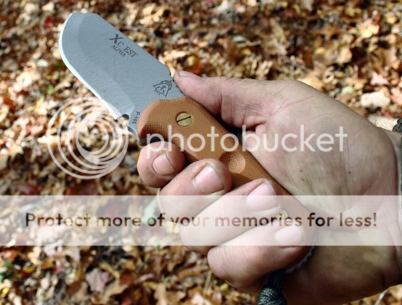

The knife has a full handle that is really comfortable, and I like that the handle scales are flush with the tang and not shadow-boxed.
It came with a great edge.
Part 2 of 6

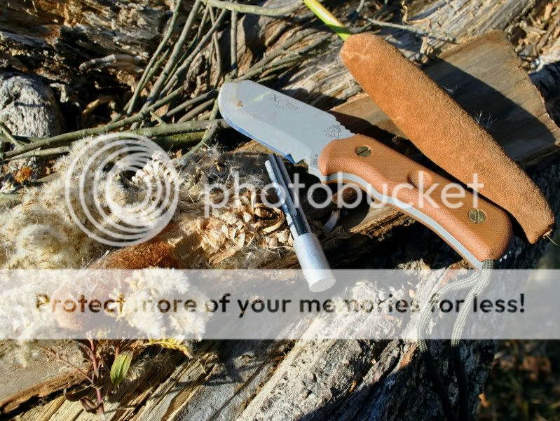

Considering how often the ability to make fire on demand is very important in a survival situation...water purification, cooking, cold weather, signaling to name some important ones... I am glad to see how well that aspect are tended to in this kit. The knife comes factory with multiple accessories to deal with making fire. The knife is heavily made for splitting wood and prying off pieces, and it even chops better than you might think.

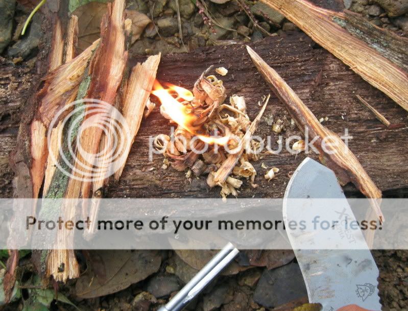

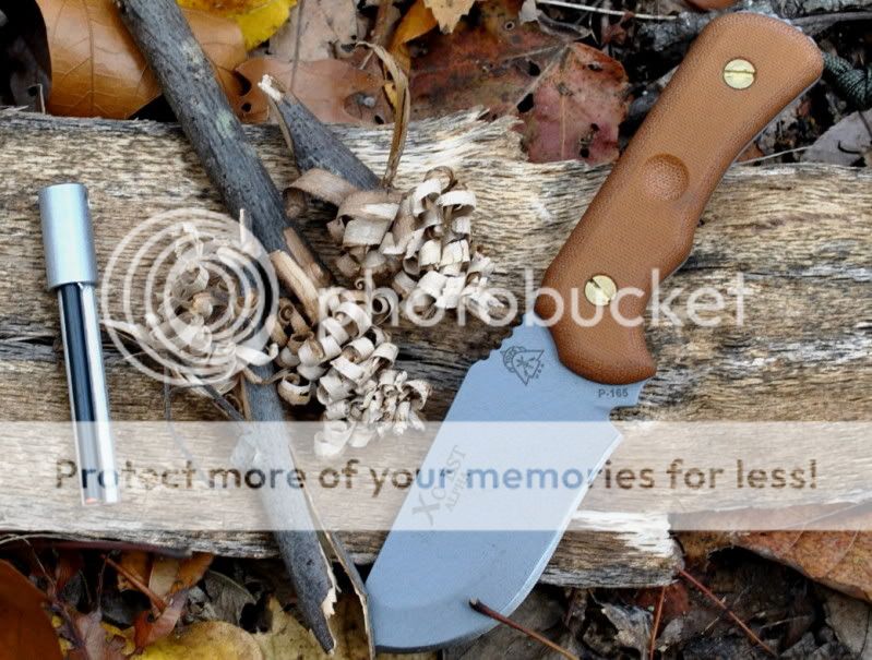

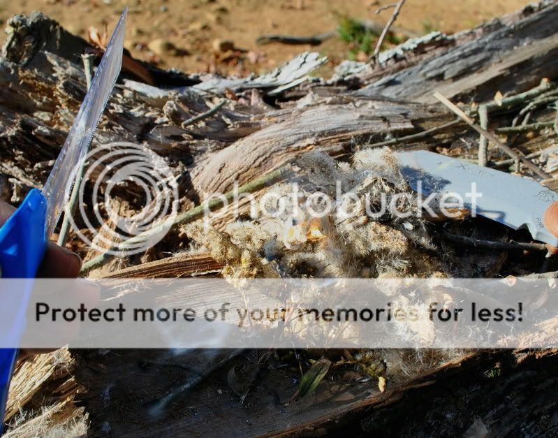

There is a magnesium fire starter in the pouch that consists of to magnesium rods and one ferro rod press-fit into an aluminum cap. Finding a small base for the magnesium shavings you can quickly create a tinder that will burn very hot for a few seconds.

The ferro rod will of course also work with natural tinders.
In this video I used the ferro rod and natural tinder under wet conditions.
[youtube]o59ji5OY_O4[/youtube]
The supplied magnifying strip also produces a good amount of heat, this was just using the early morning sun with tinders and leaves still damp from the frost. I imagine at high noon it will work even better.

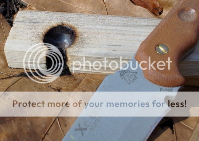

Last but not least there is the spindle divot that works really well. The sun was so bright and it was a little breezy so you have to look close to see the smoke in the last picture, but you can see it curling right in the notch.

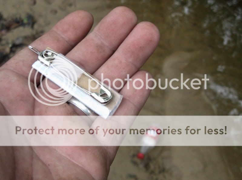

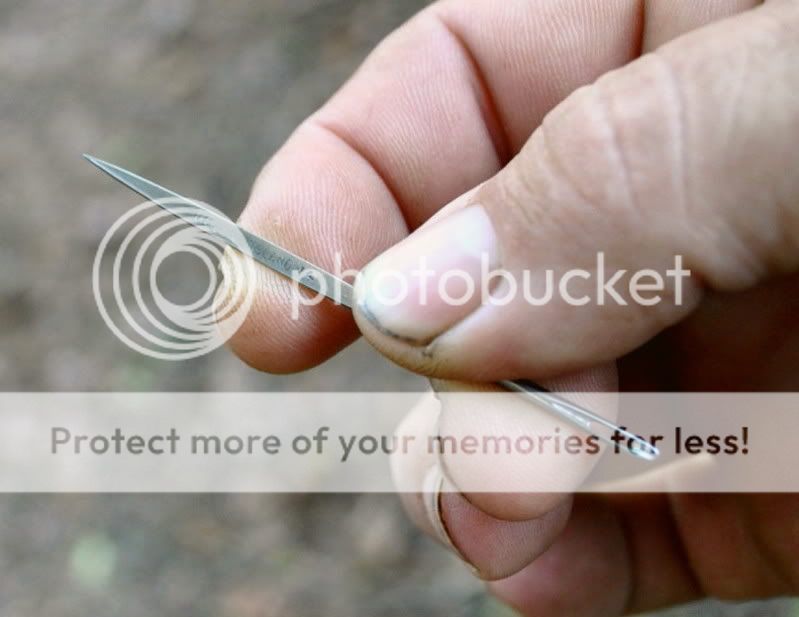

While historically I have gone for more pointy knife blade tips...and would still prefer one in an offensive/defensive role...I do understand the reasons behind this design and it offers accessories that do have points which will suit most of my survival needs. The supplied sail needle or safety pins will bore small holes for an improvised water filter.
Part 5 of 6
