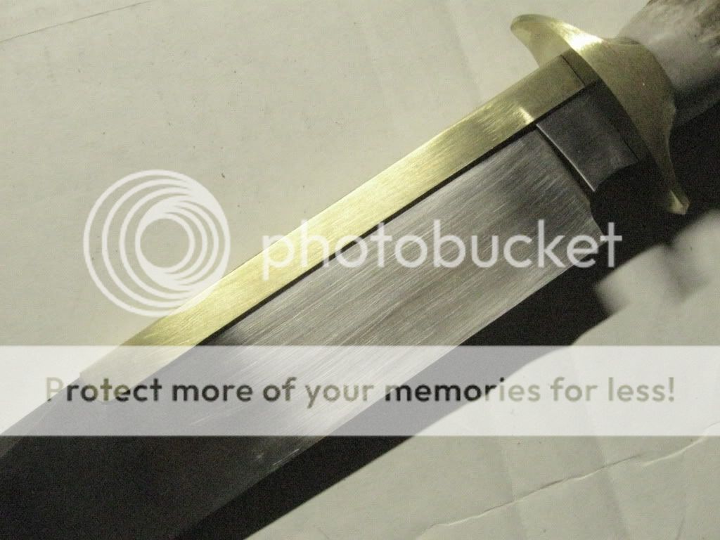

this is the current project,
And this is what i've been attempting it with, it does work good on smaller project's I should say.
I would recommend you get a decent sized propane tank and a large Oxygen tank. Propane and oxygen can do all the cutting and brazing temperatures you need. A good rosebud tip will really help heat things up to temp and won't create a hot spot likes using a cutting tip will. Also this works well for aluminum brazing and soldering. My personal set up is a 330cubic ft o2 tank and a 100# propane tank with a small victor torch look alike from china... With this setup and the right tips you could cut up to 2" steel. I chose to avoid acetylene because it's much more volatile and higher cost. If you go the CL route make sure the hose is multi fuel as propane can deteriorate some rubber on acetylene only hose...
Those look like respectable bottles for quick work. But that knife looks big, and has a ton of heat sinking material attached to it.
I have always had a question about where in the process of "building", makers solder their tangs. I haven't reached those heights myself yet, so the process I envision, is probably not the one being used by most people.
35% is usually used for larger capillary gaps. You might want to try 45% if your guard is a tight fit. I would ditch the heat paste, and either submerge most of the blade in a bucket of water using vice grips to hold the tang out above water, and or point the torch heat away from the blade around the guard. Solder runs off when it is dirty, and when it is too cold to melt and hold the solder. Heating just the part you are working on takes much longer than warming up the entire work area. and the upper side of the guard should be bright clean too.
It doesn't look too bad to me, I think you are holding the heat too far down the tang worried about the blade.
In this picture the gaurd is brazed and im attempting to braze the copper back.

Rock if I were doing this I would first make a solid bar that fit the spine and tin it with my silver brazing. Then clamp it in place and with a little more flux and heat to melt the brazing. start at one end and work to the other. Then fit the guard and soft solder it in place. I personally would use the brownells solder or the easy solder. brazing rod flo temp is too close to the melting temp of the copper or brass back and has the potential for problems.

I also want to point out that the "heat Shield" material you have on the blade will basically do nothing to protect the edge if you are silver brazing ( silver soldering) the brass on.
Those type of shielding gels and pastes are to keep a stray flame off the metal when doing hot work near something that will be damaged or colored by the heat. They won't stop heat from conducting through the metal to the edge and ruining the temper and hardening. If you have access to a hardness tester, do an experiment. Take a piece of 3/16" bar stock and harden/temper it. Test the hardness along the edge and see what it is. Now use that gel along the edge and braze on a brass spine. Test the edge hardness again. I bet it is much, much softer.
I would make the brass back a snug fit and use silver bearing solder ( low temp). That will not damage the edge any at all. The gel will be fine in that case.
If you are silver soldering with the low temperature solders, the enemy isn't to little heat...it is too much heat. Those torches you have are many times the amount of heat needed to get the brass and the spine up to about 400°F. A good heat gun will do that just fine.
Cleanliness of the joint is what is absolutely required whichever way you are attacking the brass back.

Here's an in progress shot of one I did a few years ago. I used stay-brite lo temp solder, with stay-clean flux and a propane plumbing type torch. I never got the blade over the existing temper temp. It went well, I trimmed the excess solder off with a small elliptical-point brass chisel. Brazing seems excessive for this, to me.
