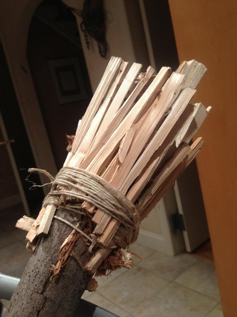

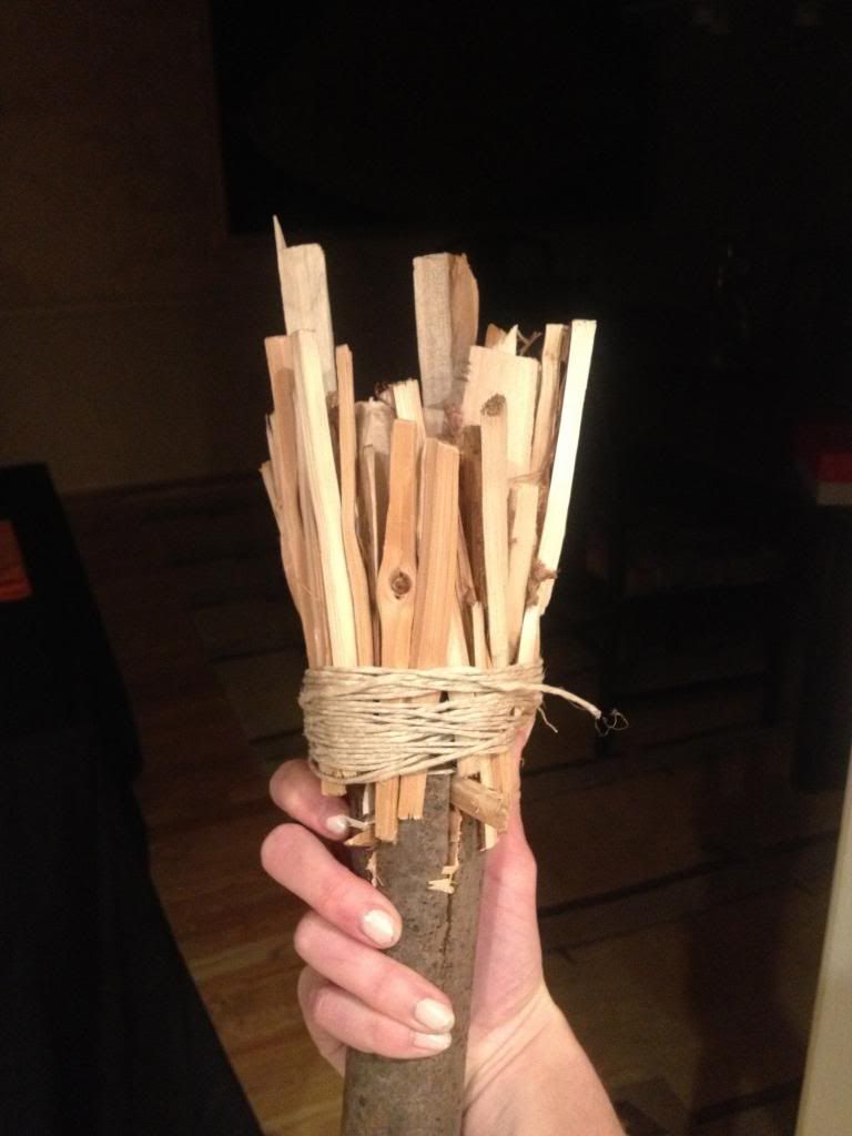

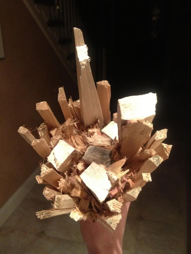

Here you can (kinda) see how I went about this, First: I split a Maple branch into four pieces, wedged them with pieces of Cedar, fluffed Cedar bark, and pieces of fat wood. Then, I made a sort of container around the top of the handle using small pieces of Cedar that I split up, and attached them using hemp fibre. Inside of there, the four or fiver larger pieces your can see are Oak - I put the Oak in there for a longer hotter burn - then stuffed it with more fluffed Cedar bark, and chunks of fat wood. **Special shout out to my hand model**

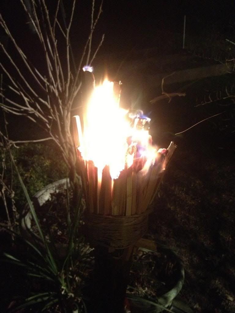

I made this thing earlier this afternoon and it took nearly all the self control I had to wait until it got darker to light'er'up
It burned just as I hoped it would, I was pretty happy with that.
