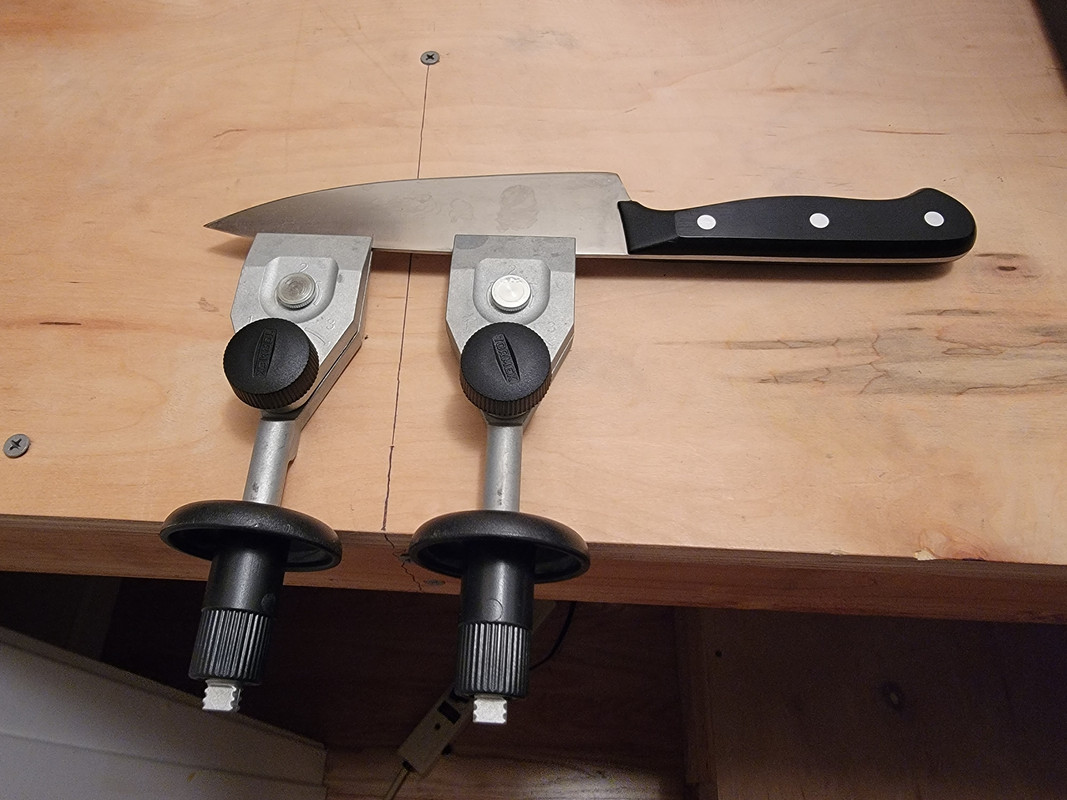

I'm just now seeing this thread, but I feel your pain. And viscerally. I bought the T8 with the Japanese water stone and bunch of jigs. I knew there would be learning curve, but I've still not been able to master this. It's far too easy to roll the knife left or right over the wheel and produce a wave in the edge. The problem is that I lack the motor skills for freehand sharpening, which is why I bought the Tormek in the first place. The only solution I've found is to clamp on a second knife jig. More than anything, I'm sure this just shows what a gooftard I am, but this is the only way I can keep a consistent edge bevel using the Tormek. Mostly I've switched to my Wicked Edge, which suits me much better. The Tormek sits in the corner, mostly unused.

That setup with two knife jigs doesn't look ideal. Maybe the following info will help you.
I started doing the tip part of a ~3.5" tanto blade (a knife I don't care about). Just need to keep it level and should be easy to do with that kind of knife - no turning or lifting required.

Thanks for the response. Let me elaborate further. Pocket knives are easy. It's longer, kitchen knives that cause a problem for me as there is more room for error. The second knife jig can only be compared to training wheels, but it keeps the knife flat against the stone along the entire length of the edge. I'm delighted that you've found a way forward, but for me the Tormek is best used for chisels and other tools. I can make it work for knives (two jigs), but I only do this with cheaper blades or edges that have been significantly damaged. For example, my sister asked me to sharpen her kitchen knife. The edge was more full of craters than the surface of the moon, so I put it on the tormek at a slightly obtuse angle and removed the damaged steel in seconds. After that it went into the WE and got a perfect edge in short order. For normal sharpening, I use the WE exclusively.
