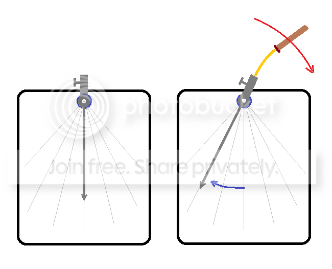

What I need is a method to measure "Prying Strength" or the force I can transfer from my tool into a prying application. Yes I know knives aren't for prying.... humor me. So what if my measuring device was the base/fixture of the testing aparatus? A sort of torque wrench in reverse. With this I could assign a "Pry'em Number" to any knife, no matter what size it is.
Very good engineering, Rick. The device would read the force applied at the tip with the handle being pulled. It could show what force is needed to bend the blade 90 degrees. As you said, it would read as repeatable value for a variety of knife geometries.
If you already have a torque wrench, you could just clamp it into the vise by the handle then cut a slot in a large socket and blammo, instant bendy meter :)

Gadgets like Rick mentioned are commercially available. We used them to calibrate our torque wrenches. They come in different sizes to fit different socket drives (1/2", 3/4", 1":eek:). Just bolt/fasten them to something SOLID, and insert your torque wrench drive. Pull to desired torque and see if the gauge reads the same on both wrench and calibrator. Check calibration every 6 months.
It wouldn't be too tuff for someone to make a blade holder that would fit the drive slot, then you could just slide your blade in and pull. Ours was for 1" drive torque wrenches and went to about 650 ft-lbs. For your own sake, try to find a smaller one.
