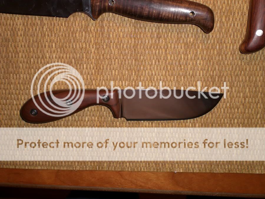

I feel kinda dumb asking this question, but how do you attach handle slabs using torx screws on a full tang knife? Do you thread the hole, and make the handle slabs the right thickness to be able to screw 1/2 the way through the tang on each side of the hole?
I have the screws, but havent found the best way to attach them.
I use the threaded pivot pins. The kind that most people use as a pivot for folding knives. Just drill the tang for the pin and cut it off if needed so it extends long enough to get 3 or 4 good threads from the left and right slab.
The Rats and Rangers I have taken apart to modify use a small brass bushing that's a little wider than the knife's tang. This bushing is tapped to receive the torx screws from both sides. The hole in the knife's tang is just big enough for this bushing to pass through.
The handle scales are both counterdrilled on the backside just enough to receive a small bit of the bushing on each side. This provides the clearance for them to fit up tight to the knife's tang.

Thanks, everyone. I think I will try the pivot pin idea. Sounds like it should work well.
I've looked around at the knifemaker supply houses I use and couldn't find the bushings though. I figured I'd have to make them if I ever decided to go that route. If anyone knows where to find them I'd love to know.
Hrmmm...what about 1911 grip screw bushings? Might only work for heftier blades, but they're already made for a similar task and the dimensions are so well known that tooling exists for them already.
-d
You can get cheap female threaded spacers from McMaster.com and use regular torx screws.
If you use screw size #6(if I am not mistaken) you drill 1/4" through hole and counterbore handles only from outside.
If you use pivots you have to counerbore handles from inside and outside.
