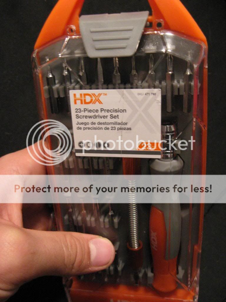

I've been thinking for awhile, why don't we ever see any threads recommending something that every knife owner should have? A torx set to tinker with/take apart his/her knife.

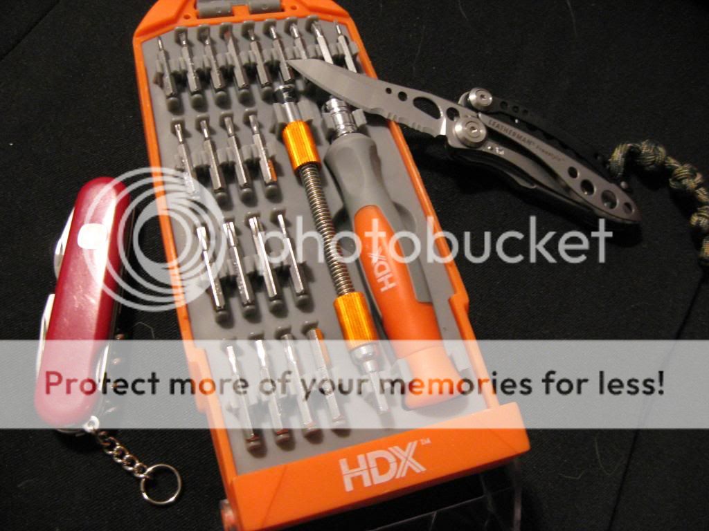

I know as a knife collector it has been an invaluable asset and extremely needed, I bought one years ago when I first started collecting, and finally about a month ago all the useful sizes got worn down and used up on my little Chinese one, I had been struggling to use what little material was left on the bits until I could buy a new set, but when I started looking I could not find anything.....maybe I just wasn't looking in the right places but I practically gave up hope finding one until yesterday, when I walked into Home Depot and found a lone precision set of Torx/etc bits, I had been there before asking if they had any and was disappointed to find out that they did not, and neither did Lowes, so you can imagine how excited I was to find a surprisingly good quality set for FIVE BUCKS :eek:
My question is, does anyone know if any torx sets actually exist out there? Or did I just miss every set that has been manufactured? And what brand do you use for your knives for future people looking for a decent torx set....
HDX (Home Depot) 23-Piece Precision Screwdriver Set:

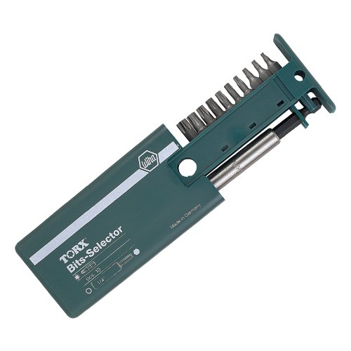

This is my fav, Wiha 79242:
TORX Set With 10 TORX Bits (Small Sizes)Includes: 10 bits, Molded Storage Box & Magnetic Bit holder. TORX Bits T5, T6, T7, T8, T9, T10, T15, T20, T25, T30. Bit Holder 1/4 magnetic Industrial Quality through hardened bits. Pocket Sized box with slide out drawer holds bits. Dimensions: L-4.25 in. H-2.0 in. D-.75 in. Keeps bits organized.All Sets Include 1/4 Magnetic bit holder for power tool use. Guaranteed Quality Bits - Made In Germany.

I'm really content with my $5 Husky set from HomeDepot. Lifetime replacement warranty too.

Beware of the HDX Driver set... its no bueno. I made the mistake of grabbing one a month or so ago, the drivers are kinda on the soft side and deformed when I was working on my 0561... which is now going back to KAI's warranty dept. sometime this week:( I would not recommend it, will be getting either a Husky or the small Wiha set in the immediate future.
