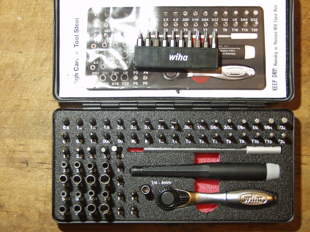

I don't think Wiha has any bits besides 1/4" or 4mm and that should be the right adapter to convert from the 1/4" on that handle to allow the use of the 4mm bits.
Thanks - that's what I though. Just didn't want to order something I couldn't use.
At least I have an old variety set of 1/4" bits that I can use the handle with too. Just frustrating to me that I didn't notice the different size between the torx bits and the handle...

Yep need that adapter for the 5/32 bits(some call them 4mm.) I measured them and they are 5/32 (.156). 4mm equals .160 that is the female part of the adapter the male side is .155 or 5/32. Whatever you desire to call the adapter, I always like to have 2 of an important piece in case it snaps or gets lost.
