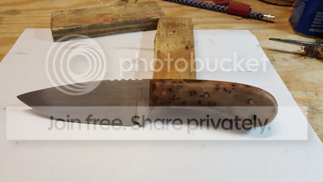

I have learned a ton on this first one! There are some blemishes that I’m definitely not happy about! I got a little excited at the end when filing the bevel and put too much pressure on the file, thus cutting higher up the blade than I should have. Another issue is with my 12” bastard file. I rounded the corners over on a horizontal table belt sander but I don’t think I did it enough! My plunges are not visually appealing at all!!! Overall, I’m happy with the way it turned out with some exceptions. I really look forward to the next one!!!!

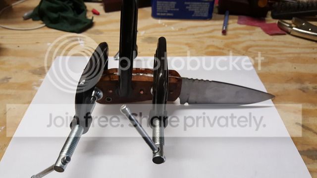

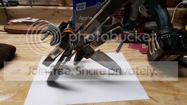

think I need more clamps....
A very respectable first knife. Congrats on rounding the handle. Most first knives look like they left the scales completely flat.
Don't beat yourself up too much about the plunges, they are not that bad.

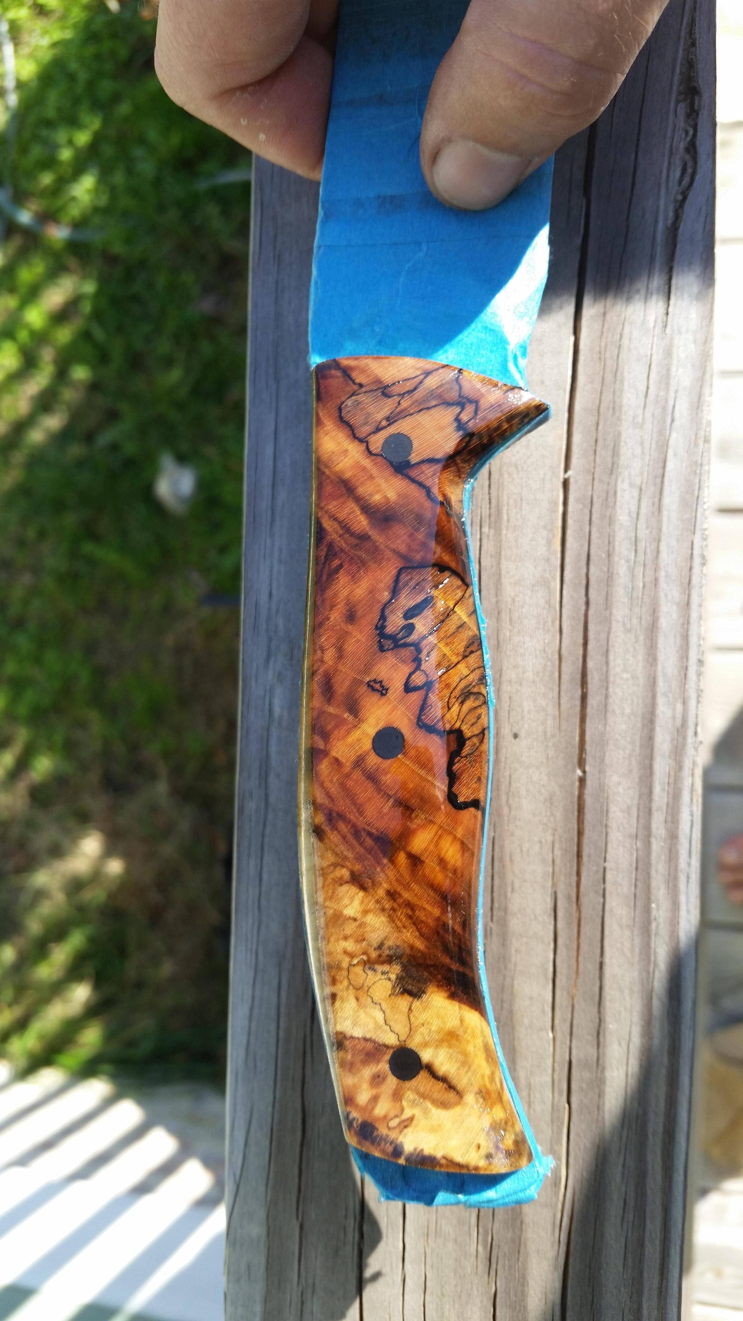

Those pins are wallowed out. I am guilty of the same thing, but that's because I don't have the right drill bits or I try to rush.
Try using the numbered drill bits that correspond to the pins. The holes need to be a little larger than the pins, as said before. If they're the same size, then grind the pins down a little at a time. It causes more hand fitting but if that's all you have then that's all you can do.
The pin diameter at the tang is a little less important than the diameter of the pin that shows at the handle. If you're peening the pins then it's a little less important but still an important consideration. Those holes are too big to peen.
The pin hole closest to the blade looks good but maybe you didn't use a firm backing when you drilled through it. Next time maybe drill from the presentation side to the hidden side so that little broken off chunk won't be visible.

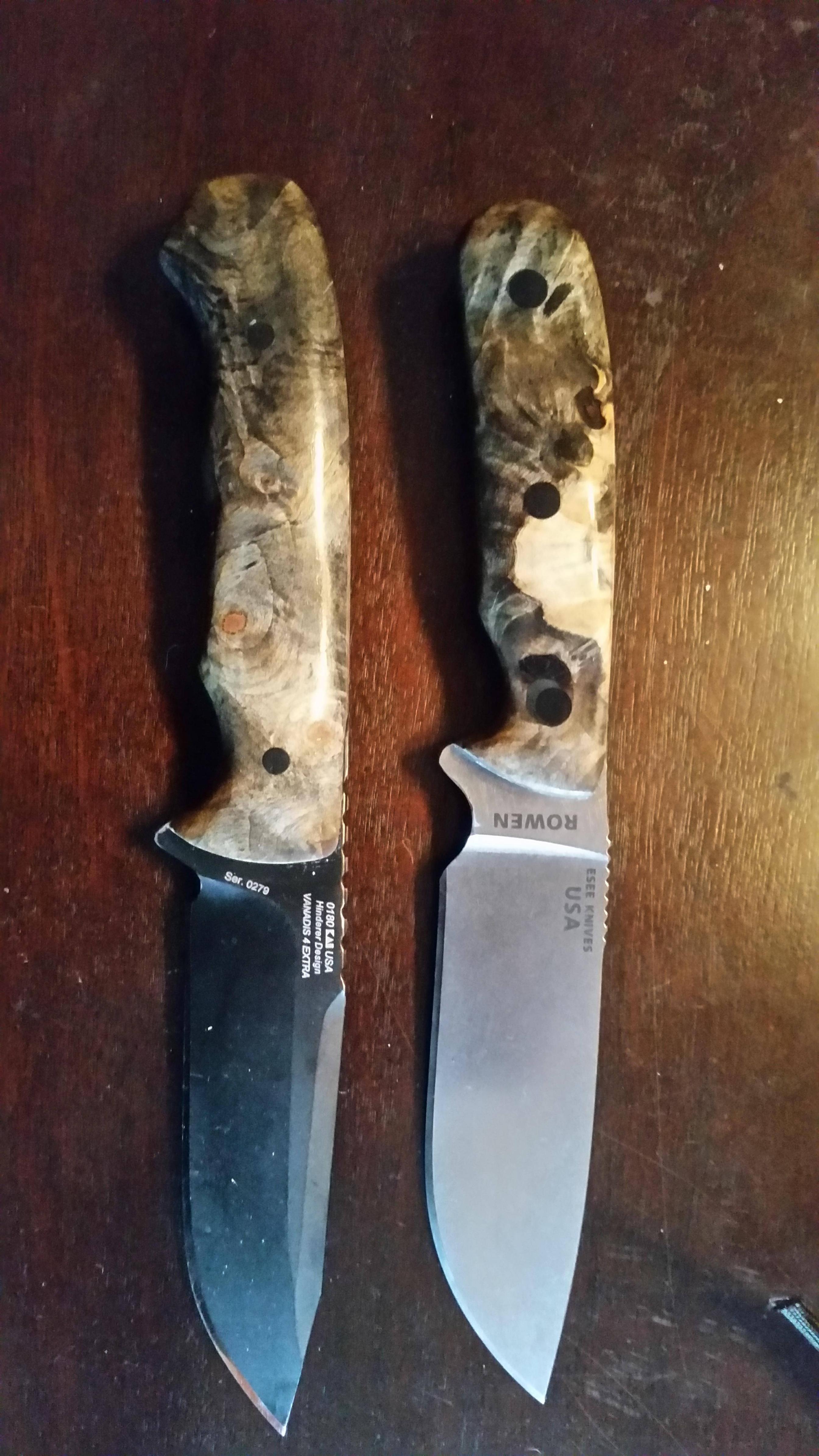

Here's one of mine where I had the same problem. The hole wasn't the same as the other two. Check out the front pin hole:
Compared to this one where I just took my time and wallowed out the holes the way they should have been done:
