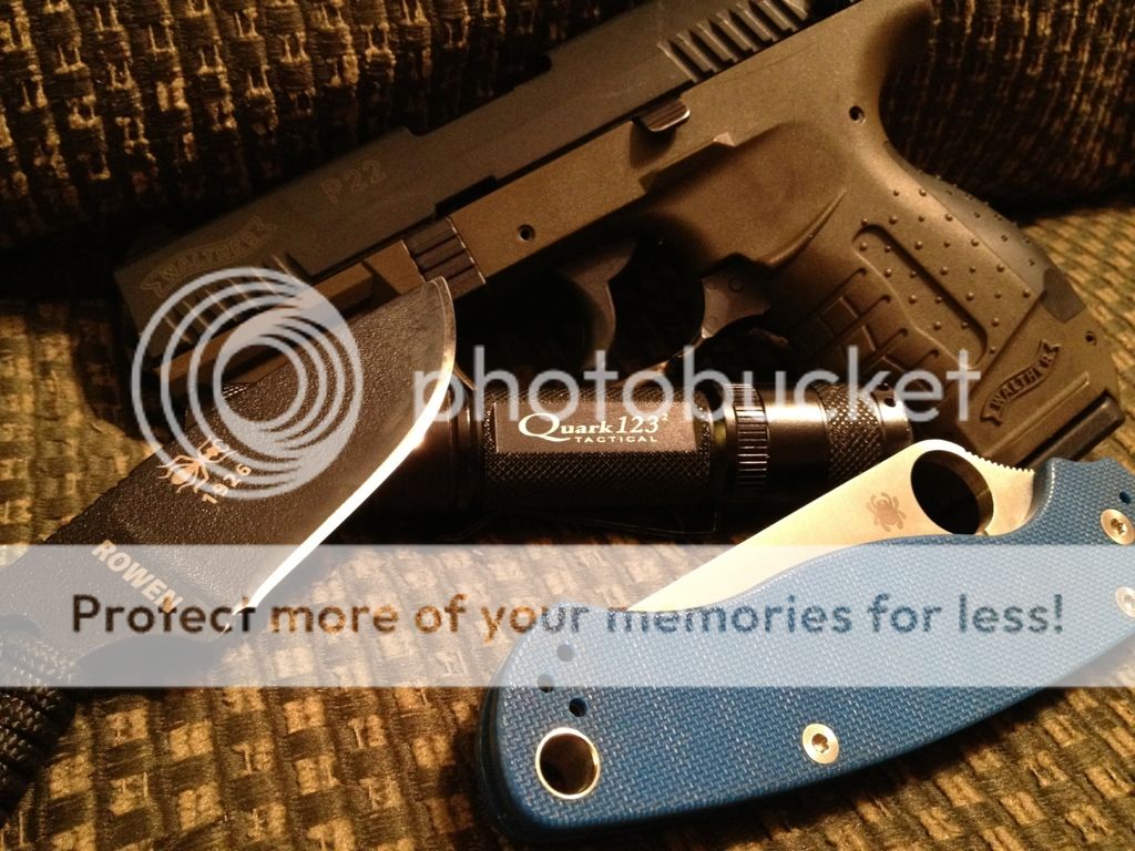

I convexed the whole edge on my Izula. Seriously it cuts so much better now. All around really, keeps an edge longer too. It made this knife a must carry for me and I haven't stopped carrying it since. Here's a picture, hope you can tell.

I'm saying to not go so low, keep the angle a little higher on softer steels. If a steel is really hard you can make the cutting bevel very thin, if not, or the blade is very thick then changing geometry such as convexing the edge is often the solution. It thins the metal behind the apex while keeping the apex angle more obtuse.
