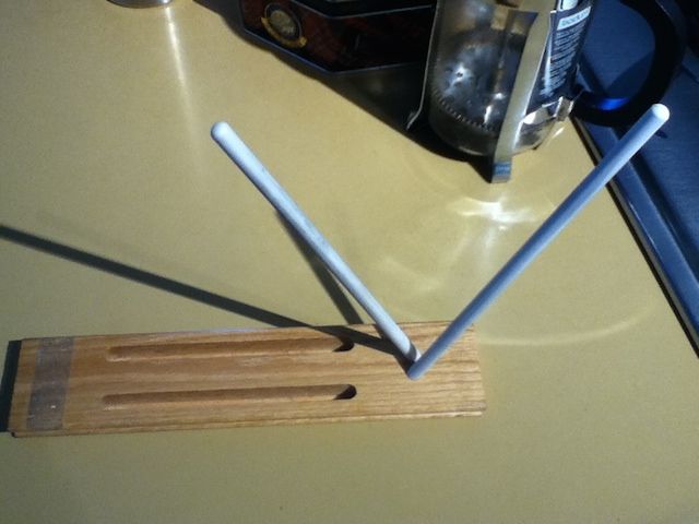

What about a "Lansky Turn Box"... Lansky's low cost version of a Sharpmaker.
Or, just get a decent ceramic rod (I like Idahone)... pretty easy to learn to use one for touch ups. (Just avoid the cheap ones... IME, they can be a bit rough).

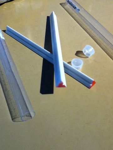

I have two recommendations besides the unspoken environmentally conscious one above:
  • sharpen your Swiss Army knives to have shallow bevels . . . they will stay sharp much, much, much . . . much longer.
and finally to answer your question . . . yes we are finally arriving at that moment . . . I hope you are as excited as I am . . .
  • Get one of these (the Spyderco Ultra Fine ceramic triangle rod) they can be had for between $11 and $18 if you watch for good prices.
I finally bought a second one. I carry one with me out into the world and have one safe at home. and if I ever get a Sharpmaker which certainly could happen, I will have these to use in it.
Seriously, once you have a really good bevel / sharpening job on your knife this rod will get you back to hair whittling, if you started out there from your guided system, unless you do some damage to the edge. And just recently I hit a staple with M4 and was able to get the corner of the rod into the bad spot and get that sharp again. Forget about taking a dull edge and bringing it back though. This stone will be best for an edge that is fairly sharp but stopped shaving, or an edge that is pretty much shave sharp and get it hair whittling again.
The advantage FOR ME over stropping is that it can realign an edge that is a bit rolled and wavy or some such and the strop is just too soft to do that sort of thing. I never strop unless you consider sharpening on a 12,000 Shapton stone stropping which I do. That is what I like.

I use ceramic for touch ups. Spyderco ceramic is great, but I'm sure you'd be fine just getting a ceramic rod from virtually anywhere, and a rod is cheaper than a full bench stone.
Ceramic rods roll the edge even with feather touch, they just don't seem to cut. My least preferred sharpening/touchup tool.
I agree with someone else here who said to be careful which rod you buy.
I can tell you these are awful. I was never able to produce any where close to a decent / remotely sharp edge with them. Singly or used as a a pair in this holder. The rods have imprecise ridges and imperfections and the Spyderco Ultra fines that I have are very consistently finished. Perhaps the surface finish is better at abrading as well.
In any case the Spydercos WORK and the round rods shown here are useless.
Another thing to know about the Spydercos for touch up is less is more. I use very light fairly short strokes and the edge is repaired. I don't have to use the full length and saw away at the edge. Just a little here a little there; where ever the edge is loosing its sharpness and we are done.
The suggestion of using a diamond plate and a strop is no doubt very effective but be aware your blade material could start to disappear at an alarming rate if you make this your daily touch up. Be sure to go really light.
Probably getting too steep an angle. Also the flat of the Spydercos are there for this reason / spreads the force across the edge so doesn't "coin" the edge as much.
I use a jeweler's visor with fairly high magnification, get bright light and my point of view so I can see when I am just coming off the flat of the sharpening bevel onto the edge. I watch for "burr" rolling of the edge like a hawk and stop and switch sides if / when I start to see it (if you can feel it with your finger you have gone too far).
These ultra fine rods are not for everyone but they sure save metal and are the cheapest most effective touch up I have found. I stropped with yellow abrasive for years and years and years . . . daily at work for our knives. Fairly easy for everyone to learn.

Well, then, Spyderco ceramics. Sorry to hear the cheaper brands aren't good, but I guess it shouldn't be a surprise.
Interestingly, the sharpmaker medium ceramic rods are the least flat of the ceramics I've purchased from Spyderco: both my double stuff and 8" benchstones are better finished without ridges or edges.
I have heard, inadvertently, of problems with the other rods. As I said I don't have the set. I just decided to give the Ultra Fines a try and got lucky I guess. They seem very nicely made.

I did that, but definitely not as light as you said. I'm not good with my hands - might as well say that I have 10 small anvils on my fingertips. ;)
I'm putting more details here in case another n00b reads this later.
Basically - I closed one eye, aligned the blade edge up. Using the 1000 grit ceramic hone, I moved up and along the blade (edge trailing motion) to unroll the edge at around 20 degrees (aka whatever angle felt right - did I mention I suck at guesstimating angles too?). There was some 'catching'. I alternated sides until it was sliding smoothly. Then I moved down and along the blade (edge leading motion) at a slightly higher angle. There was a little bit of catching, but not much, and more resistance. I guess that means that I was abrading some metal away
Afterwards, I was able to slice cut loosely hanging phonebook paper, and to push-cut it with the grain (but not across the grain). That's a huuuuuge improvement. And I saved myself 20-30 minutes of sharpening.
