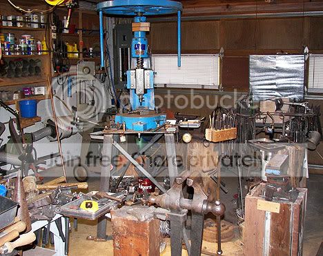

Gene, what is a fly press? I looked at the pdf file and couldn't make anything out that looked like a press.
Here is a image of mine.
Mine is a Kayne @ Son press, a P-6
The wheel is wound up for about a 1/4 turn then quickly wound down, the energy built up in the wheel goes in the goes in the piece being forged, nice thing it's almost dead quiet.
