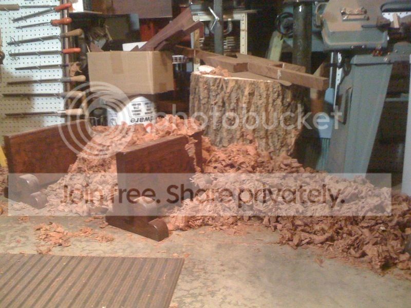

Ok, ok . . . seriously though. All of these are A2. I bought them to use specifically on Bubinga which is right up there with some of the hardest most contancourous to plane hardwood. I have never, ever chipped any of these blades with this wood or other similarly hard projects. A2 is brilliant for this application; mostly because it can stand up to the mineral deposits in these woods as well as about anything and better than most.
Bags and bags of shavings and no problems.
HOWEVER
While using this chisel, made from "Blue Paper Steel". Doesn't get better than that. This is a five hundred dollar woodworking chisel from Japan.
While cutting these very large dovetails in a super hard wood. I experienced what appeared to be chipping in the the edge of that very hard (but tough) world class chisel. What it turned out to be was ROLLING of the edge here and there along the edge. I widened the angle of the bevel just a few degrees with a micro bevel and the whole problem disappeared and I was able to complete the joinery no problem.
So I would encourage you to experiment with grind angle and avoid hitting any small knots until you get the angle dialed in.

Good advice and beautiful work. Thanks for the pics.
