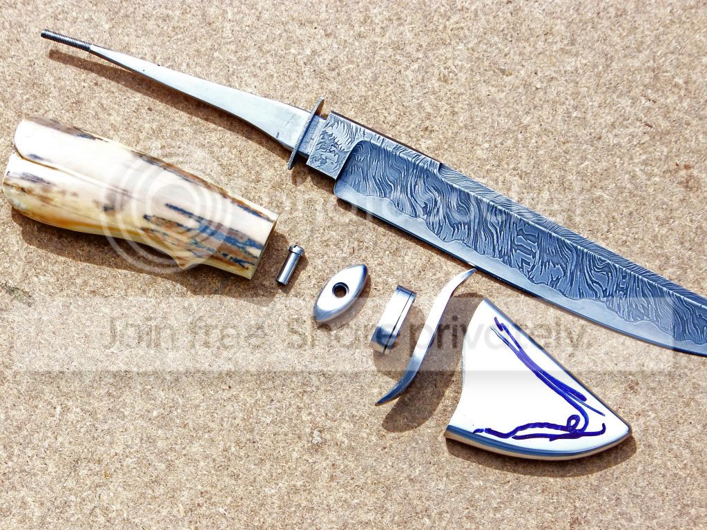

I almost always draw out the tang, grind it to size and thread it. I like corby bolts and counter-bore the pommel plate.

Bruce, I don't suppose you've got any pictures around of your process? I think I understand what you mean, but I've been wrong before:D Do you just use the female side of the Corby bolt?

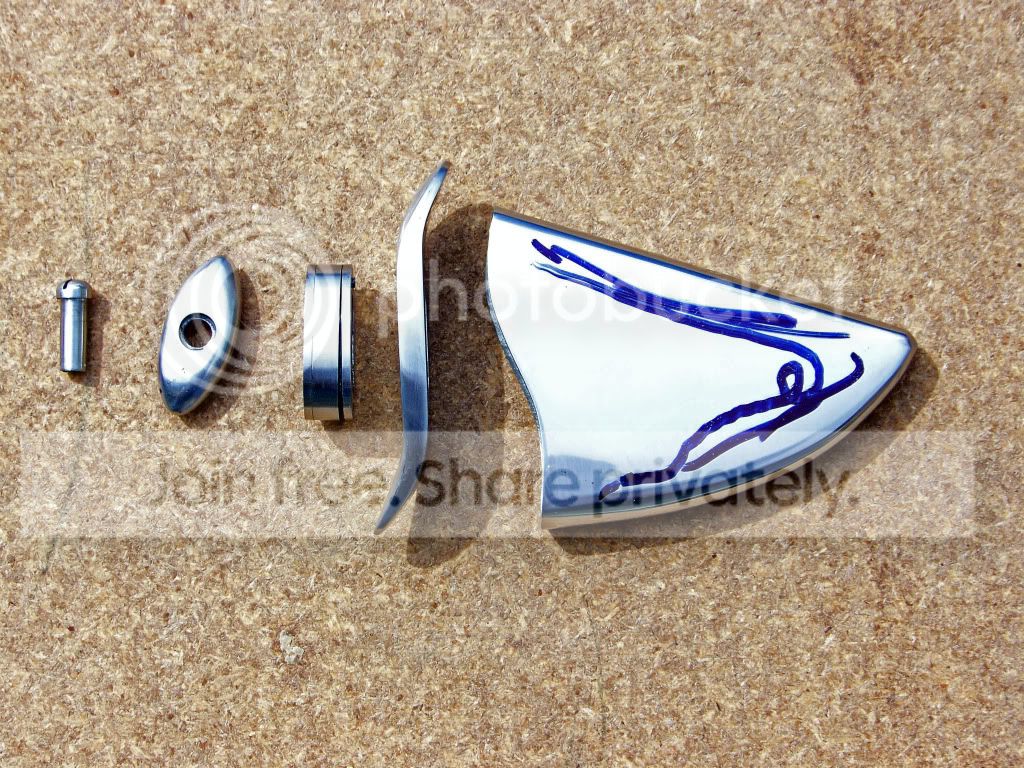

Yes I just use the female part of the bolt. Here is a couple pictures I took for engraving purposes but it shows what you need to know. BTW this is a "take down" knife but I use the same method on all Through tangs if I use a butt cap.
Thanks, Bruce:thumbup: That's pretty much what I was envisioning, though what I had in mind wasn't quite that nice;) I do appreciate the pics, and that's one heck of a nice knife, too!
