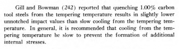

Ah, also of interest is this:
This is essentially what I was taught in tool and die. It wasn't until I got into knifemaking that I ever heard of quenching after the temper. I've probably had it explained to me before, but is this something to do with RA? More when slow cooled vs water quenched?

I don't think water quenches after low temperature tempering have ever been recommended.
Interesting. Ive been water cooling between tempers as recommended via this forum. With those low of temps and thin cross section it wouldnt have as much as an effect
Same here. Been water quenching between tempers. Always had, even in the beginning, because I didn't think there was any sort of metallurgical change that could happen once the blade had cooled down to room temp (or below with tool steels/cryo) and then was tempered. But I'm always learning, and may modify my practice after reading Larrin's post, which suggests there is "internal stress" that creeps up on you when quenching from ~300-450f tempering temps. But, it also said "slightly lower" unnotched values. I wonder how slight, and how important that really is to what I am trying to achieve with the kind of blades I usually make (high hardness hunters and kitchen knives).
