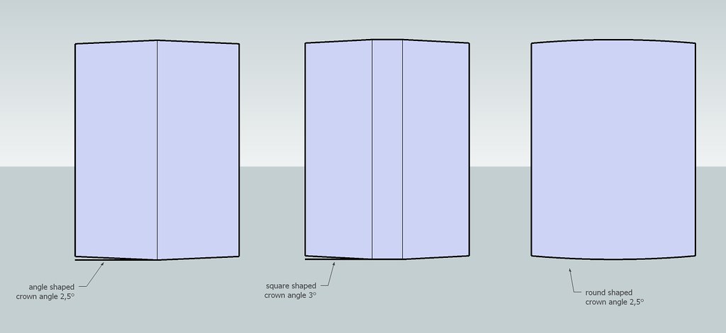

I'm trying to make my own tracking wheel for my KMG clone. now, my question is about how to crown it. I thought about three kind of shapes (please take a look at the pic).
I presume the angle and square shapes would stress more the belt... so my choise would be the round shape.
in your view, which is the best shape for our purposes? and do you agree on the angles I would use?
I've made a few tracking wheels over the last ten years. All of these designs will work great. I've used them all and have not noticed any performance differences in them. The left and center wheels are easy to do on a manual lathe with the compound... I do the right wheels on a CNC.
This is a very simple concept..and belt grinders are pretty simple machines. It's hard to do anything wrong..so pick one that suits your fancy and have fun with your project.

Thank you Rob for your precious suggestions! probably this sunday or the next I'll try to work on it. I'm gonna use 2° angle shape and I'll post the result.

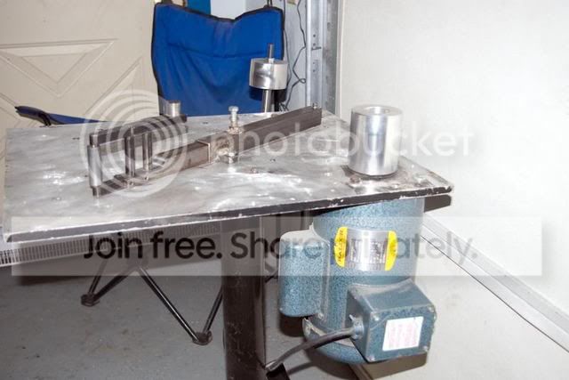

I made a tracking wheel for my horizontal 2 x 72 grinder as per the first example. Works great. I polished it on the lathe to about 320 grit , broke the sharp junction between the two flats. No noticeable belt wear.
You can see the tracking wheel on the left side, this was taken as I was building the grinder
Ken

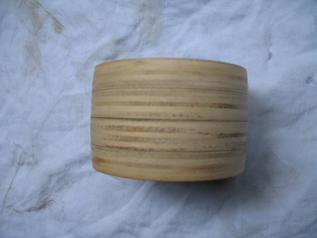

here it is the result. seems good to me but I'll know if it works fine only at the run test (don't know when...) :confused:
My Grizzly is shaped like the leftmost shape. I'd rather have a total ark, or the one in the middle.

That wheel looks great, did you laminate it yourself?

I glued four sheets of plywood and I worked them on my drillpress. the result is quite good but not perfect. a real lathe would be much better. but I don't have one. :grumpy:
