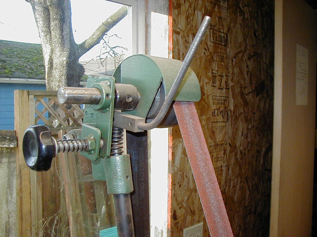

I wasn't sure about the little spring but figured it wouldn't hurt
I think you will need a spring on the bolt that leads to the tracking knob. It keeps tension on the bolt. Here's what I mean:
Great looking grinder. We should talk! I've been debating building one or having one partially built.
The spring comes in handy when you are running a slack belt. May only be because they have a weird tracking system on the bader 2 in which the actual attachment pivots. The tracking knob begins to move on me from the combination of vibration and light tension on the belt. I'm fairly certain it's because that 25 year old spring isn't up to par anymore. Been too lazy to look for a replacement because I rarely run a slack belt.
