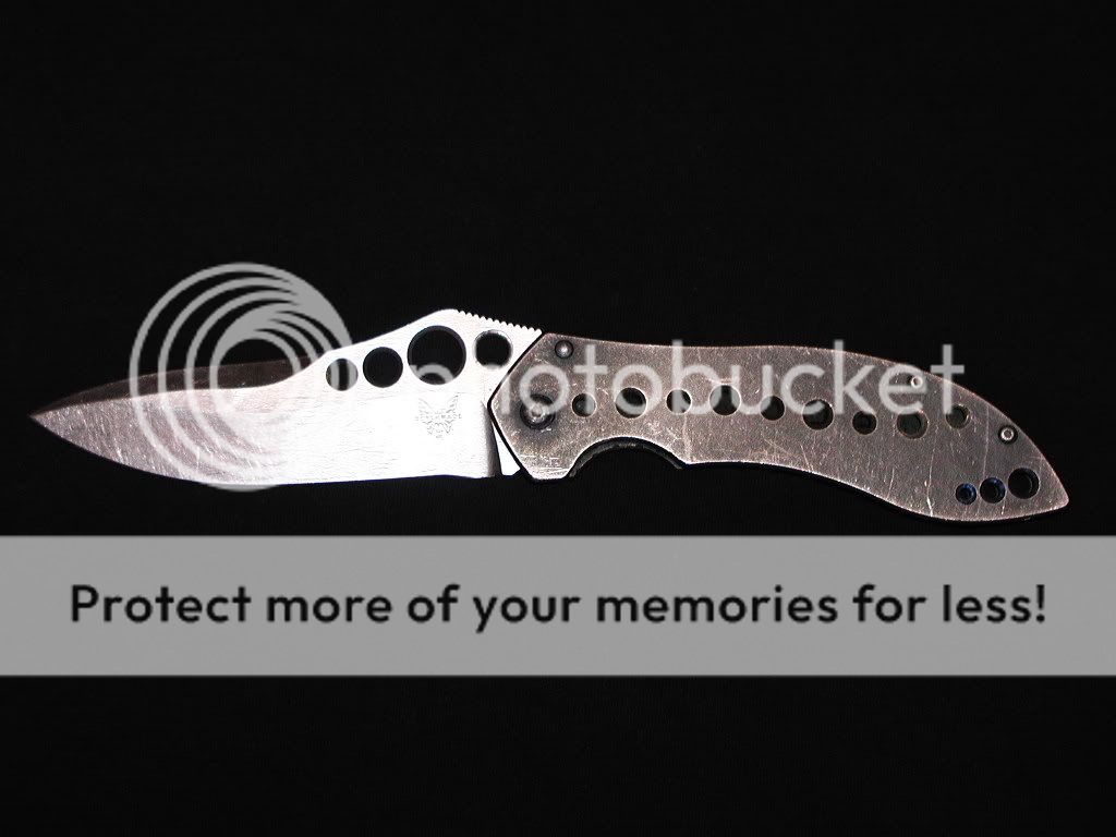

lewdog/allankidd,
you want colourless handles? That's easily done with the skirmish.
Disassemble the knife and throw the _anodized_ titanium handles in hot water and add a few spoons of Oxy-Clean. Stir well and wait an hour or so.
Voila, now you have some dark grey titanium handles. No need to have any worries, Oxy-Clean won't harm the titanium but will eat right through the anodizing.

I've heard about this trick, but was worried that the oxy-clean might just be putting a layer of junk on top of the handle that made it look better or something. You're saying it actually completely removes the anodization and literally doesn't harm the titanium at all?

Aye. OxiClean actually dissolves the anodization .. completely. It's a simple chemical reaction. You can test it first with any other piece of anodized metal (MAG-Lite, coloured keys, etc.).

Here's the thing that worries me: I spent quite a bit of time obsessively searching and reading threads about the oxiclean technique over the last few days. It was mentioned that one just has to scotch-brite or sandpaper the handle if they don't like what the oxiclean did to their knife. To me, that implies that it is only a surface effect, a thin coat of something that would wear off over time, revealing the original anodization underneath. Am I misunderstanding something? I guess I'm being super anal because this is a lot of money for me and I really want it to be perfect...

OxiClean destroys the anodizing. It's not there anymore after the treatment.
What's confusing you is this: raw titanium quickly forms an oxide layer when it comes into contact with oxygen, just like aluminium and many other metals. Since OxiClean is such a potent oxidizing agent it forms a rather dark and even layer of oxide on the handles.
The titanium would oxidize anyway but it would probably look alot more unevenly "coloured". Over time, the oxide layer may become rubbed off or scratched just like any other coating but you could repeat the OxiClean treatment indefinitely. Just make sure the handles are perfectly clean before you throw them into the bath (that means no touching with your bare fingers either).

Very, very interesting. If I were to torch the handles after I oxiclean them, would that be a permanent finish or would that rub off like the oxidation? I really like the torched look...
