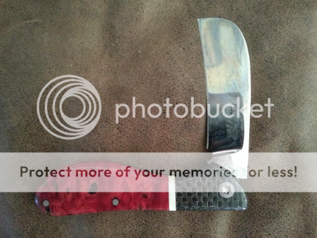

This is a custom from South Africa but I think it's traditional, a biltong knife by JD Ellis:

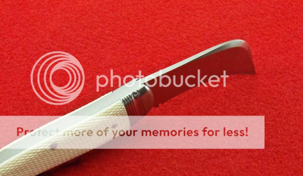

A few pictures of a Farmer's Jack with chisel ground hawkbill and budding blade. These pictures show the flat or un-beveled side.
