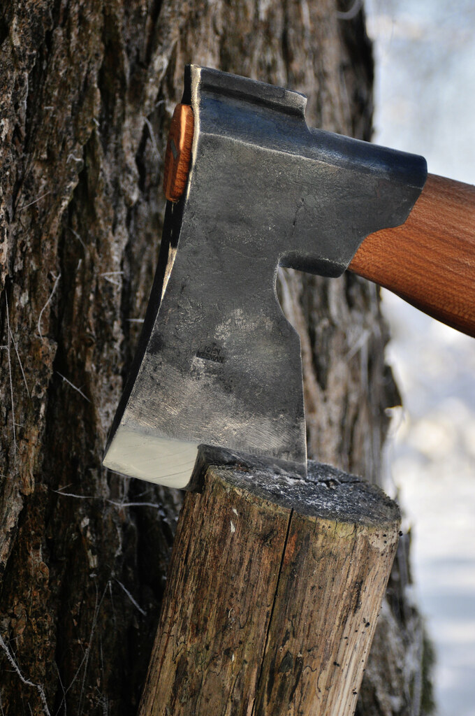

Traditional Finnish Style Forest Axe
Dec 5, 2011
21
Traditional Finnish Forest Axe.
Made by old Finnish drawing.
Hand forged (by hand hammers).
Laminated steel. W108 carbon tool steel for the blade. Rockwell 58 (HRC). Axe head length 6 inches.
Blade width 4 inches. Turpentine, linseed oil and bees wax treatment for the head.
Elm handle - 23 1/2 inches.
Handle is hand shaped, linseed oiled and bees waxed.
Hand made leather blade guard.

very nice, excellant photography. Can you give your opinion on the orientation of the grain in the handle? Obviously a hand made piece- counter to the traditional selection of grain orientation.

That axe handle clearly has a problem with handle grain orientation.
As is it is plain wrong and should be perpendicular to that.
I noticed this on your previous axes, but it is much more a problem on this design as I can easily see the handle break.grain.jpg

Yes. I agree with that, but the particular one was not made for hard working, but as a collectable.
I noticed this on your previous axes, but it is much more a problem on this design as I can easily see the handle break.View attachment 256824

like the other guys said the wood grain is horizontal, from my experience the wood will fail .
the forging work is pretty amazing
