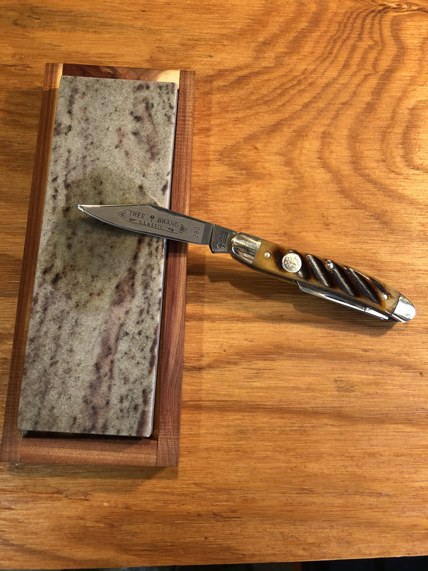

This is a Browning two sided stone that I have owned since the late 70’s. Bought it when I bought a Browning lock-back knife (one of their takes on the Buck Folding Hunter). The knife is long gone, but the stone gets used regularly. OH
Wow, that’s a beautiful stone. Nothing quite like a good familiar stone to keen up an edge.
I have quite a few of these stones. Most that are patterned like this are Washita variety of Arkansas stones. Very nice!
