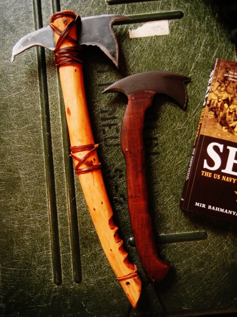

Pretty sure, Edwood7 made one like your talking about, but I've never seen another Sayoc that wasn't full-tang.
Well, if you consider making the original one from the Kalinga Igorot version, it does look like a non full tang.
Those head hunter axes are just brutal looking.
I think the amazing thing about the Winkler-Sayoc is the location of the weight. The top grip position and the head is 3/8" thick, and that's where the mass is. The thing only weights 24oz, but most of that weight is in the sweet spot. My Ranger Renegade is much heavier, and my other full tang hawks are clumsy compared to the Winkler.
If you were to have that head on a wooden haft, are you thinking of an eye, or one like Edwood's? Do you just want the look, profile, of the Sayoc hawk? Lots of traditional hawks could be modified, take a few grinds out of the toe area, to make a front spike, and narrow down the rear spike. Yes, it would be lots of hard grinding on a tempered hawk head.
