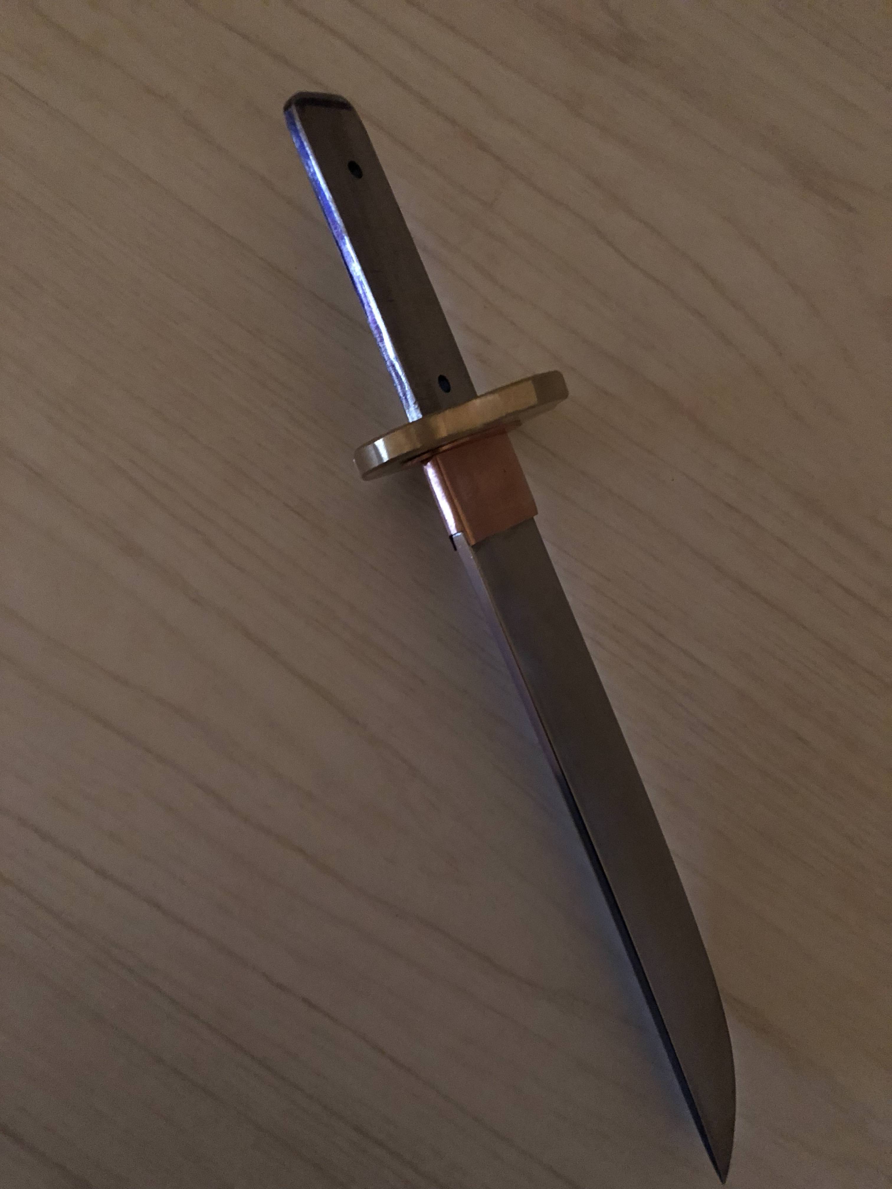

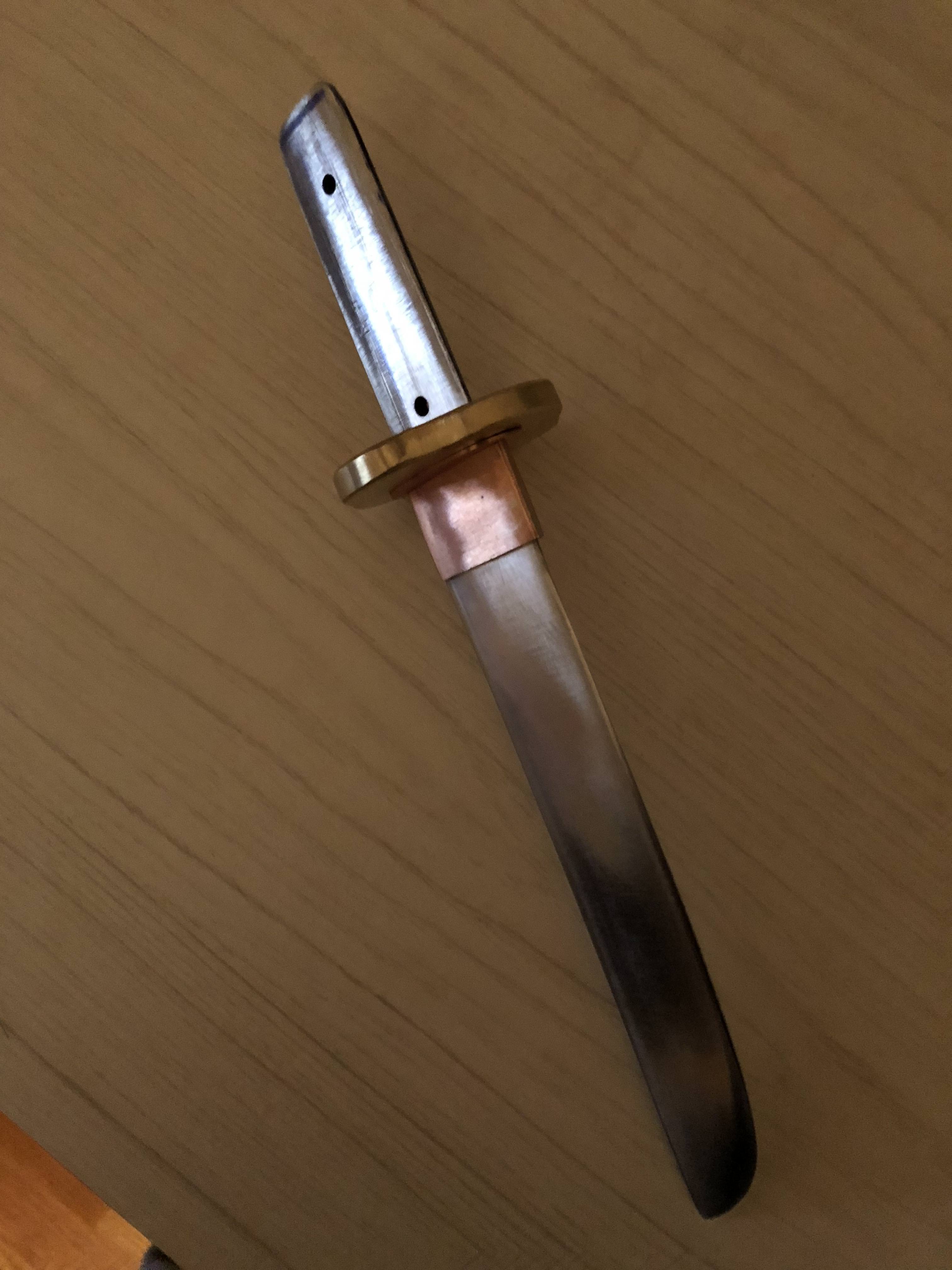

Alrighty. Well I finished the blade (I’m not quite done with polishing and etching, I will probably work on it a little more). The W2 hardened well enough it seems, using my Rockwell files on it. The tip and the bottom of the edge seem to have hardened slightly less, but they are still hard. I was a little too safe when trying not to overheat the tip. The blade was thick still and it didn’t heat up super quickly. It did warp in the water (3 second water with some dish soap, heated, then immediately into canola oil), but I fixed it after the first temper cycle using a vice and slight heat from a small torch. I should’ve prepared for this ahead of time so I could get the clay off and straighten before it got down to ~200 or whatever, but it worked.
Unfortunately I made it too short obviously, for a tanto, which seem to be noticeably longer blades usually. However I didn’t want to use a ton of my W2 on my first try. The grind came out pretty well. After hand sanding you can’t see the grind line too much, but I managed to get a pretty nice symmetric convex grind, with a taper to the point (not a perfectly even one, but good enough). I’m not looking forward to making this handle, but I’m going to give it a try.
Looks good. I used silicon bronze for a habaki. Easy to work with, just annealed it a couple times along the way. I liked that it matched the bronze brazing rod I used to join it (no visible joint).
I darkened it with cold blue to a color I'm happy with...
I use livers of sulfur to blacken copper. Soak for an hour, rinse and clean with a toothbrush, soak again, repeat. After a few hours it will form a rich silver-black patina that is permanent. It looks like ancient Japanese silver fittings.

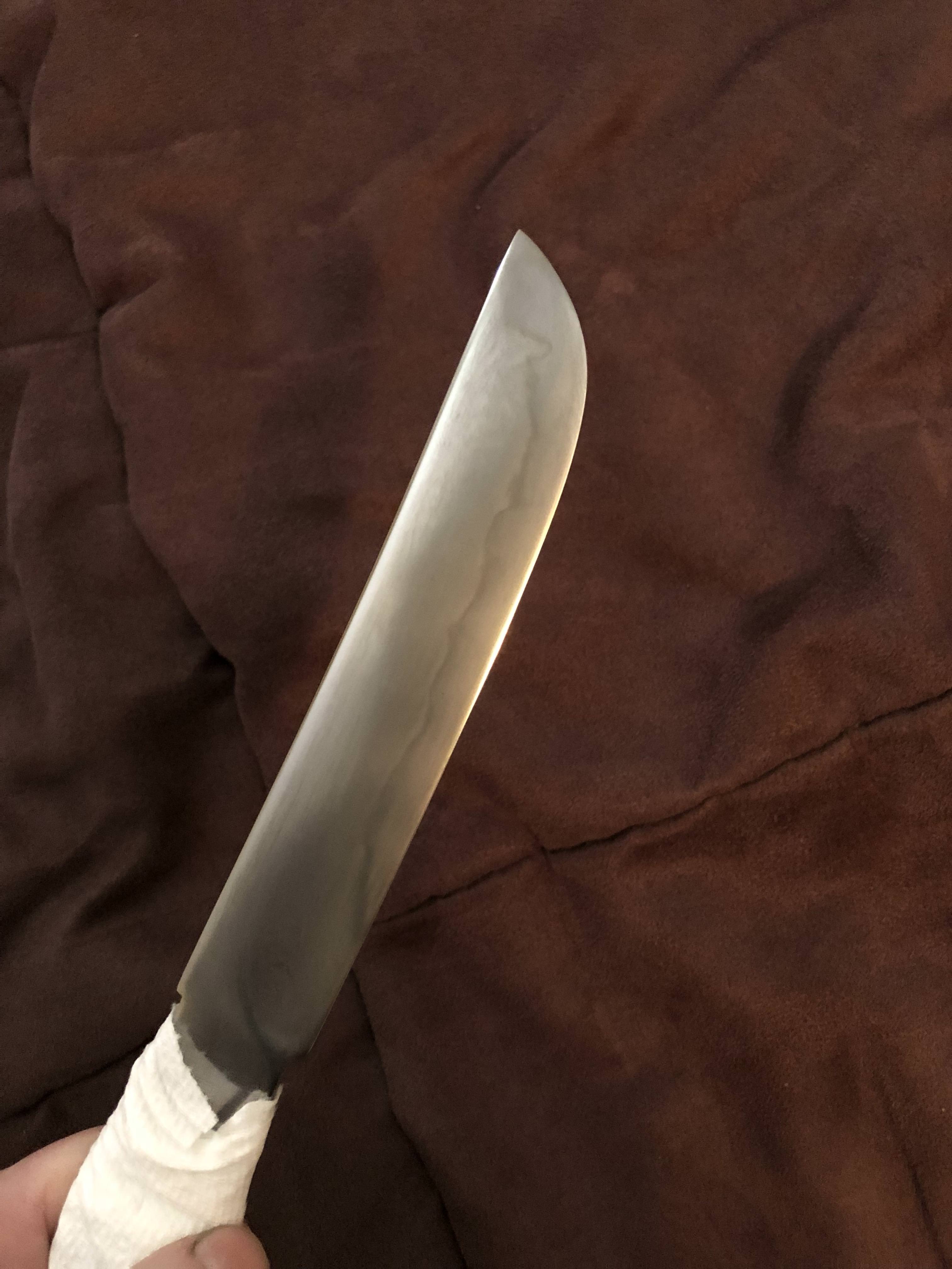

Yeah my habaki has some gold braze on it lol, but it’s not too bad. I’m going to try Stacy’s approach of changing the color. I had brass around the shop so I used that for the tsuba. I unfortunately re-ground my blade for a few reasons, mostly to put the angle down the whole tang. So I’ll have to finish it again. Here is the rough finished stuff. I have two random holes that won’t be used in the end. Also my tang is short but I don’t think it will be a big issue. The rough made tsuba is pretty hefty, it’s 1/4” brass. So I’m not sure what I’ll do there.
Edit: also the habaki I wanted to make from thicker copper but I was too impatient to wait until I got 1/8”. I used tubing like Stacy mentioned, and since it came out looking ok I’m going with it. At least this knife won’t be a permanently bonded handle, so I can always go and make nicer fittings, which is cool I think.
I agree, the tsuba looks pretty thick in the photos.
I'm puzzled, the last two photos show quite a different geometry towards the tip...
Is it just the perspective?

Sorry I know the pictures aren’t the best, but yeah it’s just the angle. I wanted a photo from the spine side and the edge side to show the habaki. I just rolled it over but it looks weird with the shadows.
I’m not sure how thick a tsuba should be honestly so I’m going to look into it a little more. Stacy said on a tanto It doesn’t have to be that big, so I’ll probably make it smaller or even take out some material and make a pattern (not sure I can pull that off too well without ruining one or two, I’ve never made a tsuba).
Basically I had 1/4” brass already so I just decided to use it since I haven’t been using brass on my last couple knives and it’s just sitting.
Overall, the tanto looks very good. You kept it sleek and make a good tip on it. Many first tanto are far too fat bladed and have a 45° tip. Your habaki looks nice. Good job! I like to file the front edge at 45° so it doesn't whack into the koi-guchi as it slides in the sheath.
The tsuba is about twice as thick as it should be. 1/8" would have been fine. If it was in buffalo horn, I could see it being 3/16" or so, but in brass, it is too thick by a lot. It is hard to tell with the tsuka not in place, but it looks a tad large in size, too. That isn't as much an issue as the thickness.
I would suggest getting a piece of 1/8" brass and re-doing it. At this point it is just a little extra work and will make a huge difference in the final outcome. We are only talking about $2 worth of brass. I would send you a piece rather than see your tanto have a too thick tsuba. Don't feel bad, because most first tanto and kata have a tsuba far too thick. Just be glad you still can change it. Even if you have already cut and fit the tsuka, you could add a couple seppa between the tsuka/tsuba to make a thinner tsuba work.
I also saw the difference in the tip in the photos. I think it is a shadow in the one shot that makes it look round. I like the profile (O-kissaki) in the clearer photo.

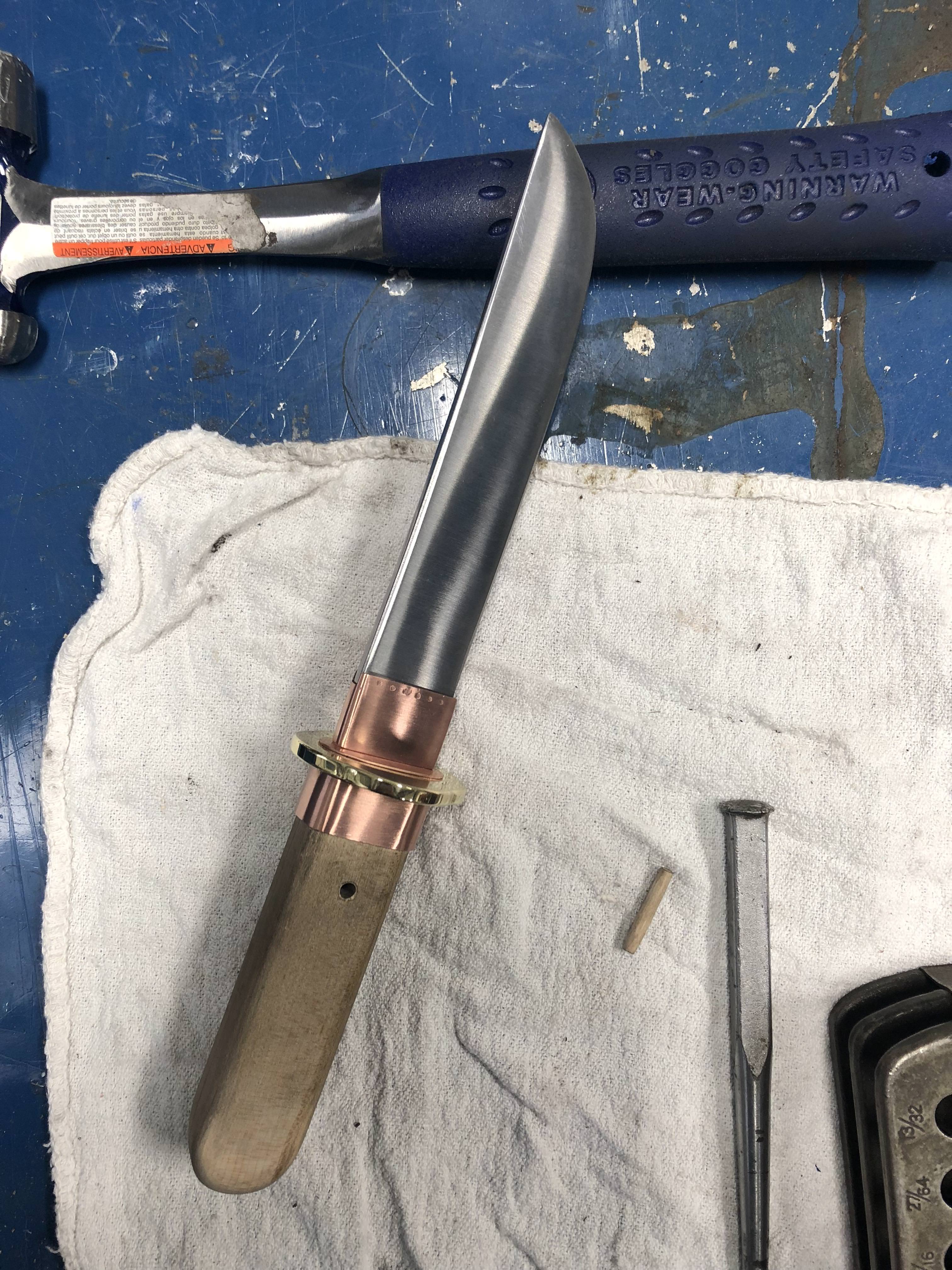

Edited: Thanks Stacy, I spent a lot of time on the grind trying to get it decent. Unfortunately I didnt see your reply until today, after finishing the tsuba (the size at least, btw it’s hard to see but the shape is a four leaf clover almost, that kind of look... the weird look here is just the reflections on it). I did see Richard’s though and took the advice, making the tsuba thinner. I ground it with a good 36, didn’t take long and it’s flat thankfully.
I had to make spacers to get the fit right, but honestly I’m very happy so far with it. Surprisingly I got the maple handle done with a very snug fit, clean. It’s from an old butcher’s block table. I made a pin from wood too so that I can jam it in easily and get a right fit (I know it’s usually bamboo or something but I don’t have any).
The handle seems a tiny bit chunky, but not by much. I don’t have big hands and it feels good in my hands. The top copper fitting (sorry, I need to look up some of the words again) on the wood looks like it may be a bit big. I like the thickness of it since I think it will be good once the handle is wrapped up, but maybe it should be shorter vertically. Not sure. As for the handle itself I don’t really want to mess with the wood anymore so unless someone tells me I should, I probably won’t.
So that is the current state of the knife. My biggest concern is the habaki now, because of the way it sits and messing up the grind on it, it dips below the silhouette of the spine now. I might have to make another now which sucks, but at least it will be better. I also dinged it so I made little decorative dings on it to hide it lol, which is stupid of course. I’ll have to fix it somehow, which I could do I think. I also dropped the knife, luckily I didn’t do too much damage. I still have to finish all of it anyway.
So are there any issues noticeable? Thanks.

OK, here are what hits me in the photos:
It looks like you just left the tang as a bar of steel. That is not how the nakago is shaped. They are beveled and the ha side rises to the mune side. Look as some photos of bare blades and you will get the idea.
https://upload.wikimedia.org/wikipedia/commons/d/dd/Katana_mei_and_tachi_mei.jpg
http://moziru.com/images/drawn-katana-nakago-18.jpg
The tsuka ( handle) is a bit squared off. It should be more curved and just a bit larger than the blade at the habaki. This takes carefully fitted tsuka halves on a properly shaped nakago. The saya should match it in size.
http://cdn1.bigcommerce.com/server4..._Reverse_Blade__63080.1344571947.1000.675.jpg
The blade is normally curved slightly ( but can be straight), and tapered. The taper of the blade makes fitting the saya to the handle size easier. Here are some links to images that are pretty good in proportions. One is Aikuchi ( no guard) and the other is tanto. Notice how small the guard is on the tanto (a tanto with a small guard is called Hamidashi):
http://www.katana-samurai-sword.com/images/Tiger Tanto, 008.jpg
http://photobucket.com/gallery/user/swordsmith-Yao/media/bWVkaWFJZDo3Mjg1MzI5OQ==/?ref=
The kissaki looks a bit more rounded than it did in the second photo earlier. I like O-kissaki tanto with a bit more point. Your is OK, I'm just saying it might look a bit sleeker if it was less rounded at the tip.
Maple will be fine for the mekugi (peg). You can order a bag of bamboo pegs on ebay.

Thanks for the reply Stacy.
As for the tang, I did initially grind it like a normal knife, you can see in that picture with the hamon that it has a curved grind line by the tang. I actually went and destroyed the finish to regrind the tang, and also the knife a little bit (I had a lot of material... those cubitron belts stay so cool it’s almost shocking). My tang isn’t that perfect shape with a sharp corner, but it is basically that shape, just a slightly rounded corner to match the blade. if I take my parts off the blade they have a V shape that becomes parallel near the spine. I asked that initially in one of my first posts because I noticed it on Japanese blades, but I didn’t do it at first. I figured it out when I went to make the habaki, and it didn’t work.
The handle I made is basically a frame handle I guess. The two sides are cut out and then put together. It does have that V shape like my tang, and fits very well. But yeah there still is room to grind more wood off. I guess I’ll have to do that then (urgh, I hate grinding wood). The fitting it’s a solid 1/16 thick. I’m going to make it take up a lot less space.
As for the shape, yeah I can definitely see that mine isn’t like the others there. In the future I’m going to look at a lot more pictures. I’m kind of an idiot there lol, I have barely looked at anything, I’m just making shit. The blade does have a slight curve toward the spine. It doesn’t have the taper you’re talking about though (has a distal taper, but not in the other plane). I initially made it with a slight curvature, but I heard it curves in the water so I didn’t make it too big. I guess my problem is I wasn’t separating Katana from Tanto in my mind, it’s like I thought a Tanto was just a mini Katana, and I just made what I thought a Katana would look like. Next time I’ll have to try to get a better geometry, but I think for this one, I’m mostly done there. I’ve spent too much time on it and it’s gettitn stupid now. I kind of just want to finish it.
Also honestly I really have no clue how to grind a tip like this. That’s probably the hardest part. However I probably could go back and make it better. If I make it more like the pictures, I would have to grind the actual edge down on the tip, then go back and remove material to bring it down to an edge again. It’s possible, I’m pretty sure. But do I want to open that can of worms? I don’t know.
