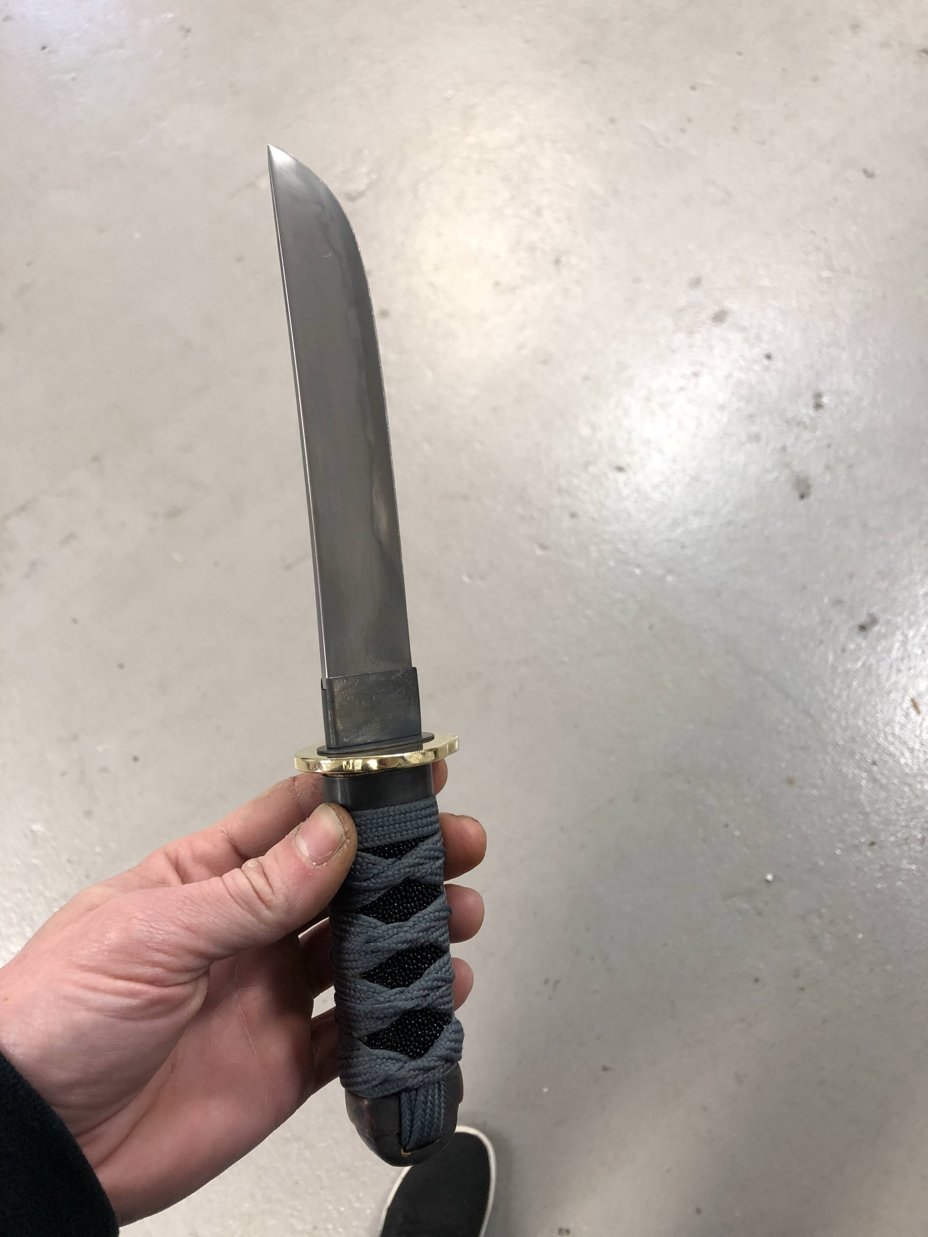

Well, don’t laugh at it too much, but below is the rushed and rough finished tanto. Unfortunately I decided not to grind the tip again, even though i know now that it would’ve made it look a lot better. I just didn’t want to open that can of worms, as I’m not good at grinding these tips yet. Definitely on the next one I’ll worry a whole lot more about the geometry.
I also will finish everything better in the future: do engraving on the fittings, finish to a higher luster before blackening, actually get a real silk wrap or at least a better cotton one and more importantly do real wrap (I looked it up but I rushed it big time, the knot is TOTALLY wrong, I know, I just wanted to get it done to see it all, I will be wrapping this better in the near future).
Basically there are a ton of things wrong with it, and I’m aware of most of them. Every fitting has issues, especially the kashiri which I designed (stupidly) on my own without much research. It’s kind of a monstrosity, but for my seventh knife I’m overall pretty happy because at least it’s a functional knife and everything is structurally well made (the blade most importantly).
Thanks a ton for all of the advice and knowledge, especially Stacy; I really learned a LOT doing this knife. I weld and do all types of metal working, but I never brazed something in my life before this. It was an adventure, that’s for sure, and as you can see I didn’t have an easy time of it lol. But all in all it’s mostly done (wrap monstrosity aside, and some finish work I can still do), and I have a lot of new knowledge to work with in the future. To expect much better when people work on this stuff for a lifetime would be a little conceited I think... I can see why it takes a lot of time, and I’m pretty happy that I at least got a knife made. And I couldn’t have done it without Stacy’s help.
I will take it apart to get some better photos one day when I have some more time, I was in a rush here. I have to make the Saya too still clearly.

Your tanto looks good. The tsuka maki is pretty darn good for a first try. You have one wrapping error in it that no one would ever spot, but makes a difference in durability and look. Notice how your top twists are all going the same way? They should reverse each time so it makes a tighter and more defined triangle.
Pay attention to which leads gets twisted which way and which one goes down first on each turn … it reverses each time. If you twist them all the same, the pattern looks somewhat spiraled, and the diamonds get lopsided. Done right and the "overs" are side by side and the "unders" are side by side on each point of the diamond. Don't feel bad about yours, I see them that way often by good makers, and have done that error myself in the beginning.
To play with wrapping tsuka maki, make an 18" piece of 1X2"scrap wood that you ground the last 8" to be like a tsuka. Practice on it to get the open spaces perfect diamond shapes. Sit on the long part of the stick and wrap the "tsuka". Lift your but cheek and turn it over. Wrap and un-wrap it over and over until you get a consistently tight pattern.

Nice. Looks like you figured out the twists to get the wrap right. As the copper fittings age, they will develop a nice patina.
Thanks, but I didn’t figure it out so much as you told me lol. That’s one thing I haven’t been able to find online oddly enough, only you said it as far as my research goes. I used cheap leather though which I’m sure you can notice.
I feel like it could look cool with a fuller, but im not sure because the balance is good right now and I think the weight makes it a better cutter/chopper. It’s only 5/32 stock so it’s not too heavy (it tapers to the tang and has a distal taper from the... maki, I believe). As for the micro bevel, oh well, that’s a tough one imo.
I found while hand filing the copper that it gives a coffee color that almost looks like glass, but after buffing it hasn’t come back. I guess I have to handle the pieces more to get it again? I love that color though. Also this time I made a die for the butt cap so it’s a legit looking one. Anyway thanks again for all your help, maybe one day I’ll make a third one, two years from now lol.
