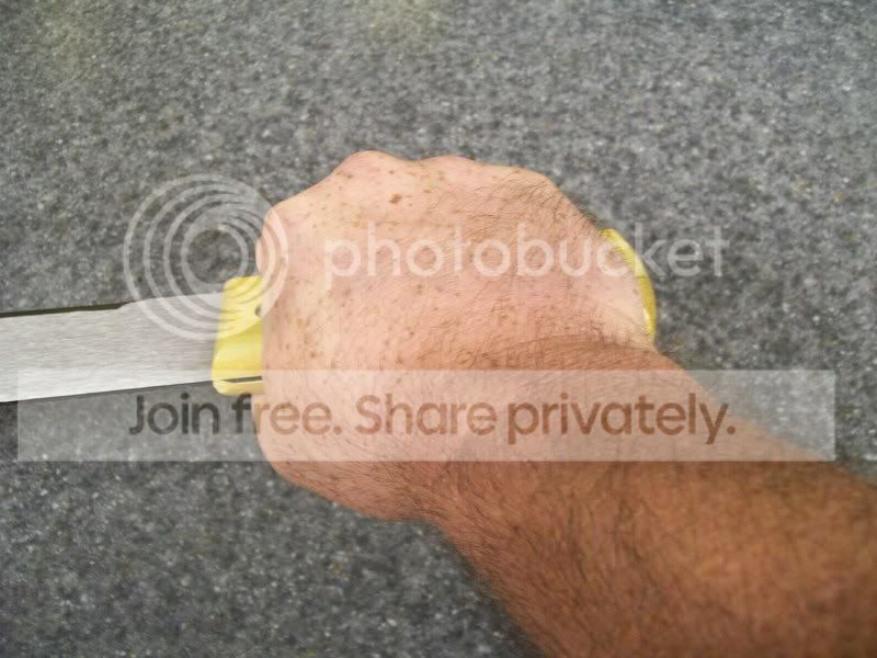

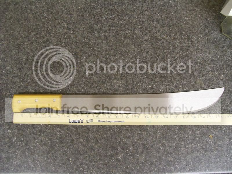

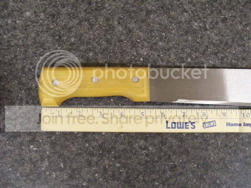

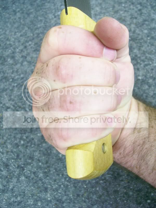

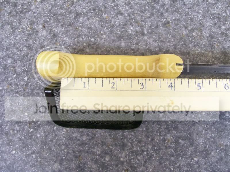

Okay, I received my 18" wood handled Tramontina Machete today and I have a bit of an issue. The handle on this thing seems awfully small lengthwise. I would say thickness is okay for most folks but the handle shape and cutout size really binds your fingers. This is my first machete, but I expected much more handle room on a big bladed implement that is made to be swung around in the jungle all day. What I am trying to decide on is whether to take the Dremel and sandpaper to the factory handle or make a rough outline of the handle, expand it, and cut new scales out of some Oak or Hickory. I have never made knife handles before but this is a cheap machete so I'm not risking messing up much anything really. Have any of y'all had similar issues? Do any of the machetes have bigger handles? What would you do in this situation? Thanks.

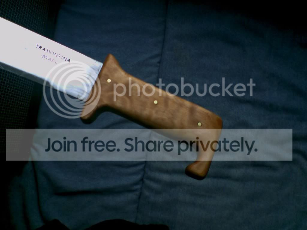

This is one I did in varnished cherry with a small brass guard and a hard sheath of cherry, teak, and yellow cedar:
This one's the current project. It's curly maple and the sheath for it is plywood and epoxy laminate (super light but still rigid).
I started reworking these for the same reason: I can't stand tools that don't fit my hand. Your hands look similar in size to mine, and that grip would irritate my little finger pretty quickly, especially with a bit of sweat worked in. These handles aren't glued on, so you can just drill out the rivets and the wood will slide right off. If it's ever going to be on your belt, I'd strongly suggest a hard sheath. One stumble and a properly sharpened machete won't even notice that cheesy canvas pouch...
Before I put new scales on it, I'd at least try the dremel and sandpaper. Not much work involved, and it may do it for you. I have the same machete, and a little bit of sanding did the trick!
I am definitely going to do the dremel and sandpaper thing for a temporary fix, but I think this would be a good oppurtunity to try and make some custom scales as well. Nice work DeadeyeLefty, I would like to hear a little step by step on that sheath you made.

Wow, those handcrafted wood handles are sweet.
