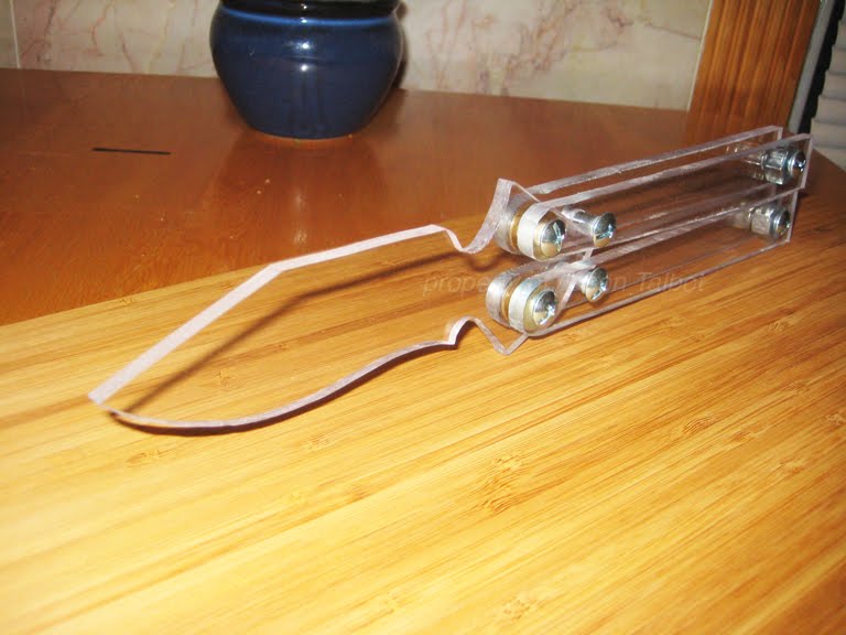

These three lockback folders have clear scales, made of scrap bulletproof glass in this instance, and I wondered if you thought that transparency was useful or not so much (metal parts are from recycled Buck 110 Hunters from 1988 & 1989). Thank you for looking and for your opinion.

The technical title for bullet-proof glass is "polycarbonate". It's pretty indestructible and very scratch resistant. I've been playing around with it recently. I made this:

I have used bullet proof lexan extensively. I am assuming that is what you have there. Strong plastic stuff?
If it is actually glass then ignore me.
If it is bullet proof lexan, I have about 5 years experience using it. We used it at a factory I worked at where we made diamond cutter bits (for the oil and natural gas drilling industry).
If it is lexan, it will scratch pretty readily. It will take on a scuffed scratched dirty grey appearance. Not as quickly as where I worked (place was covered in silicone carbide grit, diamond grit and all kinds of scratchy stuff).
We used lexan in sheets to drill out and hold the parts to sand blast the cans off the parts (clean off the cans to expose the diamond layer).
Strength wise, it is resistant to high speed impact to an extend. You can dent it, cut it etc. It has some flex in longer pieces.
