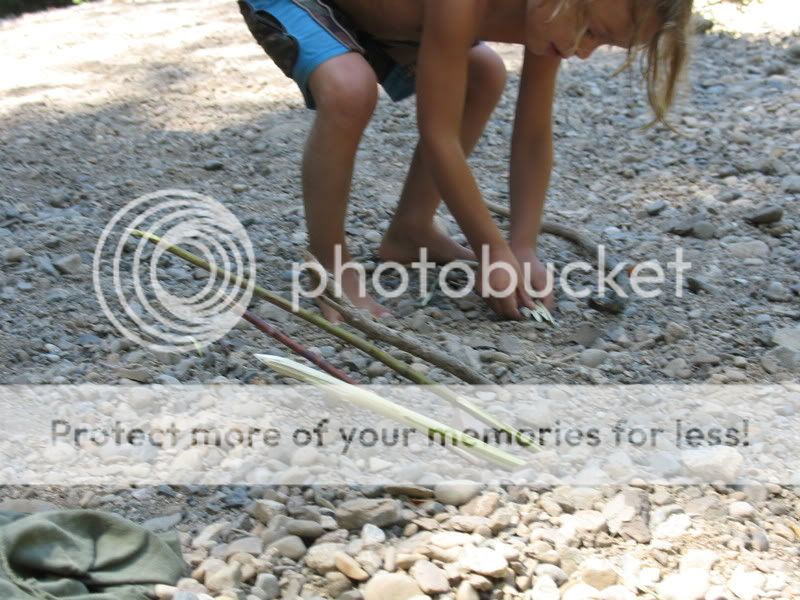

and my 5 y.o. primitive boy CYPRESS, making some traps with dad...:D
this boy loves sticks..
